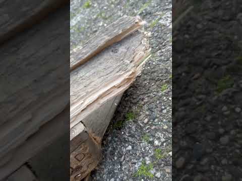

Hydraulic ‘chunker’ I hadn’t seen before. Interesting blade design.
https://www.youtube.com/watch?v=0bK99Ne2JyI&list=FLNjlzx0mwrswMIqVHHAqrug&index=112

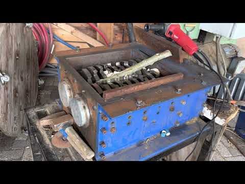

Does anyone have any experience with these shredders?
I was visiting a friend far away ( not so far as Jakob is used to travel) and he got this shredder. I think it is a perfect fuel for a drizzler or one pipe design. Anyone with real brains got anything to report?
He wants to make pellets but I think it is ready for gasification.

The one my friend has comes from BMW scrapping steel.
I am thinking of pallets we have to get rid of and willow from the land. Plus plus. Cant get it out of my head now for a few months.

Stupid A@$, couldnt resist, the flesh is weak. I was working nearby, two hours from home and decided not to drive again so I took it home with me ![]()
As soon as the boys saw the new toy they had to try it out
. No work this evening.
8 mm strainer in it. Way to small. Almost sawdust
