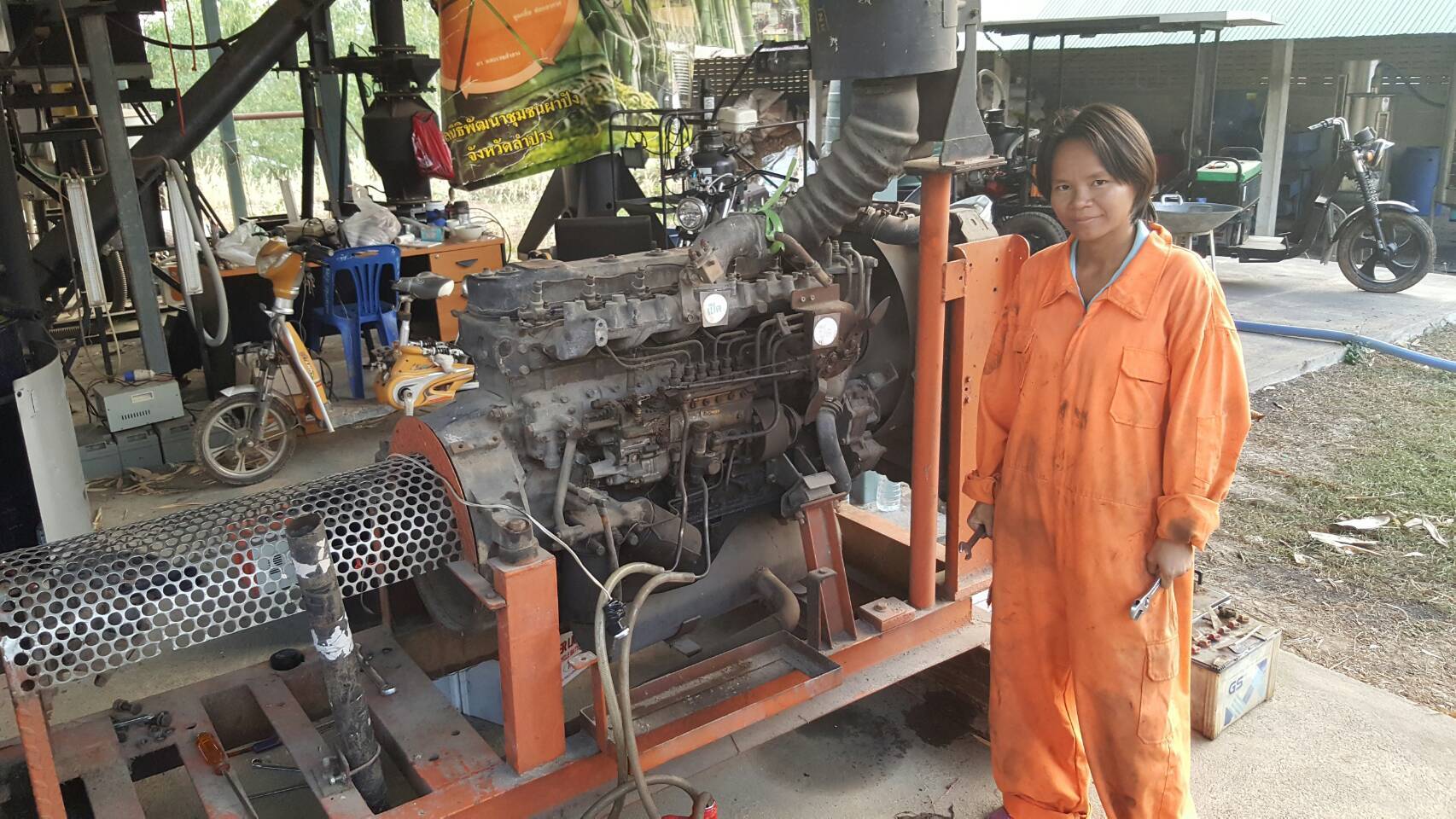

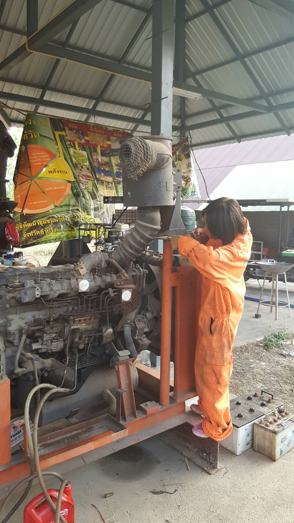

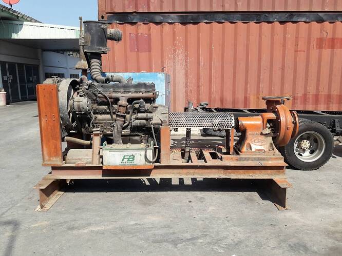

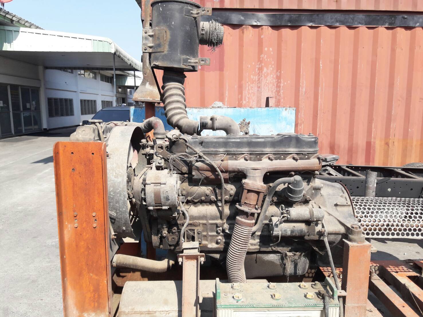

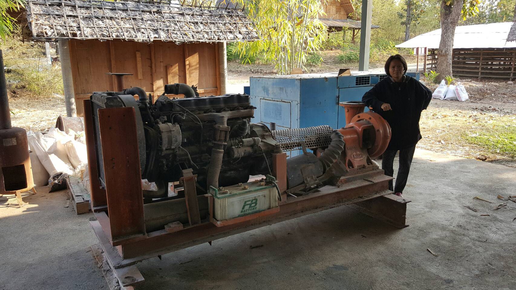

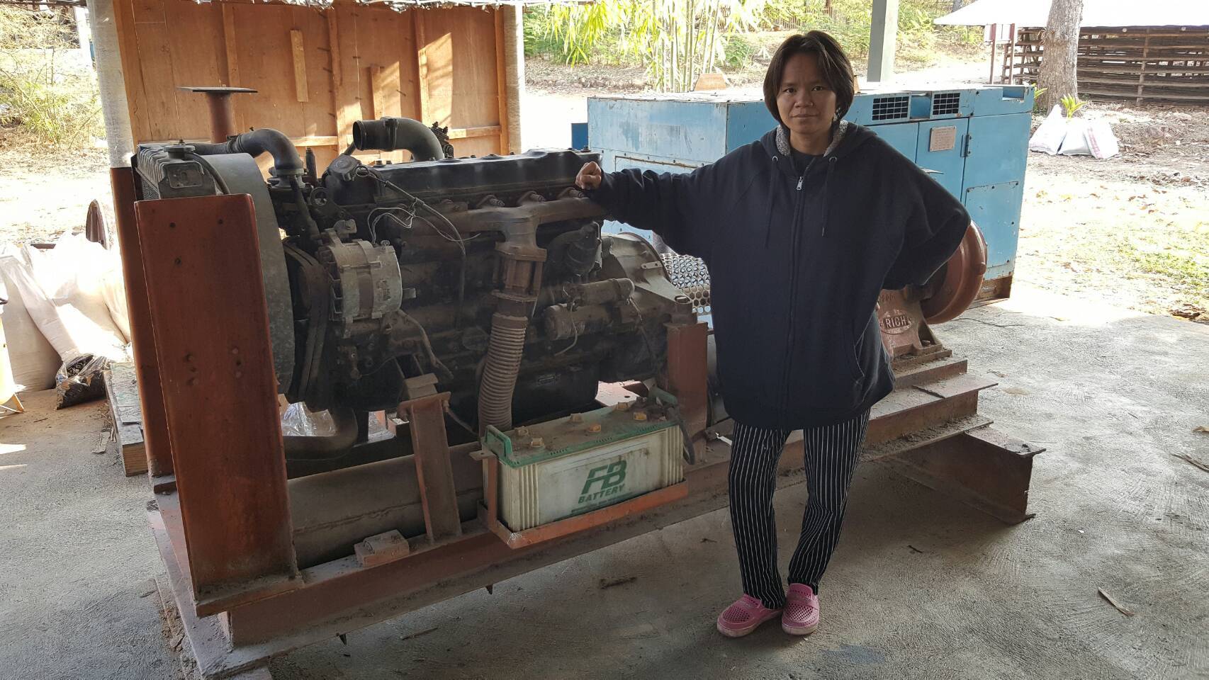

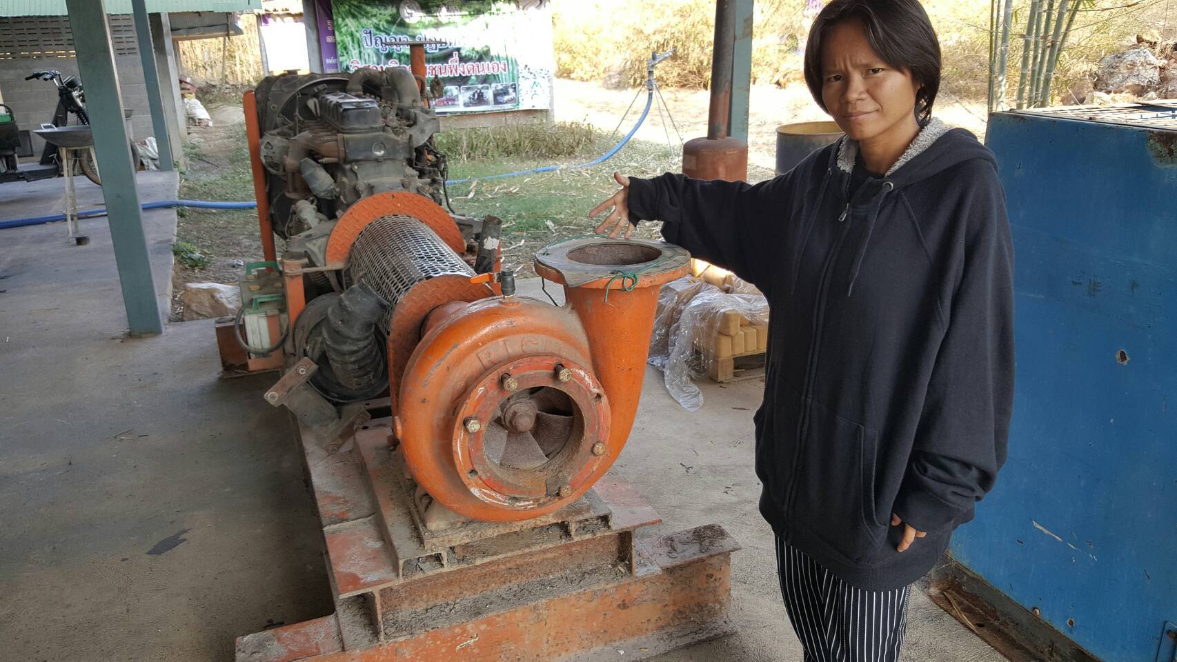

arrived today, some perspective reference in size, standing next my wife…

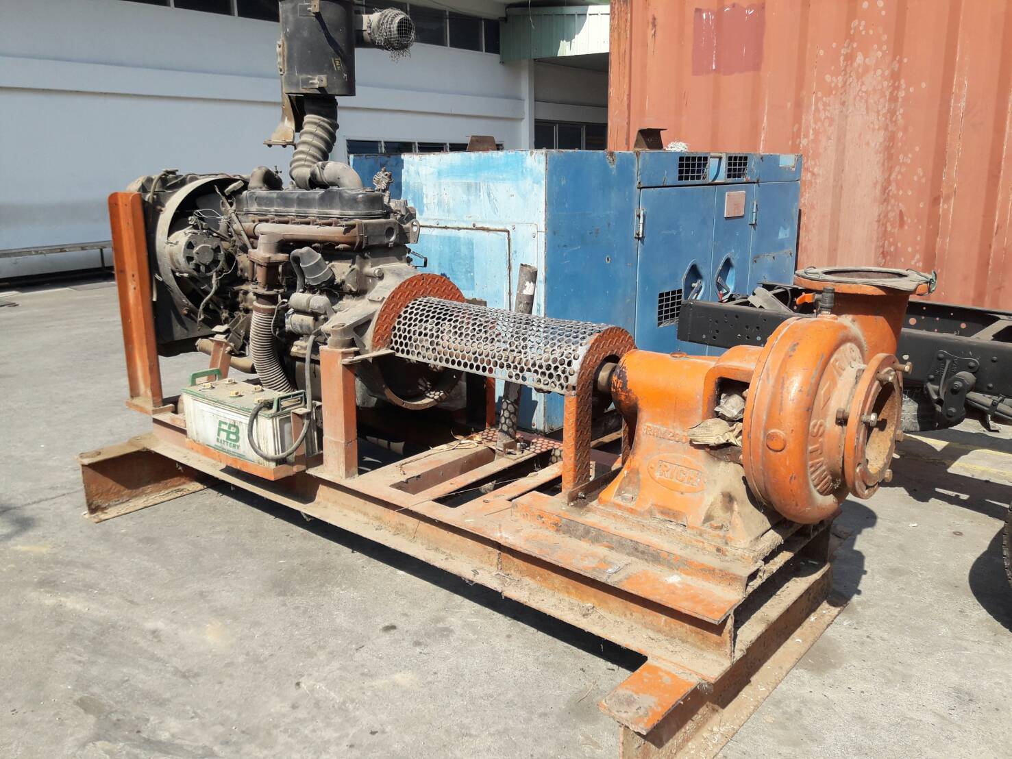

oh yeah, the blue one is a second surprise gift… a air compressor, diesel, rebuild to run on sewer gas, where they did not succeed… ( has a distributor build on and sparkplugs, but i don’t know the engine’s condition… )
Do you think that blower is big enough to start your gasifier? :smile:
Man I can’t wait to see that gasificer it will replace the village power plant over there. :grinning:

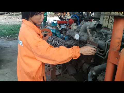

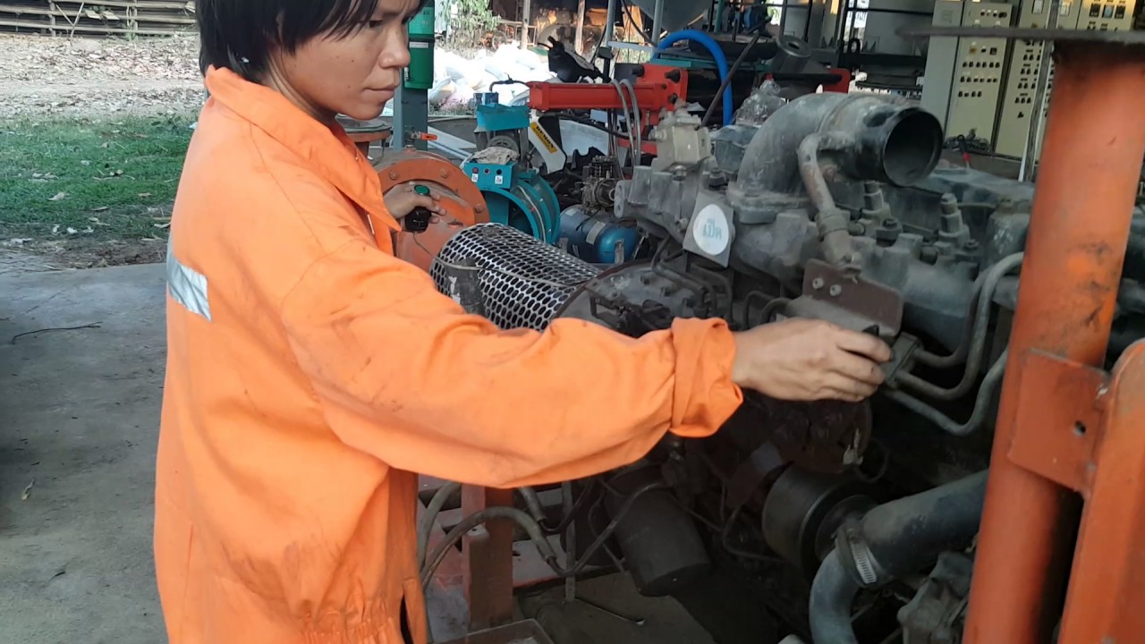

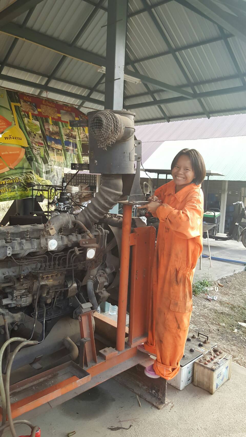

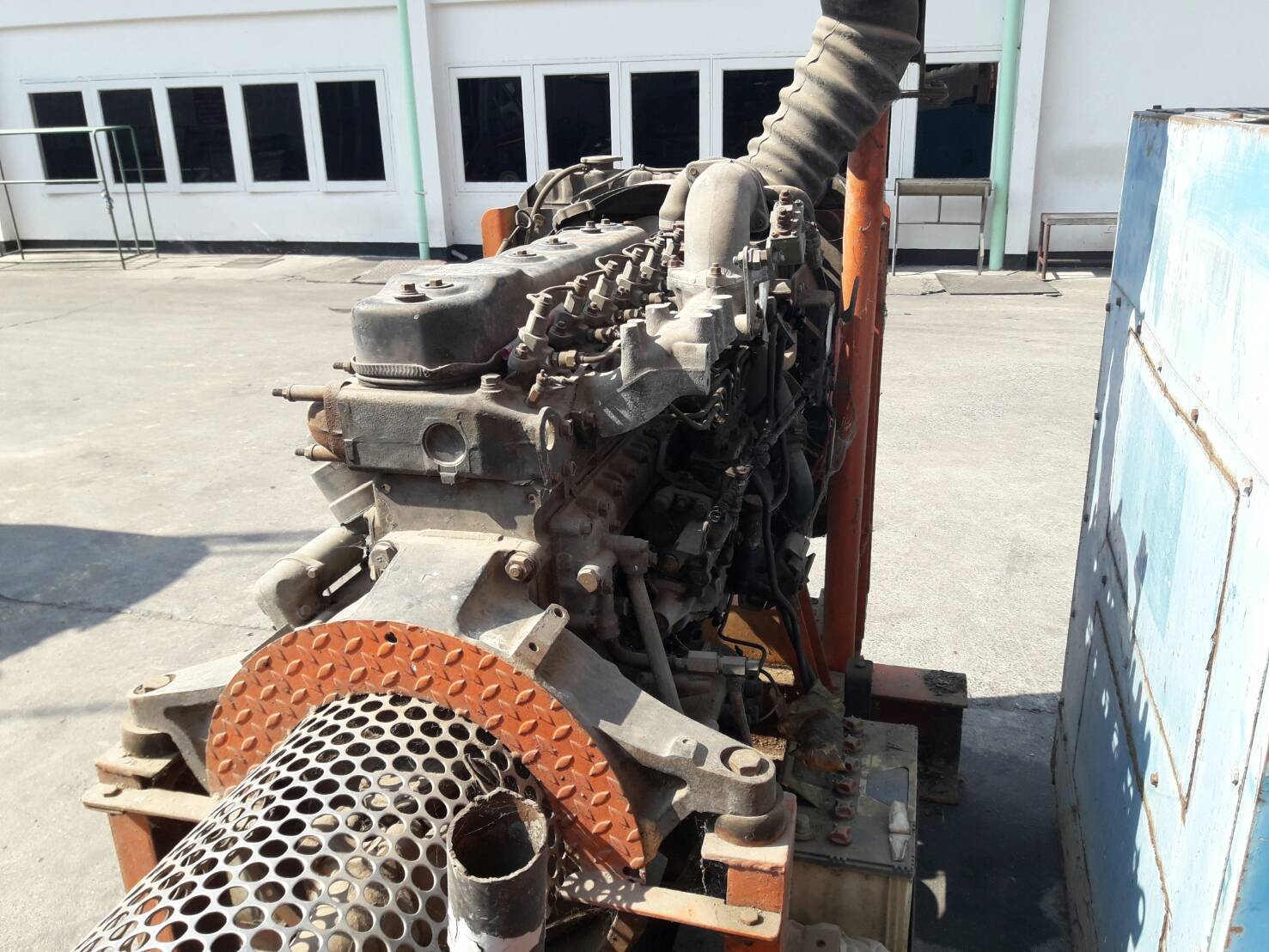

today started the engine on diesel… Bad ass power…
now pictures, uploading some clip later
all for testing the engine before taking it appart…
and no… this one is to small…

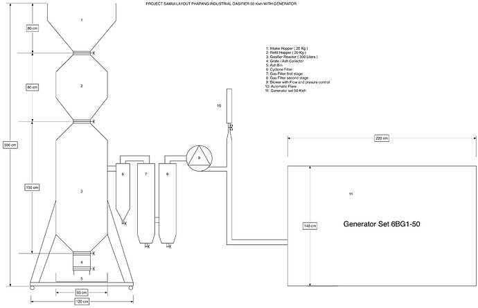

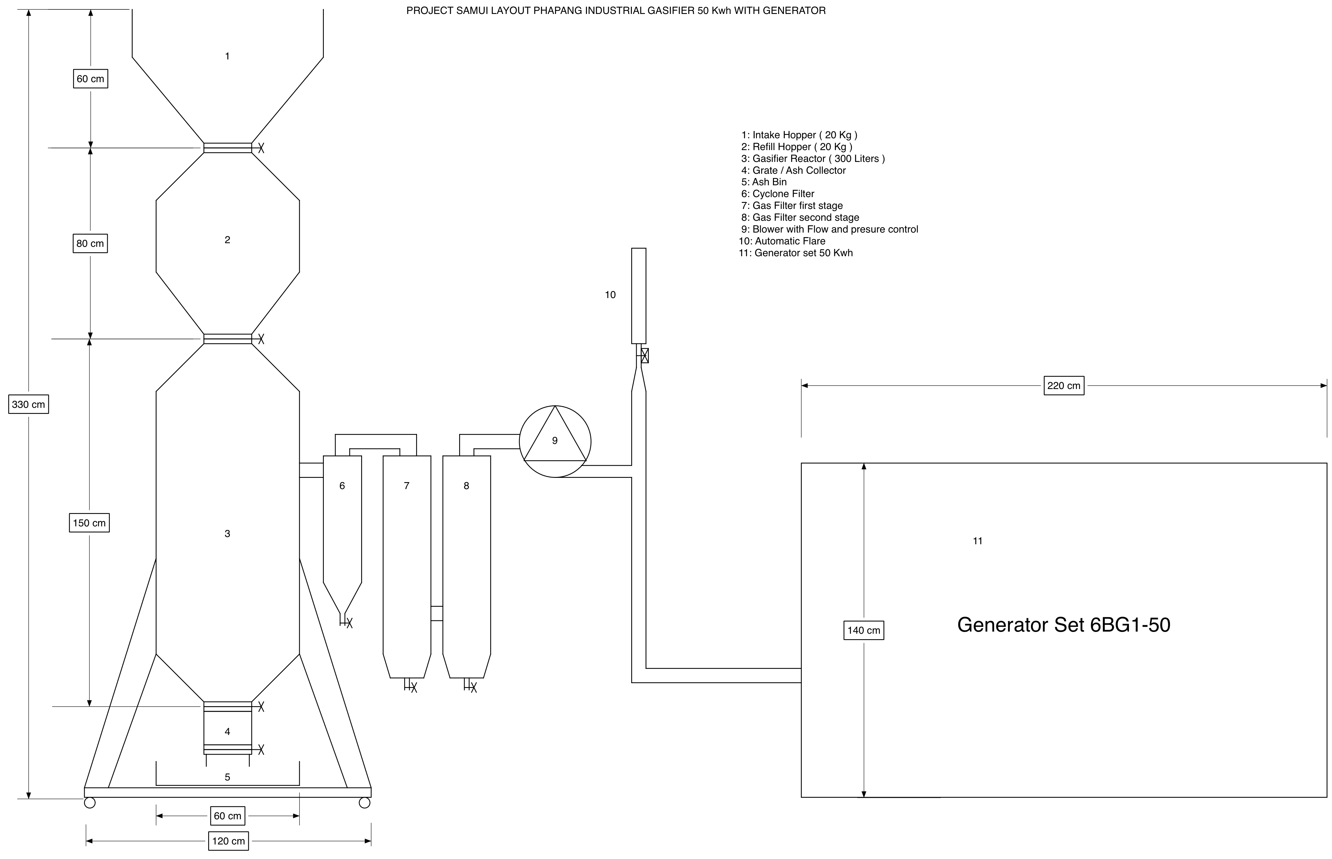

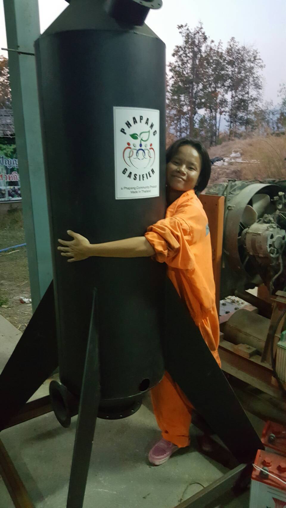

first design status…

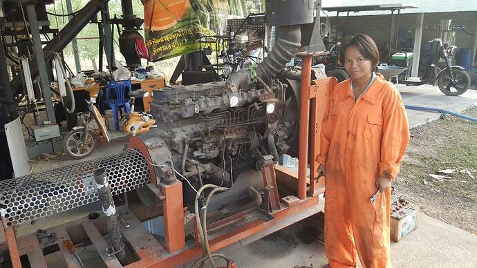

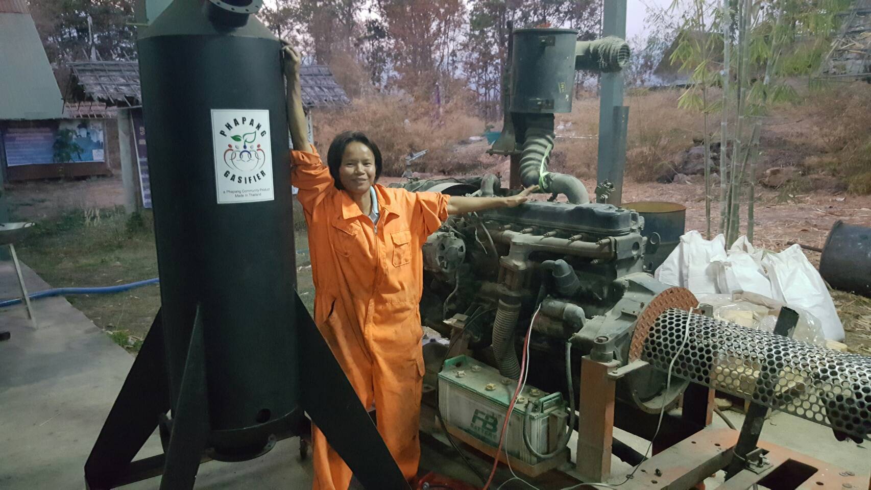

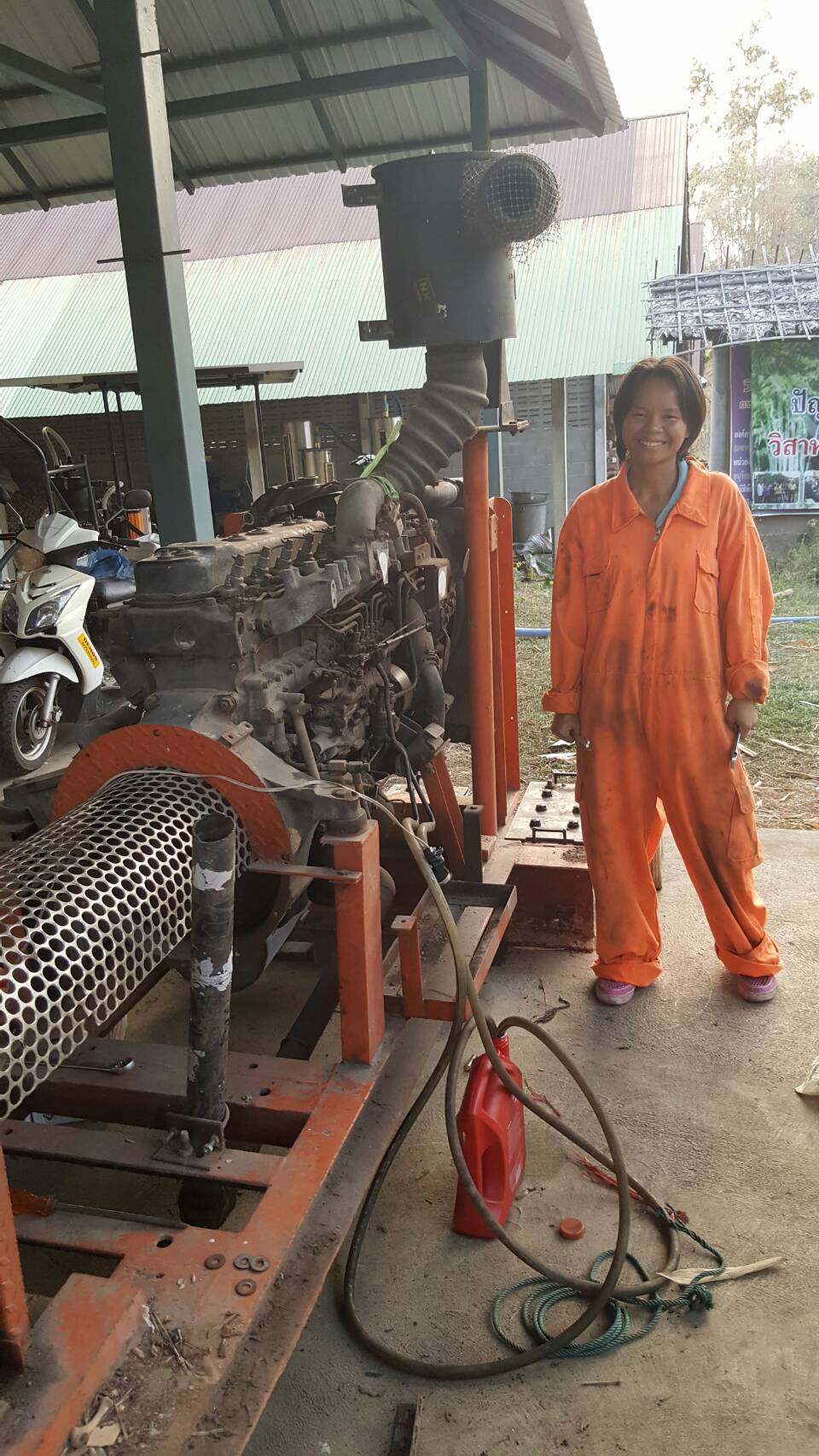

Wow your wife is great all dressed up and digging in to the work taking apart a machine bigger then she is. Looks like she has a new love in her life with that gasificer. :smile:
Wait untill you see the movie… she loves to rev that engine…
Uploading now… takes time…
one of the movies…

Wow, runs like clockwork. You’re a lucky fellow.

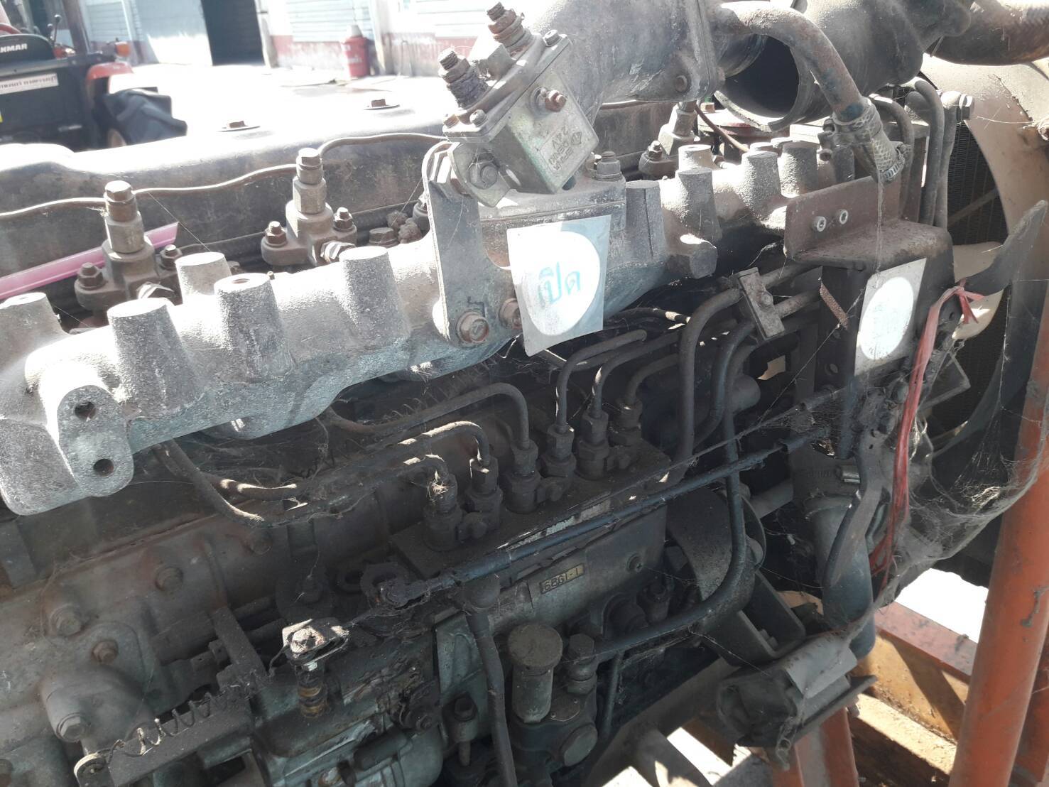

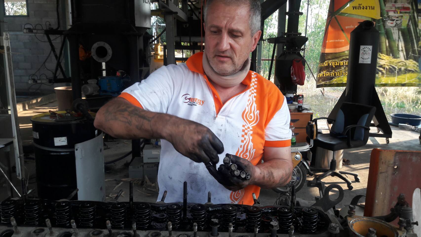

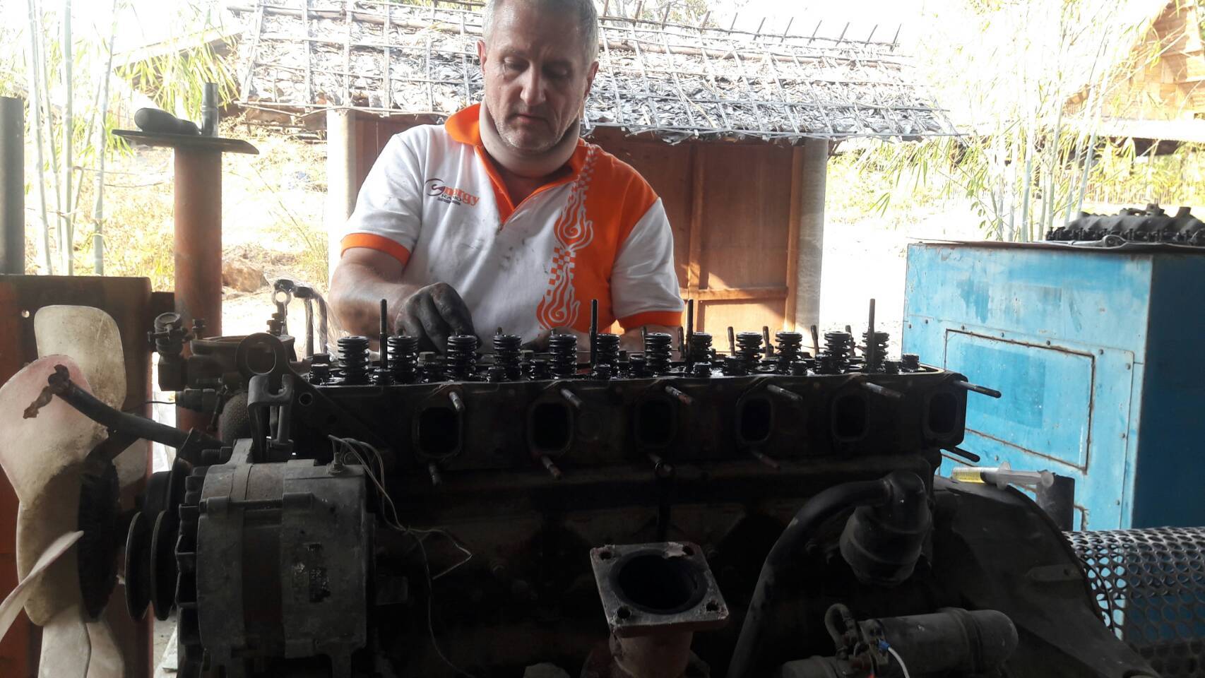

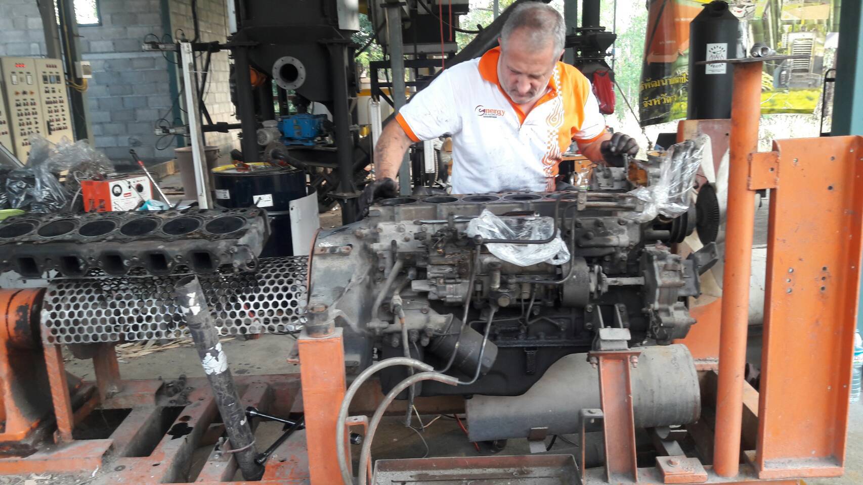

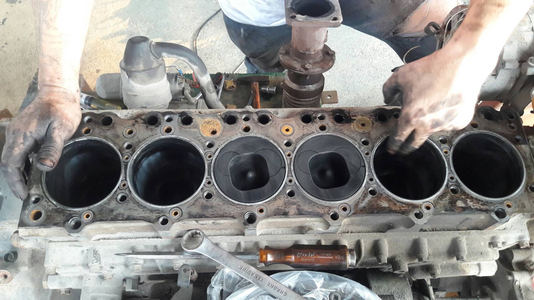

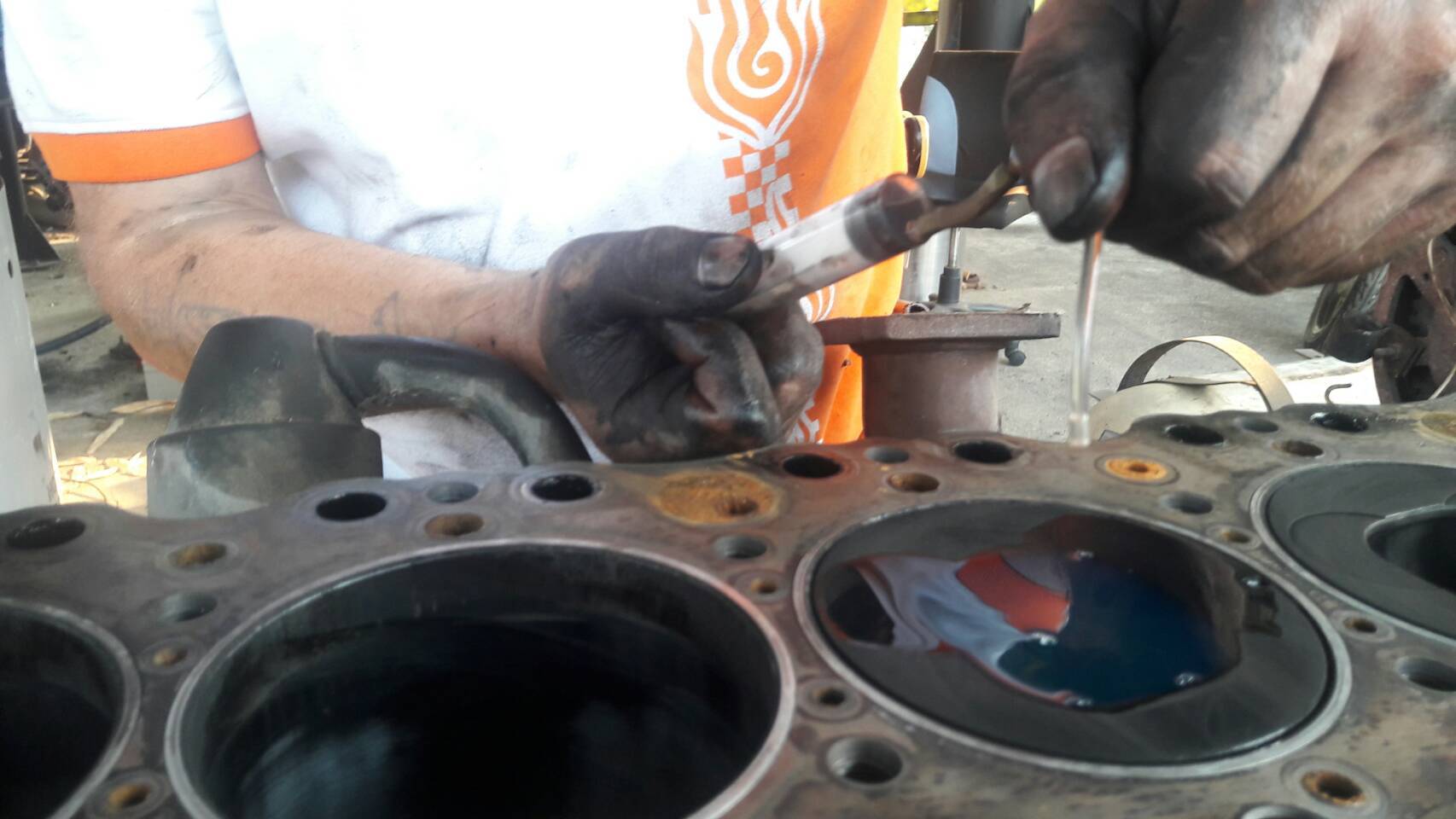

Making hands dirty…

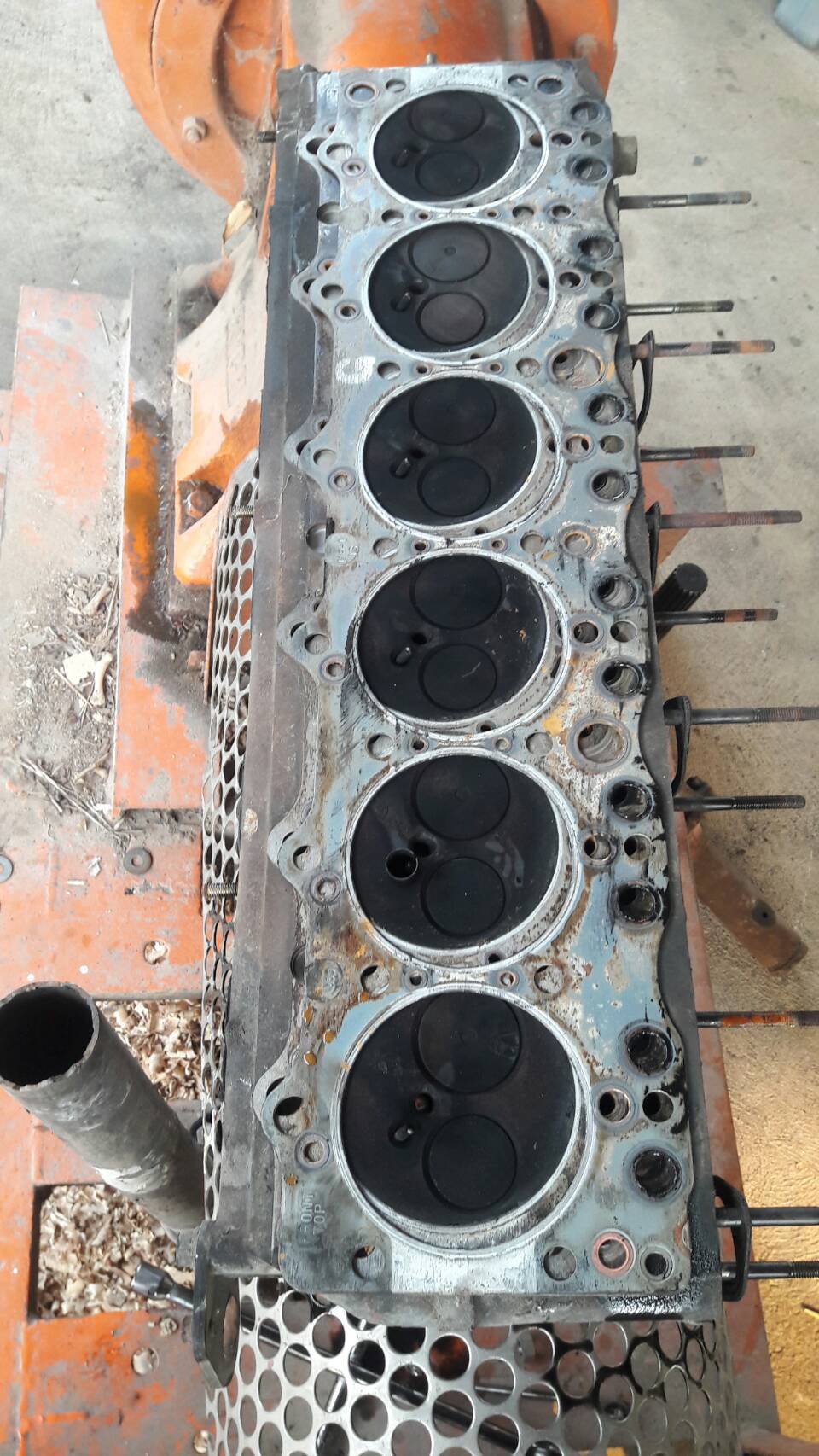

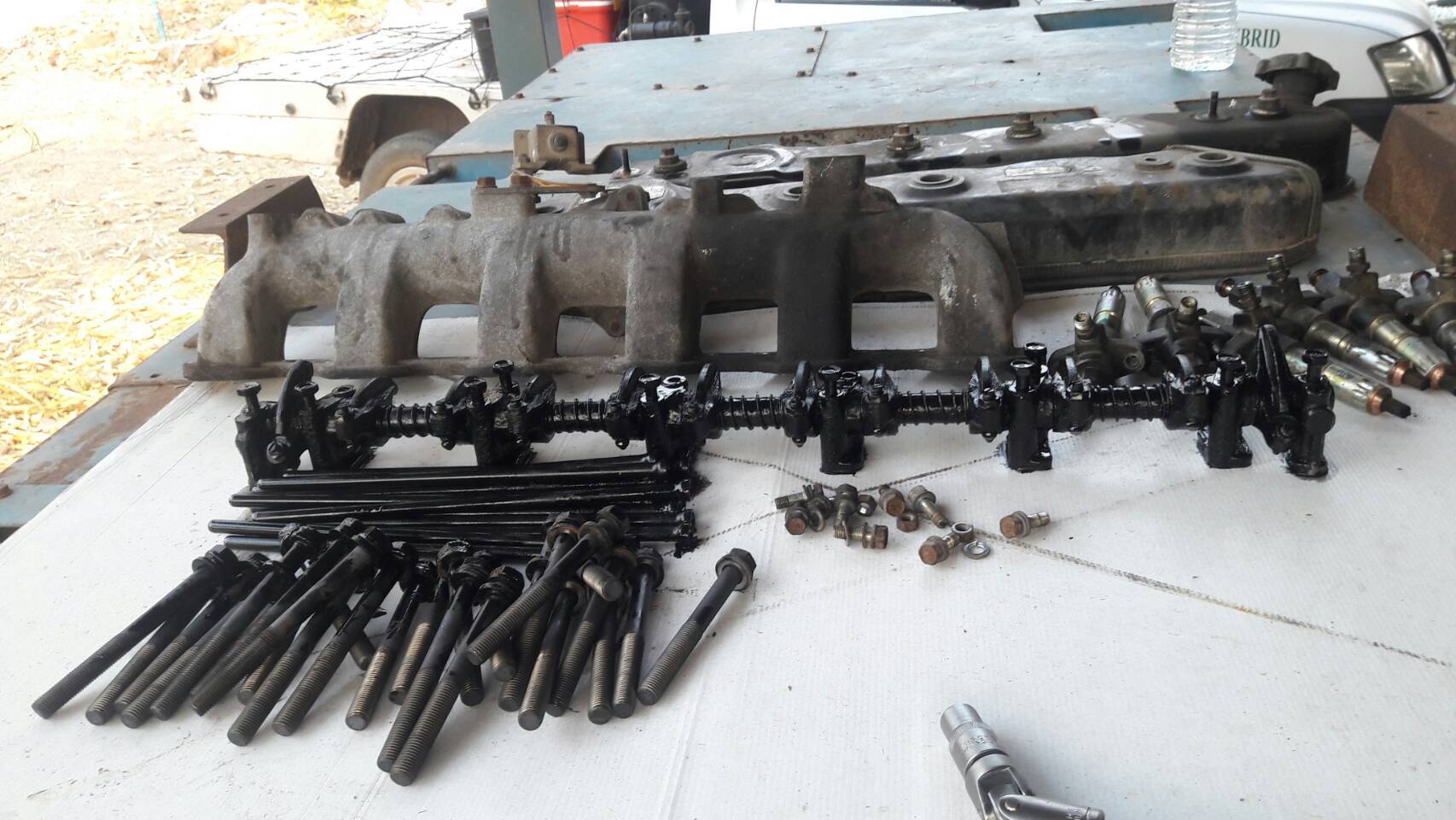

Taking the cylinderhead of to install the spark plugs. Going to be a not so difficult job.

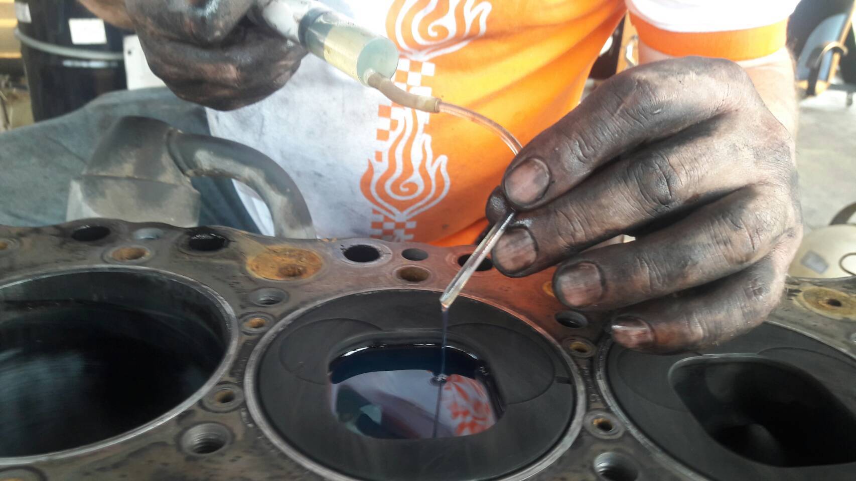

Also inspection of the inside :grin:
You may have found a new business… I bet if you get it worked out someone could make money selling converted genorator sets.
