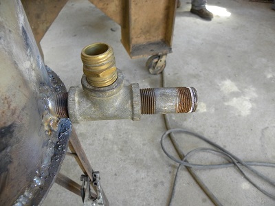

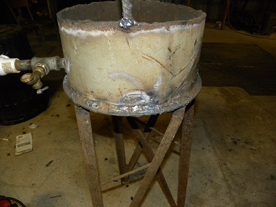

Hello, this is Jesse. North. I am also known as Jakob’s little brother. Before the trip to Argos I was building a charcoal forge. Below are some pictures of my forge. I talked to some of you at Argos already. If anyone has some advice for me, I would be happy to hear it. Also, you can post pictures and information about your own forges, black smith projects, or casting projects.

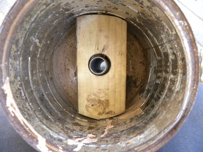

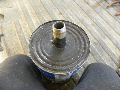

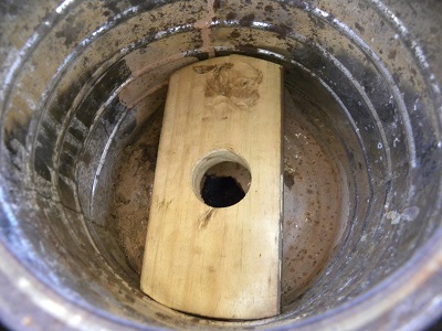

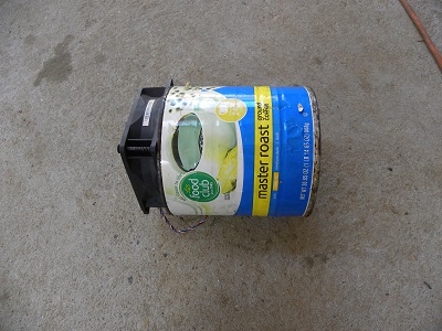

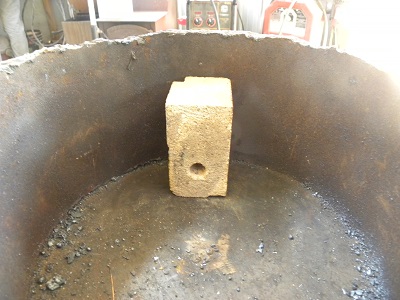

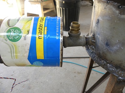

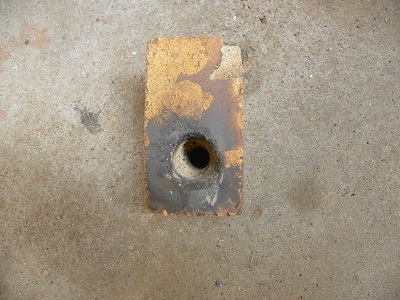

My forge is made from Jakob’s left over pipe from his truck build, some pipe fittings, an old computer cooling fan, a coffee can, and an 1/8" steel plate. The legs are made from part of an old mobile home frame. I also a fire brick that I drilled a hole in for a nozzle.

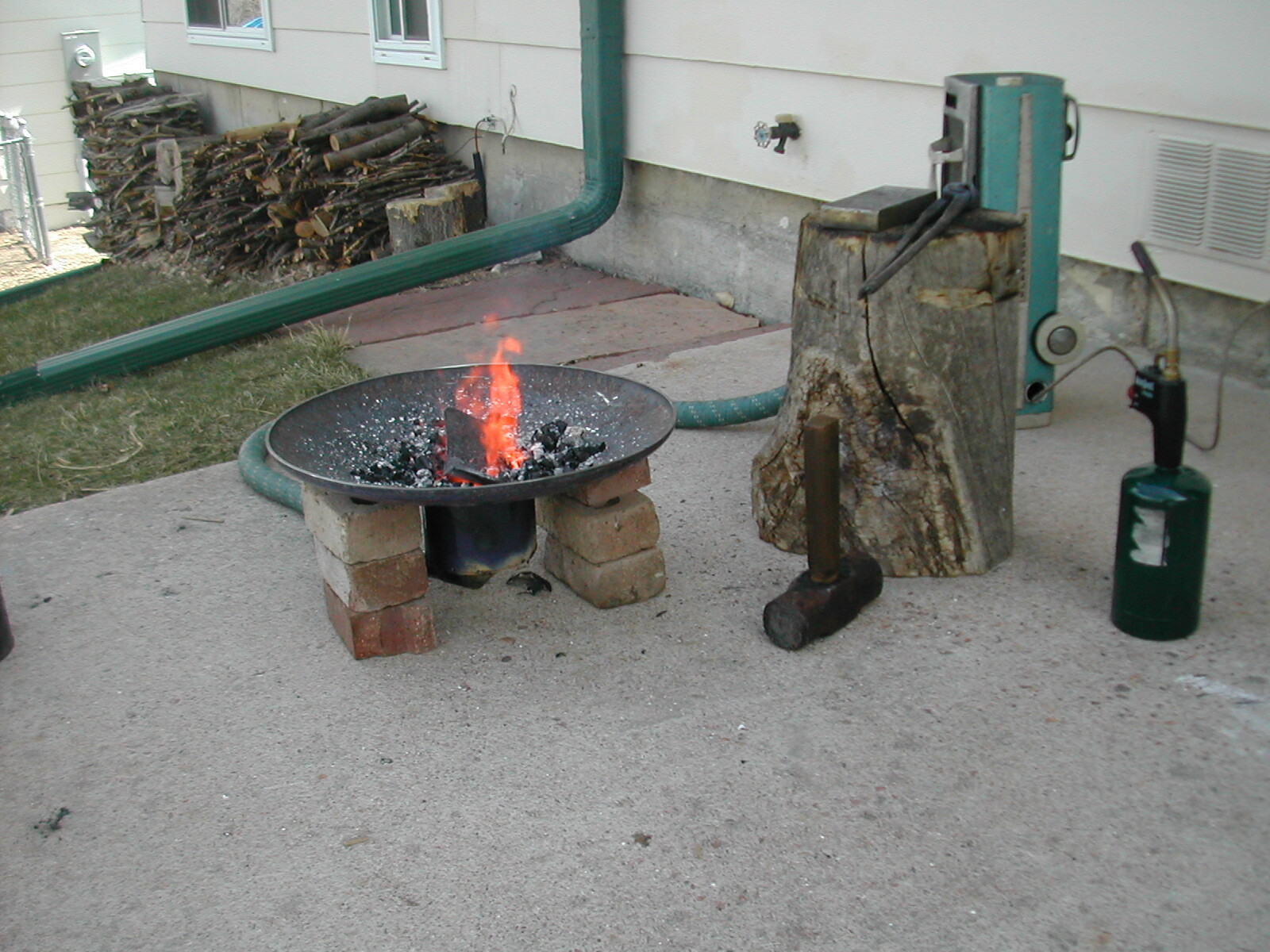

I made a forge from a truck brake drum and tinker.

Charcoal works but its crumbly and hard to keep the fire where you want it, mixing some of the coal fines I got my my late chum makes the stuff clump and stay together more easily

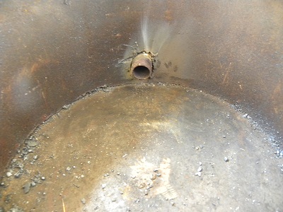

I did the an off-take of the mini-metal foundry, and used plaster for a coating on the inside, there are various other materials you can use, i wouldnt use plaster again it flakes off easily. The computer fan is probably what I will use next, the hairdryer I used pushed too much air. For a forge, you might need something to control the airflow, which I think the valve you have should work fine.
For the foundry, i put the air inlet in the side, I used a 1 1/4 short nipple welded on to hold the 1" pipe nipple. basically so I could easily remove it in case the molten metal leaked, and filled it up, or the nozzle burned up, or I wanted to convert it to propane. Every tin can I have tried to use as a crucible has come apart and I end up hammering the nipple out. lol
