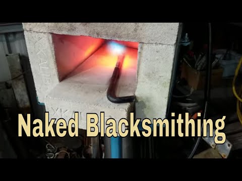

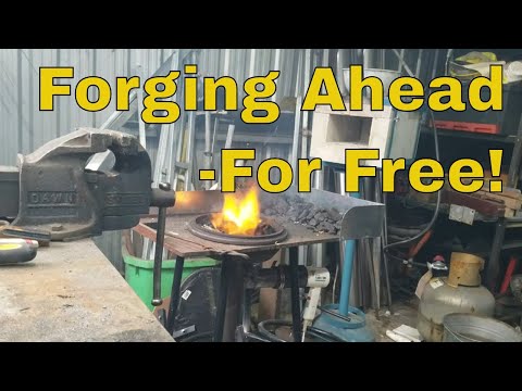

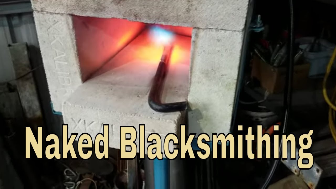

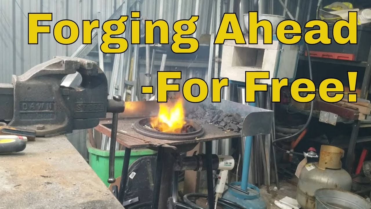

I have 3 forges- a coal forge for mid winter when l work all day, a self made LPG tunnel forge for doing quick jobs in. Its fast but hungry on gas but really versatile and recently I was sent a pot forge/furnace by Polish you tuber/blacksmith/forge maker. Its a nice, fast and convenient for melting down all the brass taps that I get off my gas bottles. (around 200 each year) 40kg of brass makes good christmas beer money.

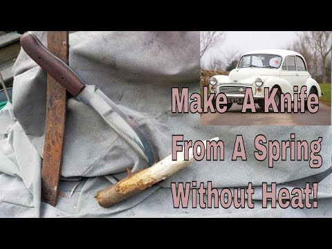

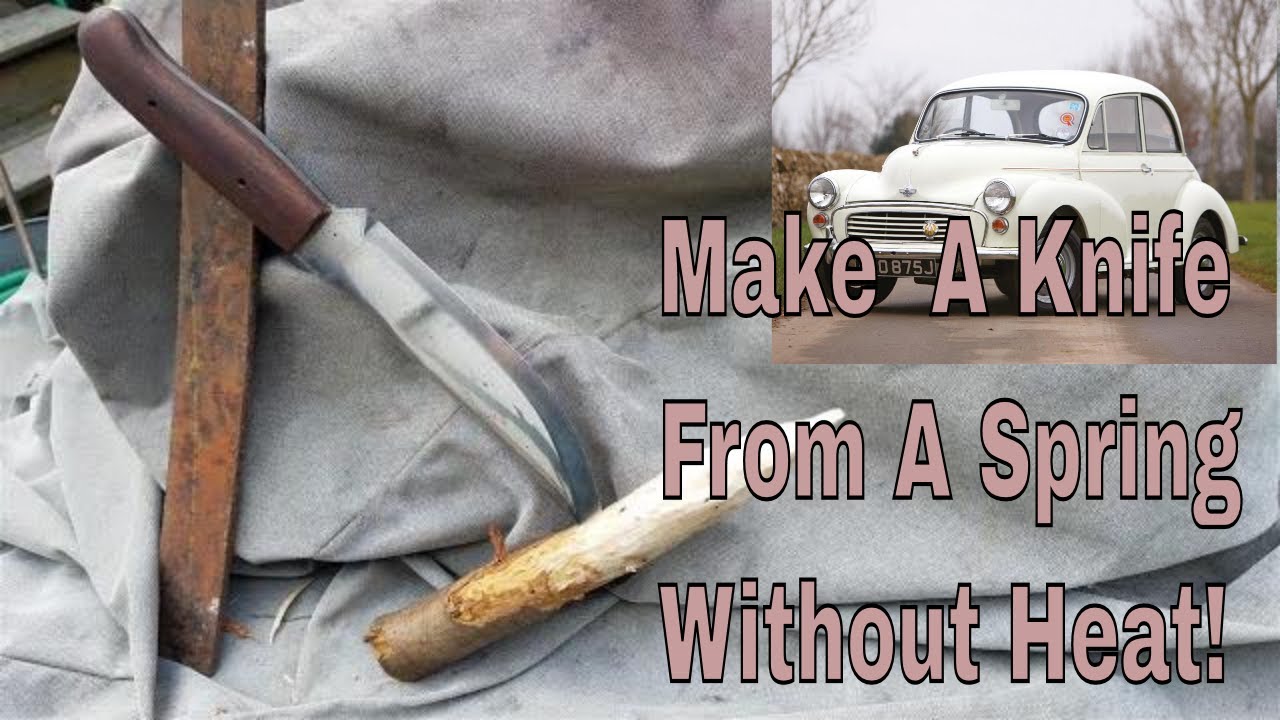

I made a blade- cos people made me!
"Ive made a forge’’
“Oh cool will you be knife making?”
again and again…
So I made a knife- without my forge. I use it quite often cos its so strong
