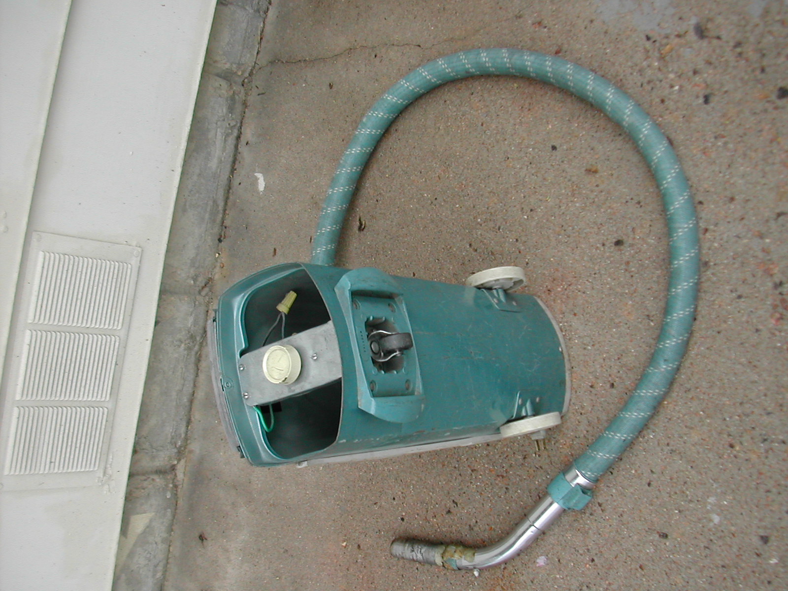

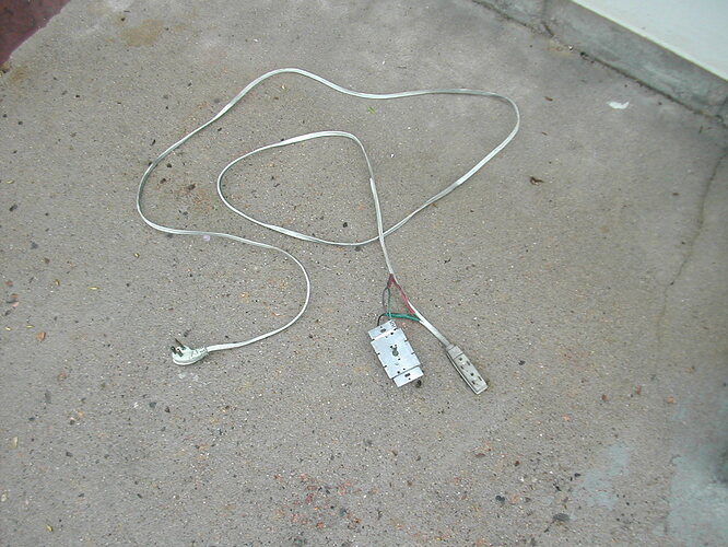

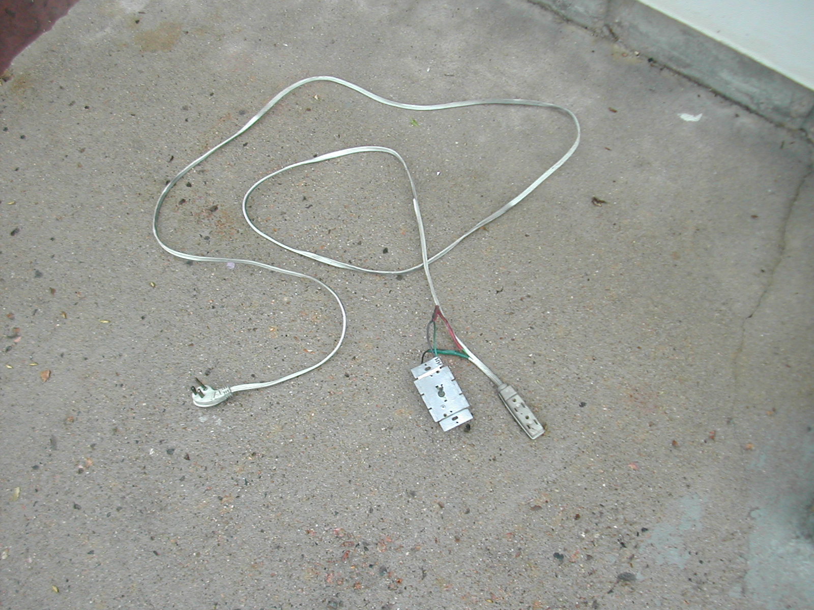

So here’s my furnace and now forge blower. I got an old vacuum cleaner at ARC Thrift Store, and added a dimmer switch that was left over from remodeling. I also added a dimmer to a short extension cord to turn down the heat on my soldering iron. The blower allows me to melt 20 lbs of aluminum in 20 minutes using propane as fuel. Both these things work really well.
Warning. Use rheostats only on brush type motors. You will kill an AC motor it you put it on a rheostat. If you don’t know what I’m talking about it’s safest to just use on/off switches.

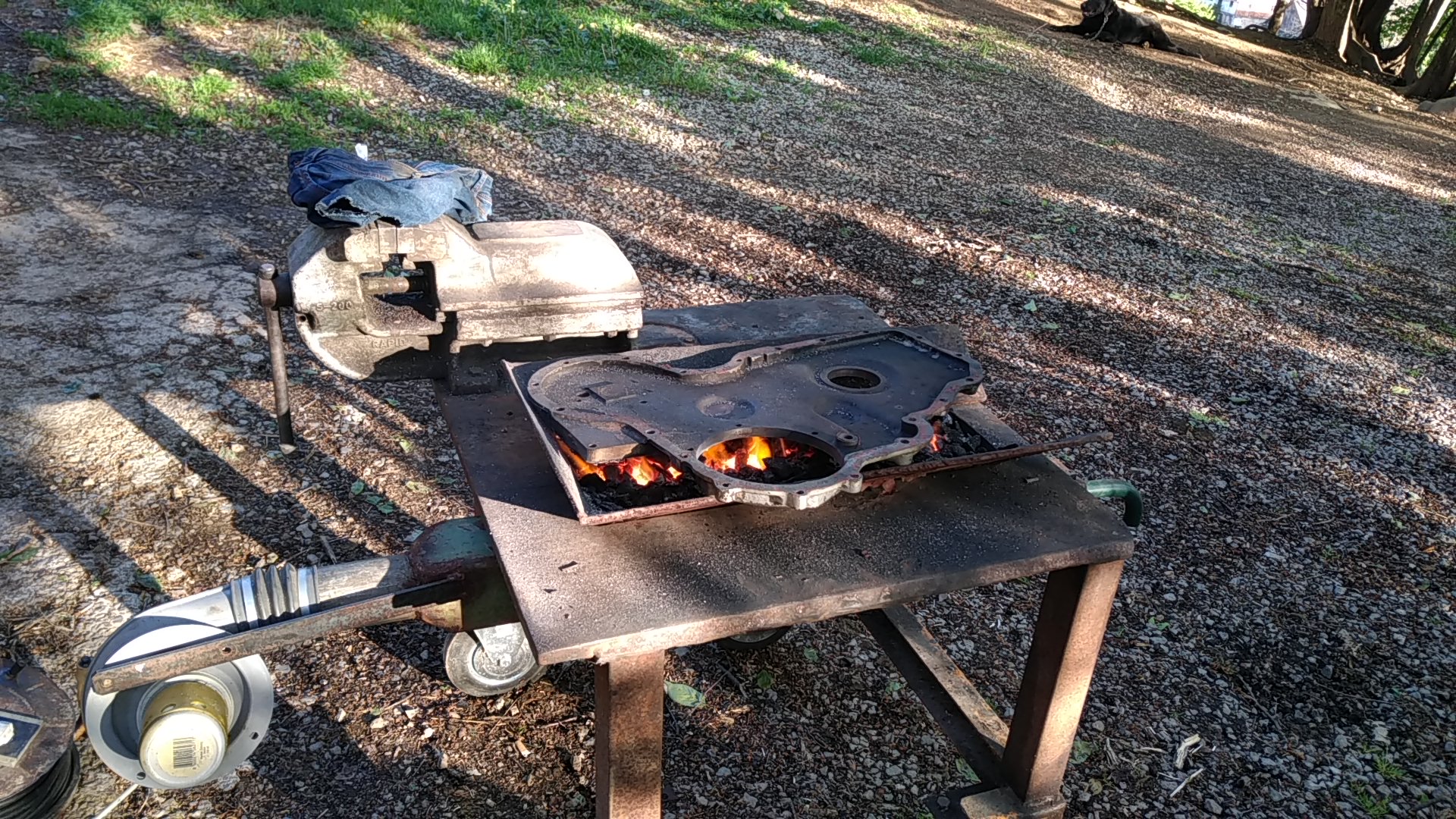

heating the cast iron piece from the perkins engine, and then welding the plantation and further drying the paint

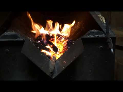

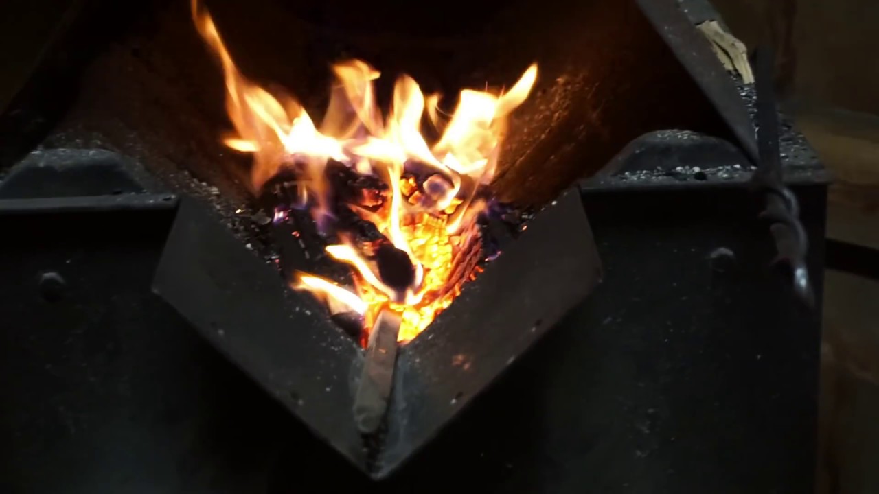

I got curious about ChuckW’s referring to his homesteads made forging with wood systems. I’ve never blacksmithed. And ass-u-me’d you always needed pre-made wood charcoal.
This was the best I’ve viewed so far:
Presenter “Cori” has much to say about wood, wood species, wood sizing, dryness and even ambient air temperature and humidity effecting getting her best hot coal bed.
This ALL is applicable to woodgasing too!!
She has a very smooth, professional delivery.
And just flat nice to see a young person, a hands on DOer in real.
And an antigen to some of us old grumps here on the DOW who fail to see the good in the newer, up and coming generation.
Thanks for all you do ChuckW.
Yes, very informative and very well presented. I’ve never thought about using raw wood for forging . Makes sense. Very similar to coal in that for coal you are actually coking the fuel at the edge of the heat core and then feeding it into the actual heating zone. In the coking process you are removing the impurities in the coal just as here you are removing the impurities in the wood as it transforms into char. Forging is actually more of an art form than people realize. It’s all about color and learning to differentiate the subtle differences between one alloy and another.
“Forging is actually more of an art form than people realize. It’s all about color and learning to differentiate the subtle differences between one alloy and another.”
You sure said a mouthful there TomH.
The real irreplaceable resource is the human resource.
The skilled learned-experienced human resource.
Time and time again History teaches this.
And time and time again this gets forgotten; overlooked; minimized.
She says the color of the burning woodchar can match the color of the steel you intend to achieve.
Ha! And ChuckW has taught her that the flaming can act as an oxygen excluding cap.
