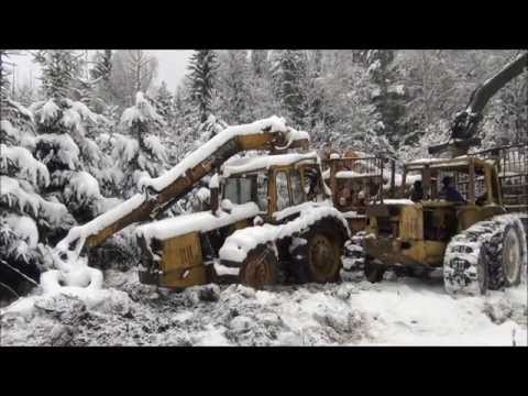

On a related note. A neighbour of mine watched me dump my cyclone content in the yard a while back. He mentioned my truck being a CSV (carbon sequestering vehicle) :smile:
Being blessed with plenty of wood is like having sunshine on a rainy day :grinning:

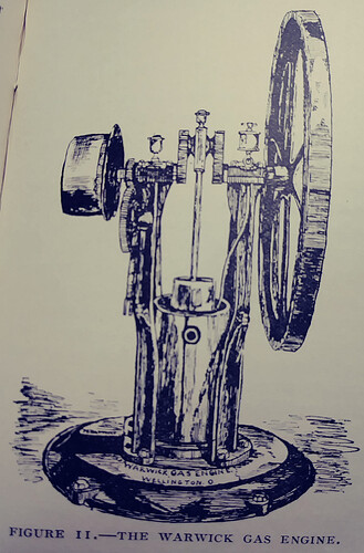

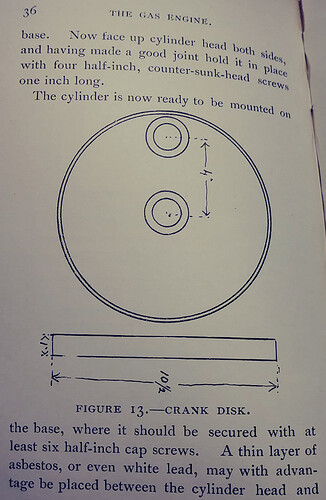

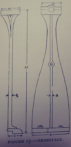

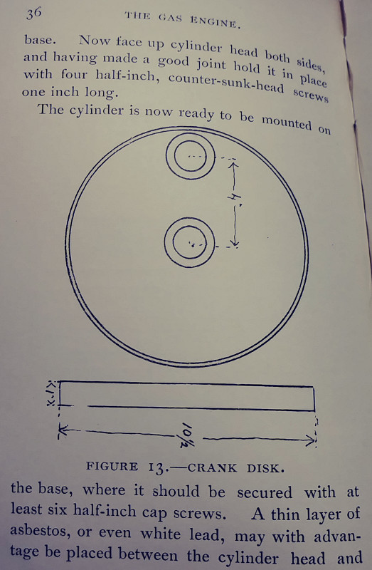

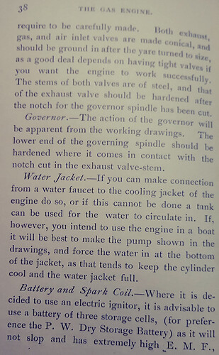

This is another snip from an old book “The Gas Engine, how to make and use it” (1897) by Warwick, that I never had the time to post. Amazing what little information that a DIYer needed back in 1897. Now a days the DIYer needs step by step hand hold instructions, maybe no real DIYers left???

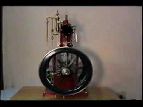

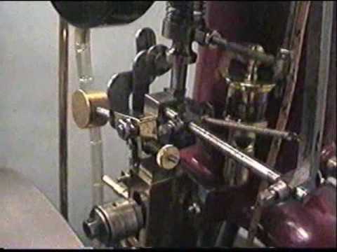

I was at a tractor show in Portland, Indiana a few years back, and a fellow had made a running model of this engine. I think it must have been about 1/2 size. I think he started with purchased, un-machined castings. It ran very well!
Hi Mike,

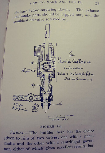

Did you scope out the valving? I’m a bit confused one that aspect. Intake might be vacuum activated.
I think I have the pages a bit out of order. After they are posted I will go back and number them. This is not the whole book.

I don’t know if I ever figured out the valves, it was not readily apparent, I remember being perplexed on how it worked. :roll_eyes:
Actually, the engine I am thinking of is probably this one.
It looks like the one I remember.

Mike, that is a nice engine. However, way over my head to build. :grinning:

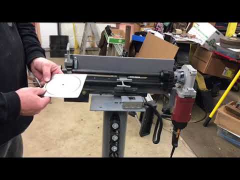

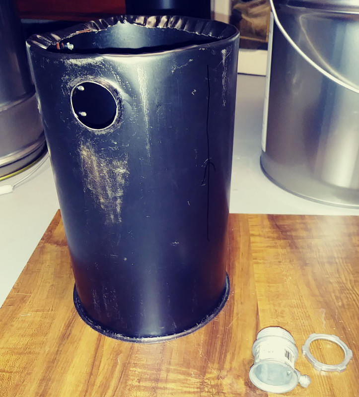

Below is the gas manifold that will help to preheat the charcoal and cool the gas. The bottom style flange is easy to make but not so easy to do the top shrink tuck style flange. Need practice for that or next time make a top ring cap.
Next video will be with my smartphone. I think the microphone is more sensitive also I have an external microphone on order for later videos. I just do not have the voice projection that I had in the past. Plus I have always been on the quiet side.
