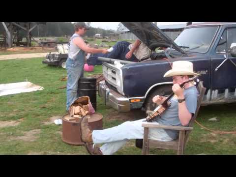

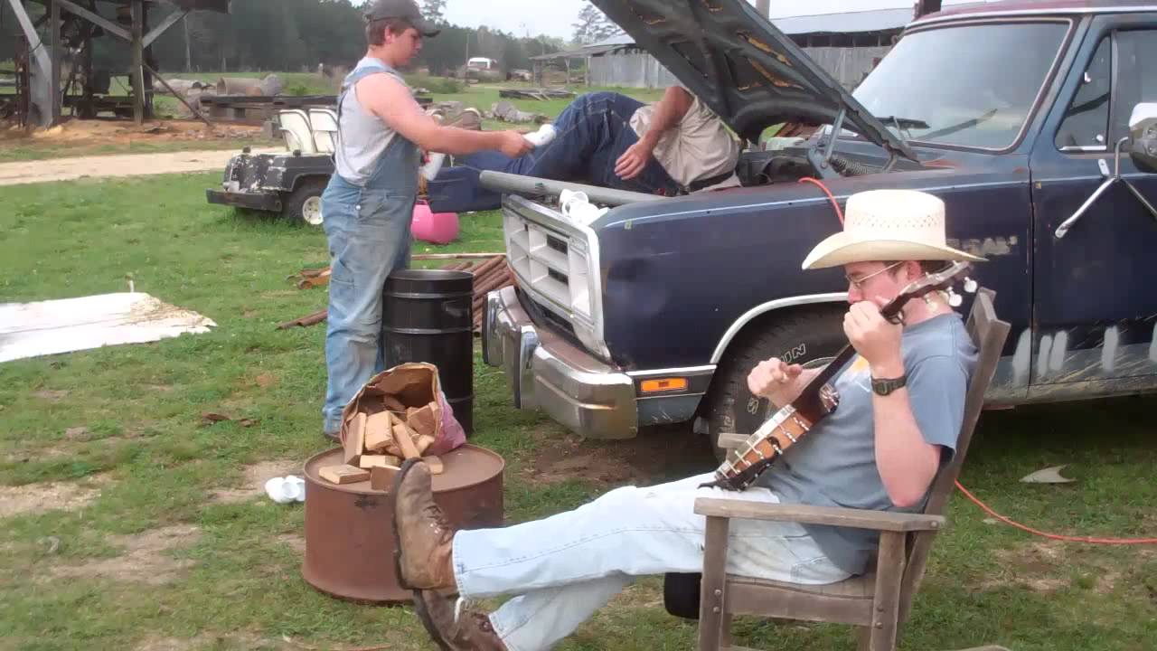

Chris & Wayne, I got my schedule C done while the video was downloading with the phone modem … Fortunately Wayne only had to hang over the edge for a minute … My guess is he was dropping the fittings in another bucket under the hood. At least one hit the ground. I’m hoping you will get your two trucks to Indiana so you can race each other and I can just kick back and enjoy the event. I put new tires on my survey truck and changed the oil yesterday and I guess the noise from the old tire wasn’t the tire. Have to replace a wheel bearing now. Seems I never have time to play … Mike L
Lots of work around here but we have to have a break sometime. On Friday night we fired up the woodburner and headed out to Jacks’ for supper. We watched several folks walk by the truck and not one of them noticed that it was any different. The truck gives no sign of being wood powered. No smoke or smells.

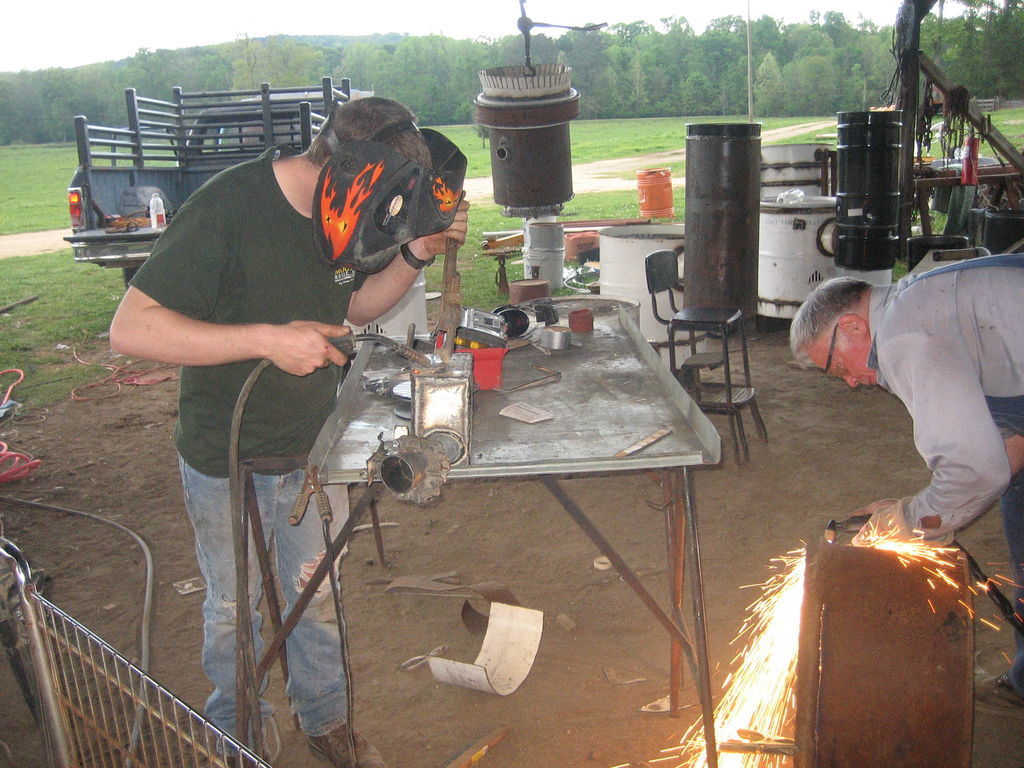

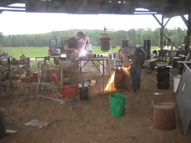

Another good day of progress! We have the heat exchanger done and have been working under the hood. Here’s a few of the highlights:
Nice work all. The throttle body being added looks good. Couple of questions, What are all the extra holes in it going to get sealed with, silocone? Then also are you going to have two gas peddles. Keep up the good work, wish I were there. The banjo playing is good too. I could handle a camp fire and a couple hours of that.
David,
The throttle body is sealed up fine, Wayne had used it previously on the 460 Ford. Yes there is a second gas pedal. I may eventually get a mechanism for switching the linkage on a single pedal, but for now we’ll keep it simple.

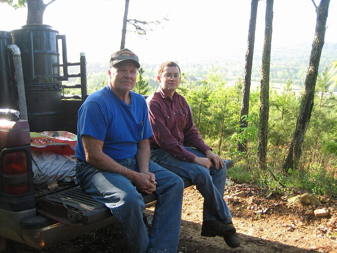

We drove the V10 up in the woods a little, playing with the 4WD.
Wayne and Chris in the mountains. V10 woodburner surrounded by wood fuel.
How many miles per # does this truck get? This is the ideal work vehicle !! How much more power does it have over the Ford?
Hi Ron,
It has quite a bit more power than the Ford. Not for sure on the horsepower but its enough that I can feel it. One of the advantages of the v10 is the multiport injection and the computer timing advance, seems to help the power some.
The mileage varies a lot depending on how I’m using the truck, I think when I was testing it over the road it was getting about 3/4 miles per pound.
