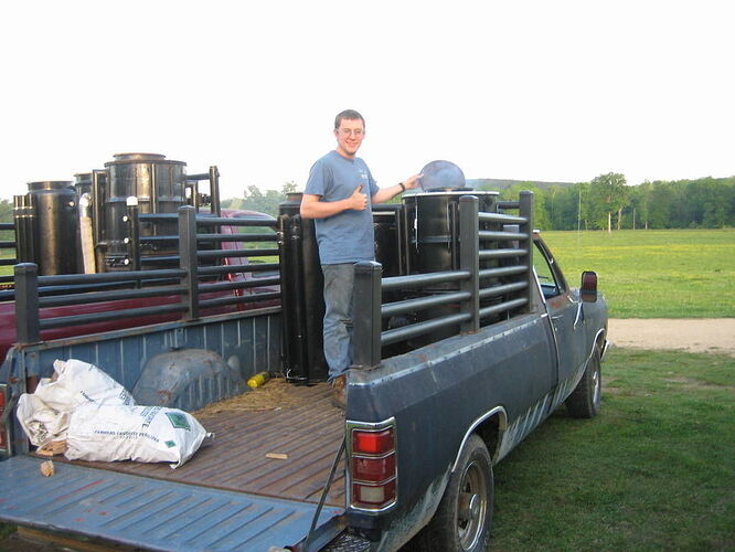

0-60 test. Not a sports car by any means, but we got there alright!
And he is still grinnin :slight_smile:
I think we all are :slight_smile:
That’s very good…I had between 37 or 38 seconds. What size block? 318? What is the time to 60 mph on gasoline?
Yes, 318 V8. My time should get better with practice and final tweaks mentioned earlier. It’s not been tested on gasoline but it would of course be quicker, my guess around 20 seconds. It’s a heavy truck that has put on some weight this last two weeks. Not really overpowered anymore.
One thing about woodgas, there’s no booster for quick bursts (accelerator pump), you have to make the gas as you go. Consequently you don’t get that jerk of acceleration unless you are in a very overpowered vehicle like the Dakota. But once you are up to speed it just keeps gaining, and it will exceed the speed limit without issue.
It’s great that you still have three quarters of your truck bed left! And you have lots of space around all of the equipment. In your hometown, you’ll have to tell people that those tanks you’re carrying keep you away from the gas station… What fun!!! See you soon, Doug D.

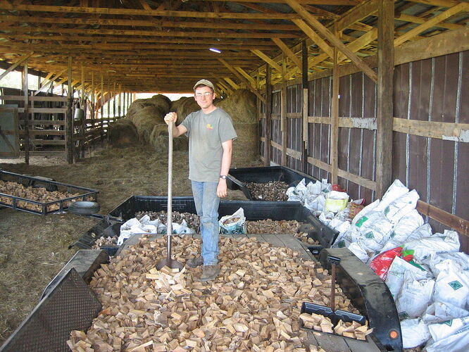

Chris fueling up for trip back to Kentucky.
The filling station for the return trip look very different from those coming here.
Wish I was ready to build I like your filling station alot more than the commerical ones that are charging an arm and a leg to fill up. See ya in Indiana
