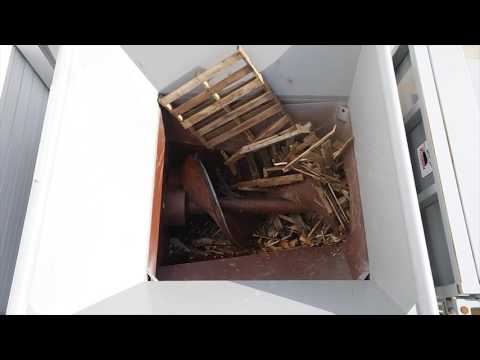

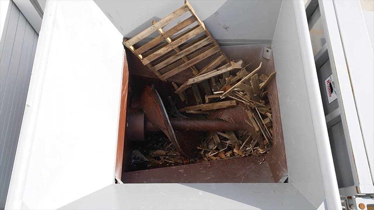

It occours to me that an auger is very similar to a certin type of shredder. If you made the auder flights and the end of the tube reallly heavy, and withe sharp edges, it would shear the wood at the same time move the bits up into the hopper.

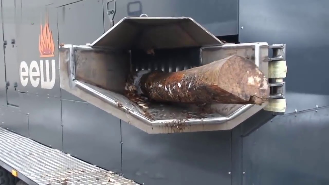

If we had that chunker we wouldent get are old age exersize. here is another easy fast processors,https://youtu.be/7GnVQajyRn4

Check this machine out at the 7:15 minute marker.
Andy; on my way to Green Bay there is a lot where they have a huge shredder. They use a big front end loader to fill it with old pallets and grind them up in chips. They usually have a pile of chips bigger than a semi-trailor. I don’t know what they do with the chips, but I really wonder about the nails in the pallets. TomC
Kevin/ Europeans; Most of these rebak’s are in Europe. Some machines are used in place of “chipper” to get rid of brush. What makes them so popular for fire wood-- do they use augers to feed their furnaces?? Or do they bad them and sell to village people for fire wood-- much easier to handle bags than “split” logs. TomC
Hi Tom Merry Christmas around the corner, yes sir i bet they sold them cut offs for fire wood, i have too addmit if built close enough too Jo’ reback the chunks come out short enough for gasifier vehicle fuel. Got too ask Jo’ ! how he measure his blades too end up shorter chunks, before i build one evenually, looks much faster on the smaller chunking.

Ok yes i see the chunks at the 7 : 15 minut marker, thats a different looking style chunker.$$$$$
