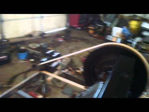

I got the motor mounted and in position. I went with 3 belts from a lawn mower. It was suggested to me to make sure I got good heavy duty belts and I figure mower deck belts endure a lot. I have never had one break.
I have this pulley but it doesn’t have a set screw to secure it to the shaft of the motor. Is this common?
Here’s a video of everything turning. There seems to be a lot more wobble than I anticipated. Here’s a look into my messy garage.
You definately need a set screw on top of the key, and I would put another at 90 degrees to that one. Use your hand grinder to make a small flat spot on the motor shaft where the 90 degree screw touches it. Sure looks like a good start to a great chunker.
If they don’t have a set screw usually they have a bolt in the end of the shaft. Is the keyway in the pulley and shaft the same width?
I wasn’t thinking about two screws. I was planning on grinding a flat spot at 90 degrees from the keyway. I will put an additional set screw on the keyway. Thanks Carl.
@MarvinW, yes they are the same size.
This chunker is looking very nice. As for the pulley, I don’t fix anything until it breaks. It looked like you had the motor and chunker flywheel lined up will enough that the pulley was running true and not trying to work it’s way off. The set screws are a good fix. You could also make a collar out of a piece of pipe and tap/thread a set screw through it to hold the collar/pulley on. Also, I would go for drilling/tapping the end of the motor shaft and putting a bolt with a large fender washer on the end.
For the wobble; yes it looks like a little much, bbuuttttt, I think when you cut the big section out for the actual blade, that you will not see that much motion. As you are standing in the position you will feed it from, the wobble left and right will not make much difference. The wobble in and out will be a problem though. When you cut the helical out, or what ever you want to call it, set the drum so it is in the position closest to you, and make the big step off in that area. You will ALWAYS be cutting in this area no matter how wide the stock is, and you want a good “cut” to finish off, so it breaks loose. If when you are done, you find that where the cutting edge is too far from the anvil part you can all ways add material/ weld on the anvil to take up the space at that point.TomC
