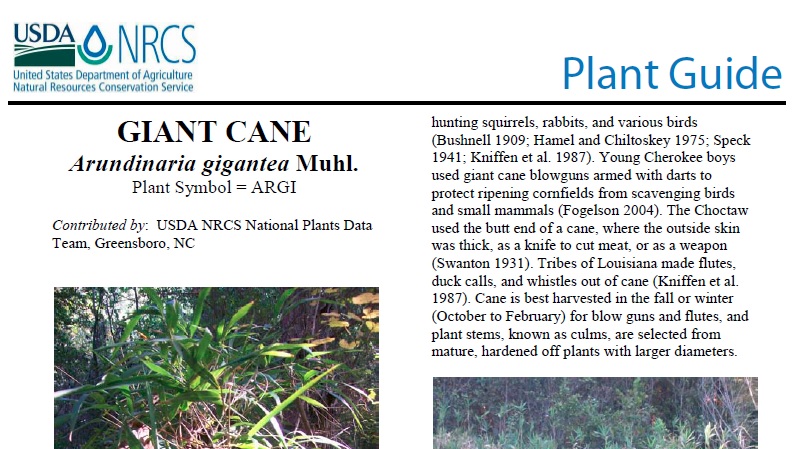

Speaking of bamboo, I have been unable to find a bamboo that would grow in my climate as we discussed in the car.
Hi Bill,
Yes, three’s and bamboo grow from the Co2 in the air. They adsorb the Co2 and release Oxygen back, process called “photosynthesis”
I did find this on google, might point you to some species usefull at your place: http://www.indefenseofplants.com/blog/2017/6/26/north-americas-native-bamboos
or this one:
