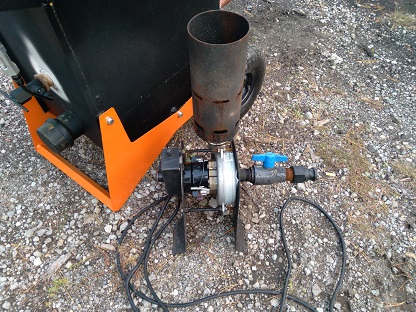

I have just bought the same Ametek 116520-50 blower but it is not clear which is positive and which is negative wire…can you wire it either way and change the direction of airflow?
I can’t test it yet because I am waiting for a 12v120v inverter (we are 240v in UK!). Thanks Tim
It doesn’t matter, they can be wired either way it does not change the direction.

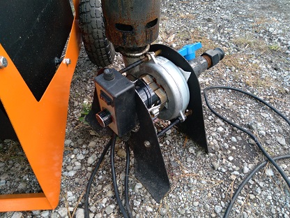

Thanks Matt. What did you use to vary the fan speed (i.e. Rheostat, PWM, Resistor?)
router speed controller from Harbor Freight and also a valve inline, the speed control is not enough. I run all the way down and choke it down some to slow the output.

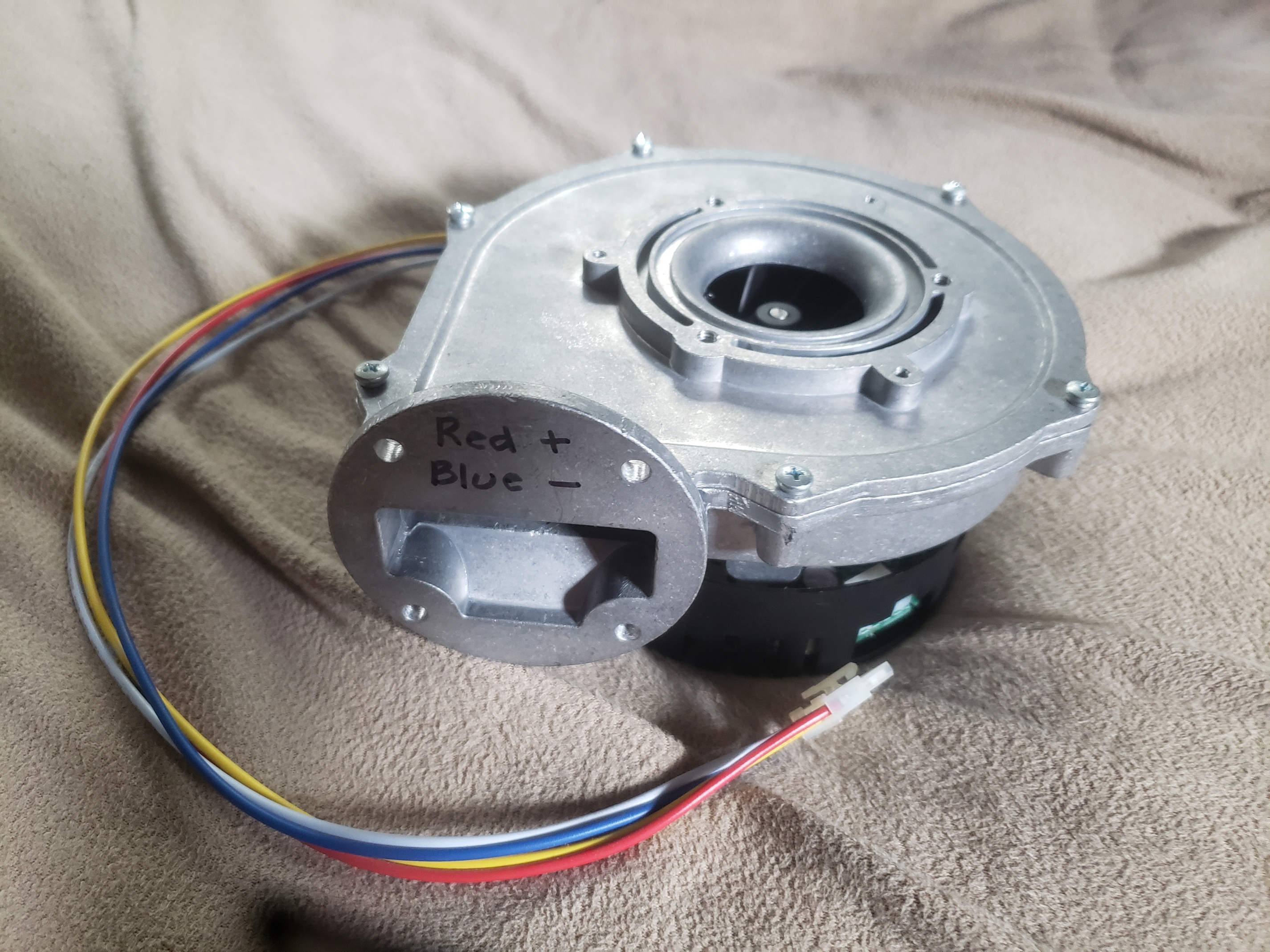

Whats up guys. Anybody have any experience with this blower? Its the one specified in Ben Petersons book.
Nope I use the AmTeck blowers much cheaper and they are extremely powerful and are all metal with the motor isolated from the housing. Plus they are very abundant. They are also AC so a little 400 watt inverter can convert to DC. You then have a dual voltage set up. I run on AC direct from my off grid system. But if needed I can just use a 12 volt battery using the inverter.
The picture shows a plastic housing. These are not plastic like shown in the picture though. This part number is the all metal version.

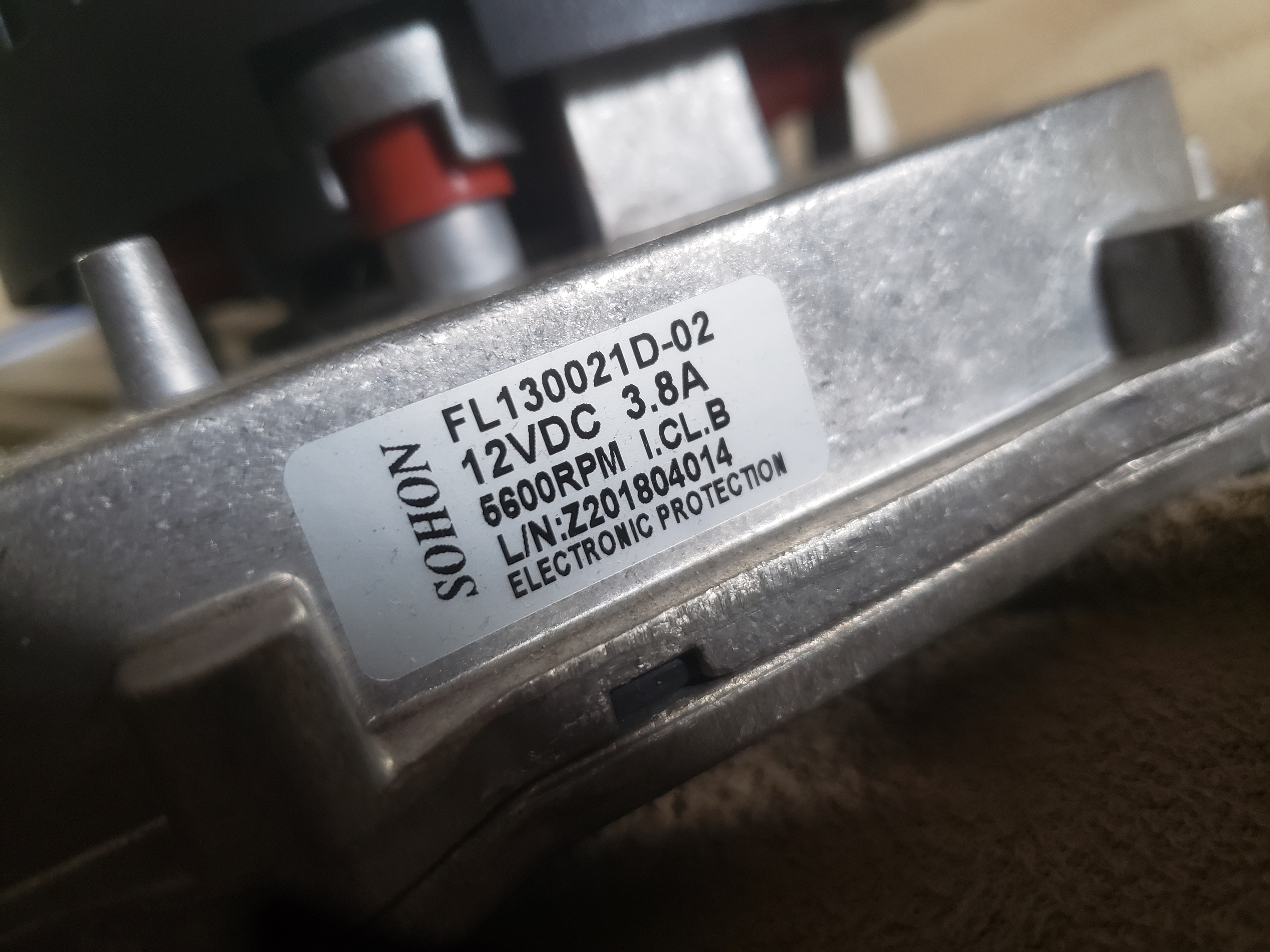

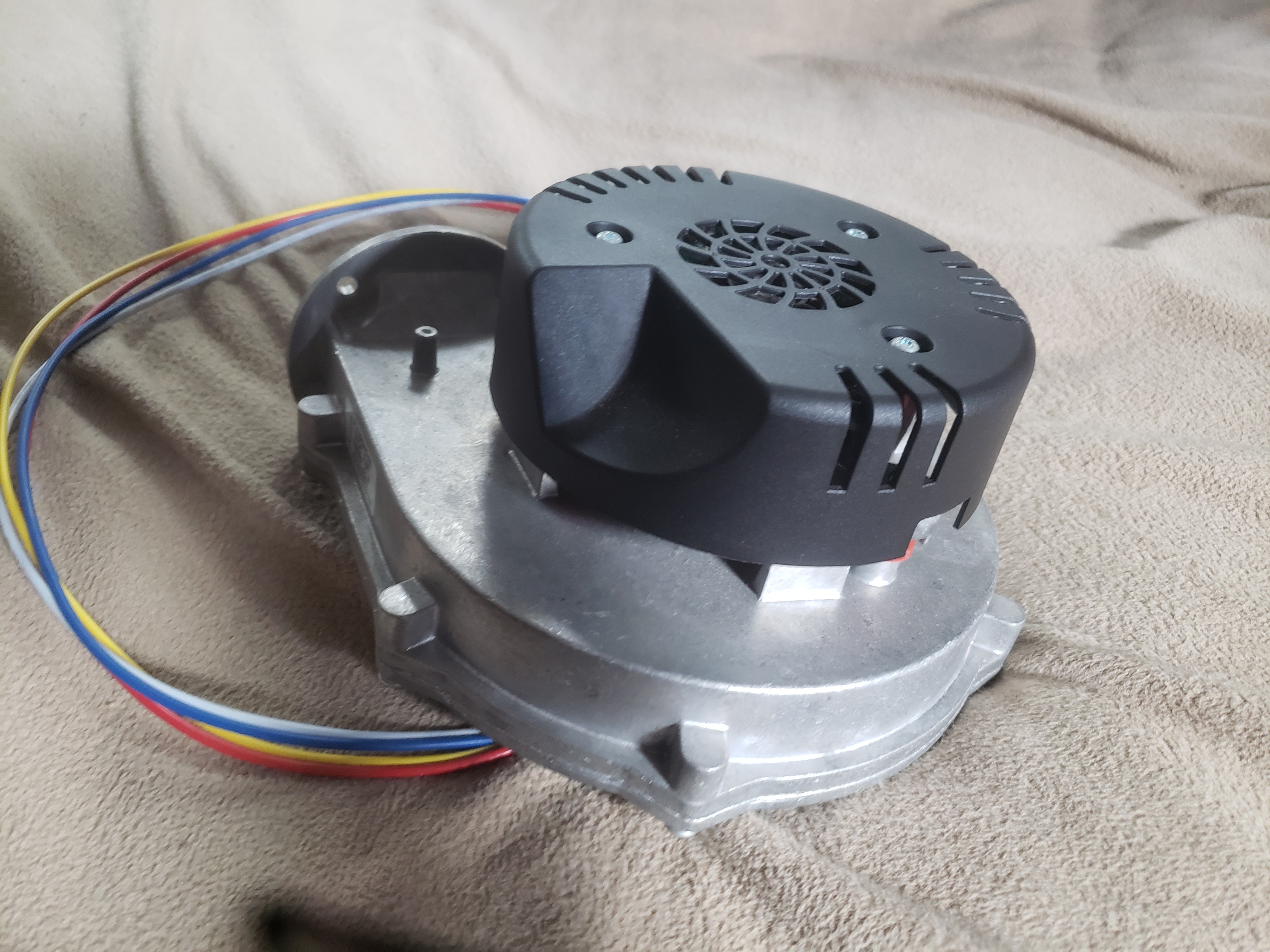

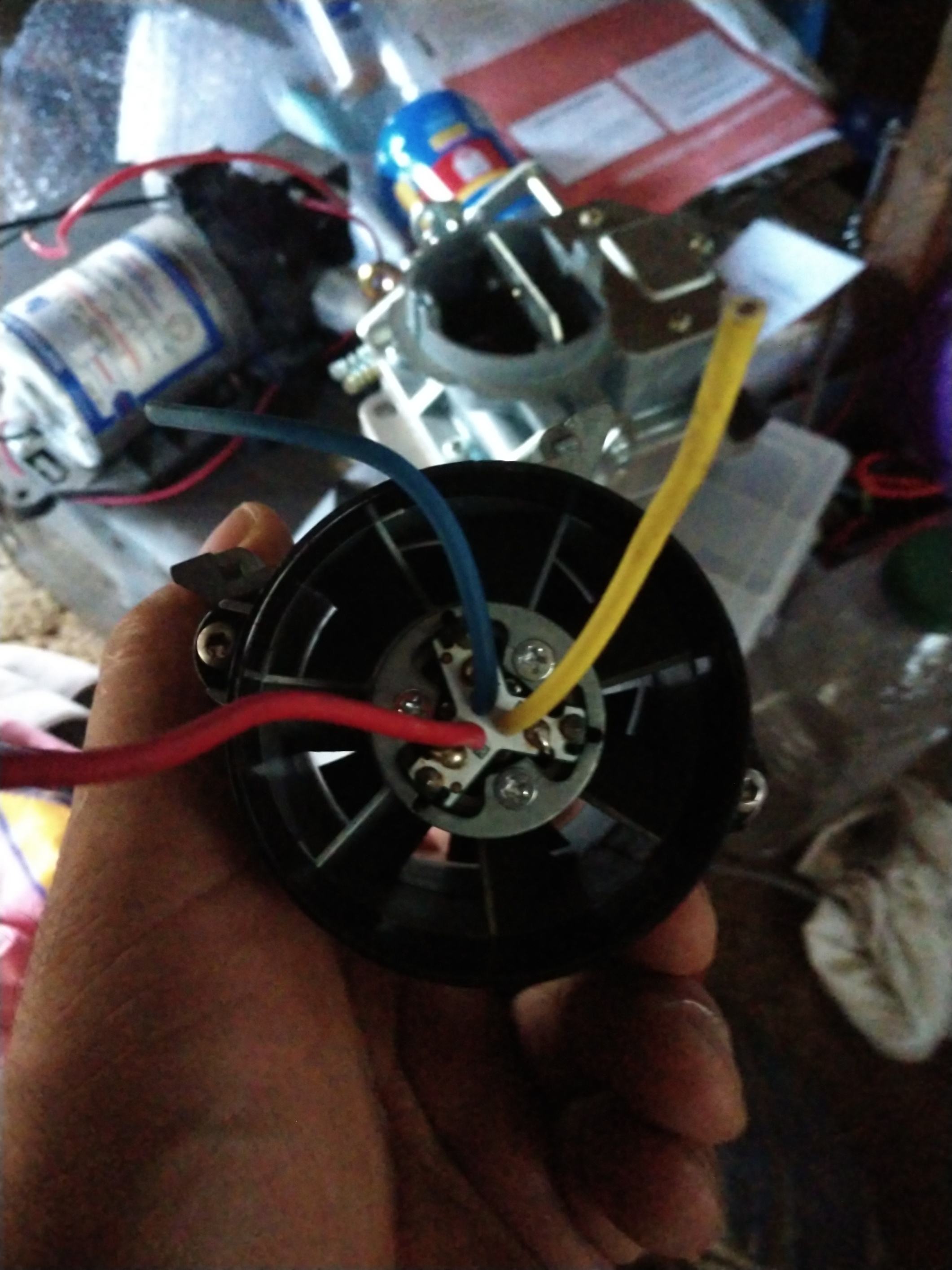

A quick search revealed it’s a brush less direct current motor. BLDC. The commutator is controlled with some sort of switching power supply. I ran into something like this buying a fan for my oil stove. I need to figure what wires need the pwm signal. Once the correct circuitry is arrived at, this little bugger should be very efficient.
Turns out my motor is three phase BLDC, the ESC I need is $7, but I cannot find one that matches your FL130021d -02 anywhere. Can you take the back cover off and see if it is three phase too? If it is, then just about any ESC will work.
Yes. I have used many of these. 12VDC as noted. Very watts use efficient. Brushless. Sparkless.

Specs on this blower are 5.7 amps @ 120 volts comes to over 600 watts. But this is the max. Im using a $25.00 Harbor Freight 400 watt inverter and have not had any issues. So I dont they are set up at full amperage. These are kinda cool as you can adjust them by turning the motor somehow. There is a couple youtube videos showing how to do that. Its recommended that you turn them down to extent cycle life.
These blowers are tuff. I just ran today and left it out in days of rain and it was full. lol I didnt realize it until after I turned it on and was shooting water out like a water pump!! haha. Cost wise my opinion these are a way better deal. For $120 -$140 bucks you buy the blower, DC inverter and a router speed control. Either way you are converting to AC.

Wow it turns out Greg Cooper in 2018 ordered one of these and got it working with a little ESC as seen in this picture…he says he paid over $300 for two of these…uh…that’s three barrels of diesel down at the Res, that’s like six months worth of fuel…
I think Matt has a better price point…

Hey Bruce, I the owner of one of these Chinese blowers still have not answered your three phase question.
Last seen/used this one six years ago.
I cannot find it now.
I personally was more happy with the non-electronics brushed types Metro motors. So stocked up swung that way. 20 minutes capability was just fine for my needs.
On its four wire factory plug either the not used white or yellow wire was for off-board speed control. The other a pulse output for off-board RPM monitoring.
Vancouver Victory Gasworks shop we found that these sucked best at factory set all out RPM. Never cared how the off-board speed was controlled or RPM mentored.
Mistake to speed throttle these back these low wattage units for woodgas usage.
And hard learned experiences had taught me that even 115vac, 2 1/2 horsepower shop vac were much easier to inlet restrict throttle back versus electrical side speed controlling. Work loaded less, pumping less air load; they speed up unloaded. Draw less amps. Easy to verify this with a KIllowatt meter.
The first 400 batch of the Chinese units to come into the US were sent wrong with 24vdc specs. The under the black cover whole DC to AC pulsed phased section was just three?four?(been eight years!) hold down screws removed and replaced to the correct 12vdc. driver unit. Same RPM. Some loss in against resistance pressure/flow capability.
