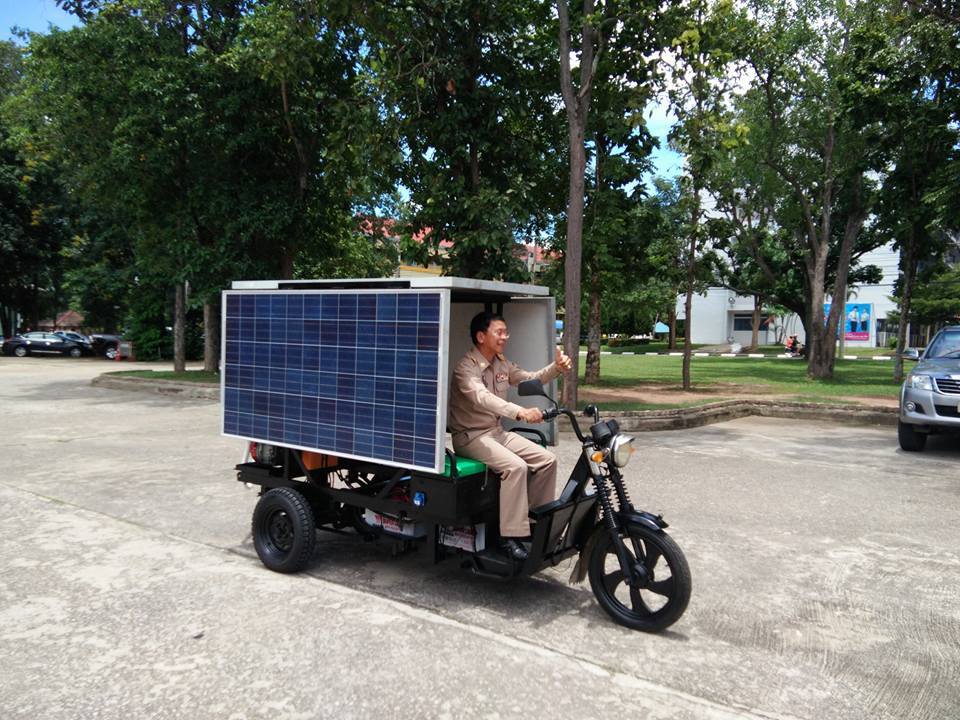

looks nice but one heck of a blind spot I imagine.
Hi koen, i was just wondering what kind of light batterys them are,and if your old style trike is being mass produced yet. Yes thanks for the design’ing updates.And if my english looks off, it likely is.

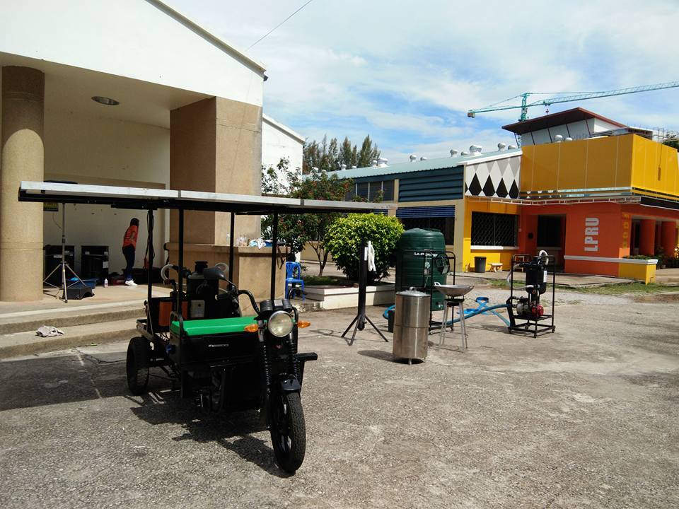

Hi all,

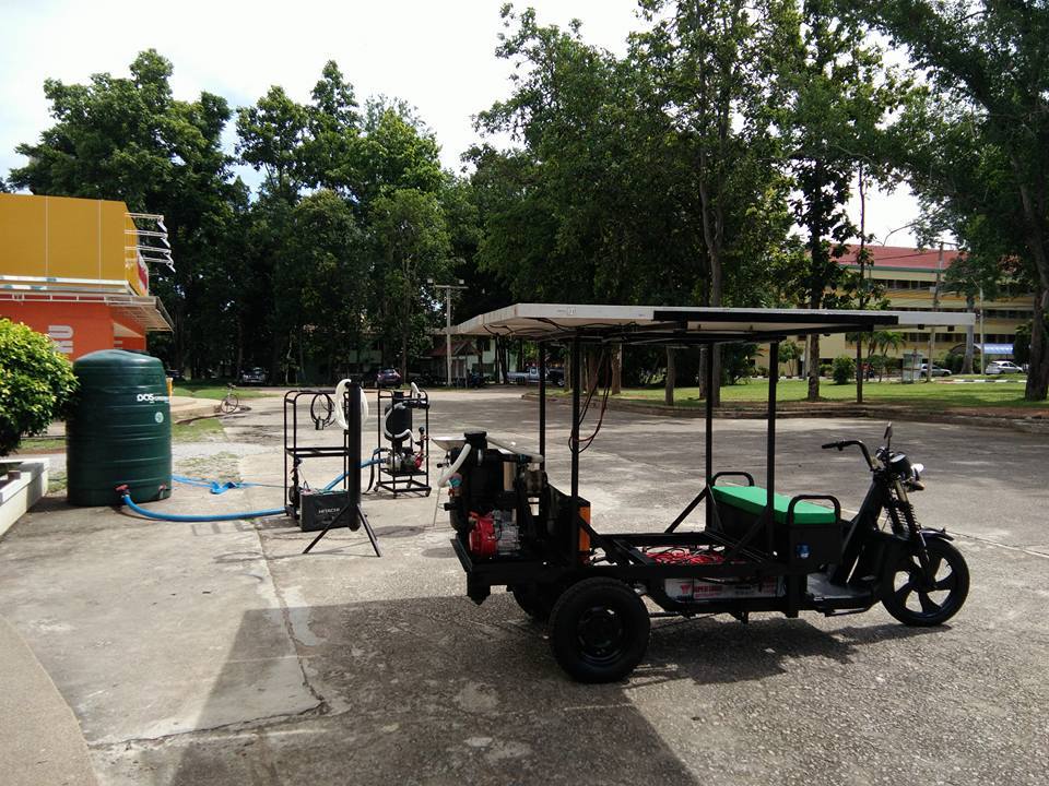

Voltage on board, 60 V
5 deep cycle battery’s 130 Ah
inverter, 3000 watts, 240 V 50 Hz
3 solar panels, Pmax 280 watts per unit
Alternator on GX200 Honda, standard 24 Volts 80 amps, modified to charge 60 Volts
Manipulating the field coil with PWM and voltage limiter.
Charcoal gasifier good for up to 12 Hp engine
GX200 can be belted to either the alternator or a centrifugal pump ( 30 cbm/hr )
Electric motor for the trike is a shunt type, 1200 watts
Electric water pumps can be used , even on the solar panels/inverter only.
The GX200@4000 Rpm, on charcoal gas, driving the alternator, produces 2200 watts.
Viewing angle from seat position, 180 degree’s
a fun toy to be prepared for offgrid living
Hi Kevin,
The battery’s are 130 amps, deep cycle

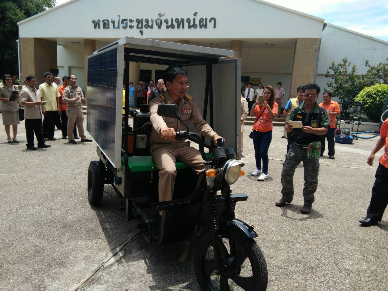

Hi paul, yes, its a narrow view, but still ok at 180 degree’s

WOW!!! All that you have accomplished is just amazing. Can’t say anything but WOOW!!! Put some truck rear view mirrors on TomC

It looks pretty sweet! Hopefully it works out as an extremely useful tool for you as well. I love how the panels fold up!

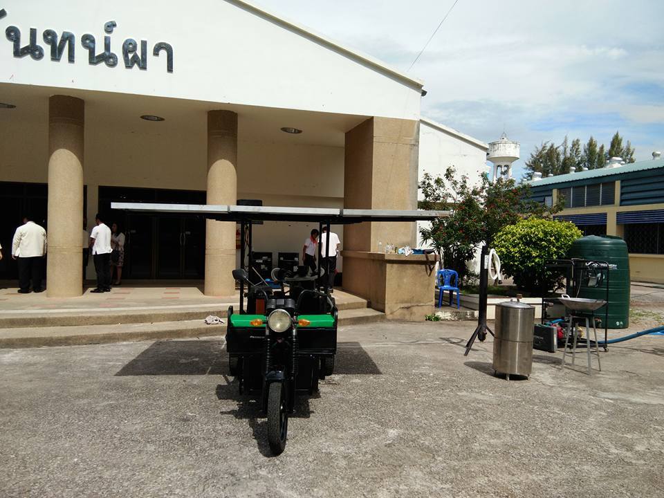

Had a new show to attend…
University to sign an MOU for community and university to work together, partial my work to teach.

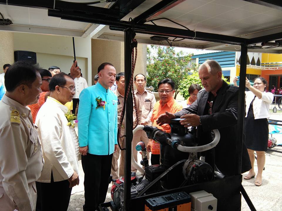

One minister from the Prime ministers office, head off National Research Council Thailand getting a tour and posing on the pictures…
Also, the Governor could not withstand taking a tour on the trike… had to give him a sip of lemon juice…

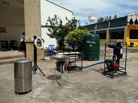

What is the green tank in the background with the blue hose for?
Hi Don,
That is a water tank, to show off with the waterpump…
