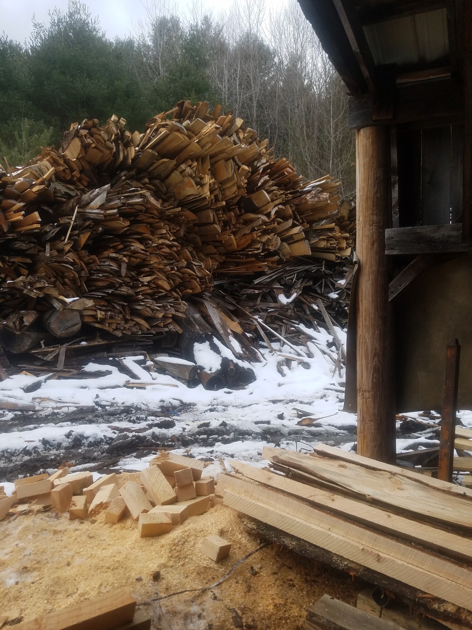

Whats convenient is my father in law has a saw mill 100 yards next to my house and has a literal 30 foot pile of slabs that is 100 feet wide and growing everyday. I myself do treework currently, have a 14 inch chipper for chips and of course saw dust from mill if i wanted it. So i think i could manage fuel well with my labor in processing it. I would gladly trade my electric bill for my labor.

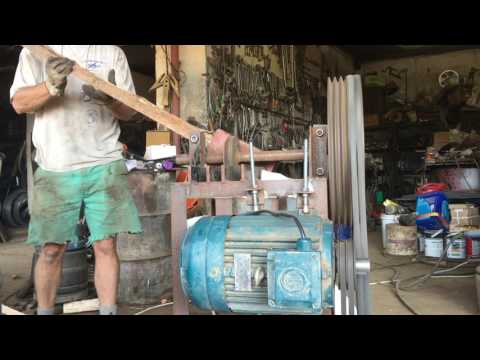

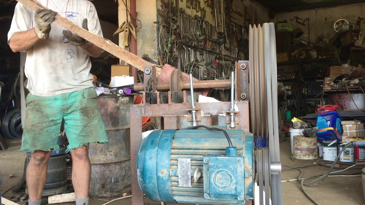

Thats another cool wood chunker, also seen Keiths. They are a must have i would think. Suppose i could also bury my 95 cc saw into the slab piles.
Helped saw some future fuel today
Hey George
I feel your pain :smile:
I also have a slab pile building fast .
Today we did three logs twelve foot long 8x 3/4 inch clabboards and made a bundle of slabs in about three hours
