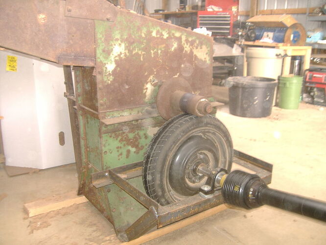

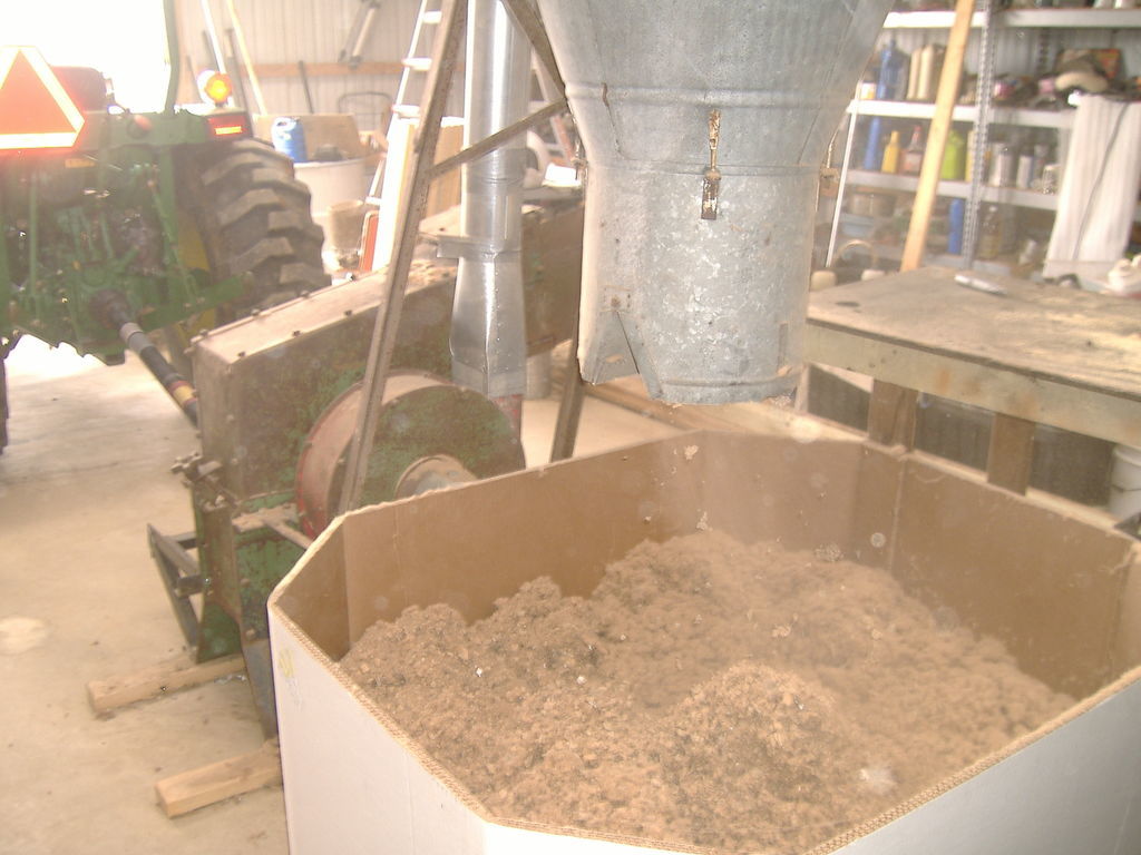

My hammer mill is an early 20th century unit designed for general farm use. It was designed to operate on the old wide drive belt type side PTO tractors. I modified it to operate on my modern rear splined PTO tractor. It came with several screen sizes. Regarding “reducing the volume”, It kind of goes backwards with cardboard. Pulverized cardboard is very fluffy allowing a lot of airspace. It takes up about three times the original volume unless you compress it.

I’m sure there is merit to using cardboard for pellitized fuel, however, the processing would be energy and labor intensive… It’s amazing how much energy it takes to pulverize. I can easily choke down my 40 HP tractor, while hand feeding the mill. I believe the pellitizing process would be similar.
Nice job Richard converting that hammer mill to pto drive. It even turns the right way with that friction drive. I am making a wild guess that it has about a 6 to 1 speed increase so with a 540 pto wide open it would make about 3200 rpm. I’m guessing that is quite a bit faster than the flat belt ever drove it. Are those bearings up to those speeds or do you run at part throttle?

I was kind of proud of that project, because it actully worked out. There’s noone around here to appreciate my little successes. You are right on with your wild guess. The mill is rated for 2400 RPM. I run the tractor at about 1500 RPM. I think that puts it in about the right range. I sure don’t want to be around when things start coming apart in there. That’s a lot of iron flinging around in a small space.

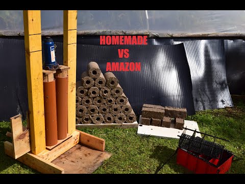

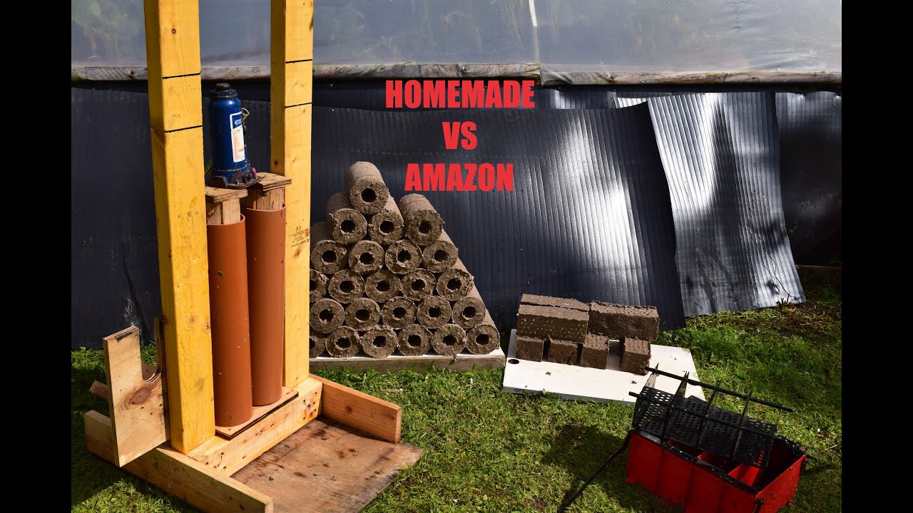

There is a fellow on youtube, who has done extensive work with sawdust briquettes, etc. I have enjoyed watching his videos over the years, he has solved a lot of “home” scale production issues. This is his channel, once there, search for “briquette”.
