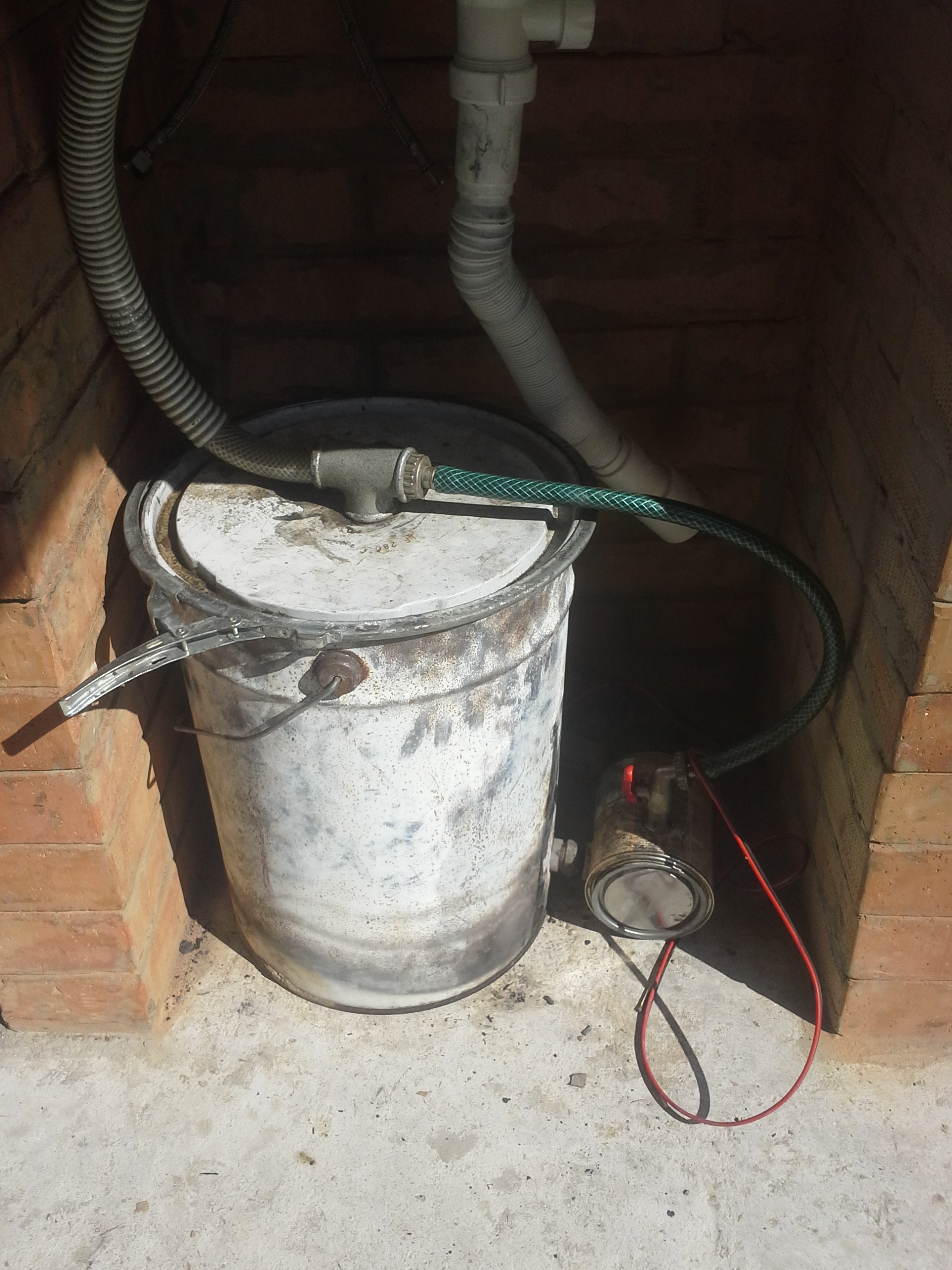

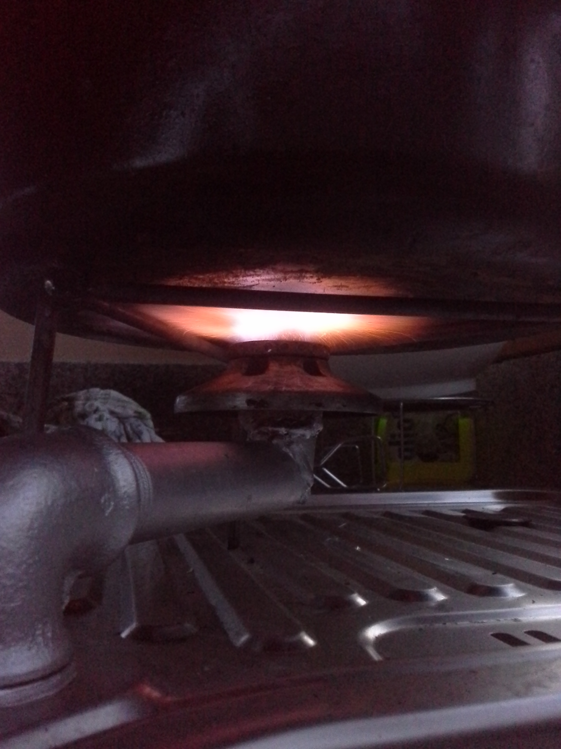

There is noting better thain to sit in a shadow of a winegrape in the heat of the summer with a cold one on your left and some fresh grilled meat on the right so I finaly decided to build summer kitchen. Includeing all a real kitchen neads l decided it wuld be sort of shamefull for a wood gas enthusiast to run a summer kitchen on propane l am planing to make a charcoal gas stove.
The plan is to use a small charcoal gasifier and a smal fan to push the air in a gasifier. The gas will go directly from charcoal to the burner, no filter or cooler. It wuld all be incorporated under the desk.
My question is has anyone got a similar system? How does perform?
Have a nice day from suny Slovenia!
coincidence…
Your new , award winning, cooking set… Ready and waiting for you…
Looks great! Is that a fan on top? Is it batery operated?
yes, its a fan, can be operated with 12v transformer or external battery. i have it running wih a small pwm controller

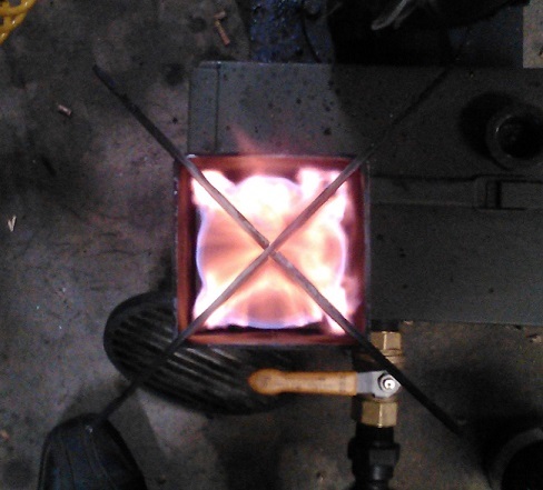

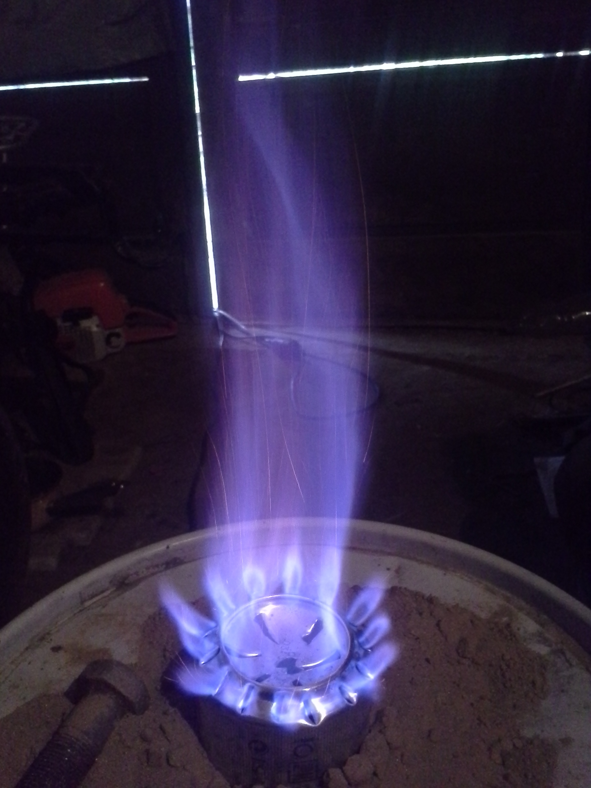

I just had to share this buty:
Things are cooking in my workshop :wink:
That’s pretty Kristijan, do you have a shot where you mix in the air or is it a mix valve before the blower?
its a positive presure gasifier so the air is pushing in the gasifier. No aditional air aded just stright from the simple fire gasifier.

What a buty! Such nice a flame! Is that square thing a filter?
Yes that is an ammo box filter, we fill this with lava rocks. It works quite well at getting the dust out, the dirtier it gets the better it works. Once it gets too filter you can burn them to burn off the debris and then reuse them. :fire:
Great idea! You use no cooling rail?
Nope not on this one. The idea is to get out the ash and inject the gas before condensing can happen. For cooking this is not an issue anyways this little machine makes pretty good gas like this and I have not experienced any soots on my pans :slight_smile:
You anwserd my next question :slight_smile: you made me rethink about charcoal.

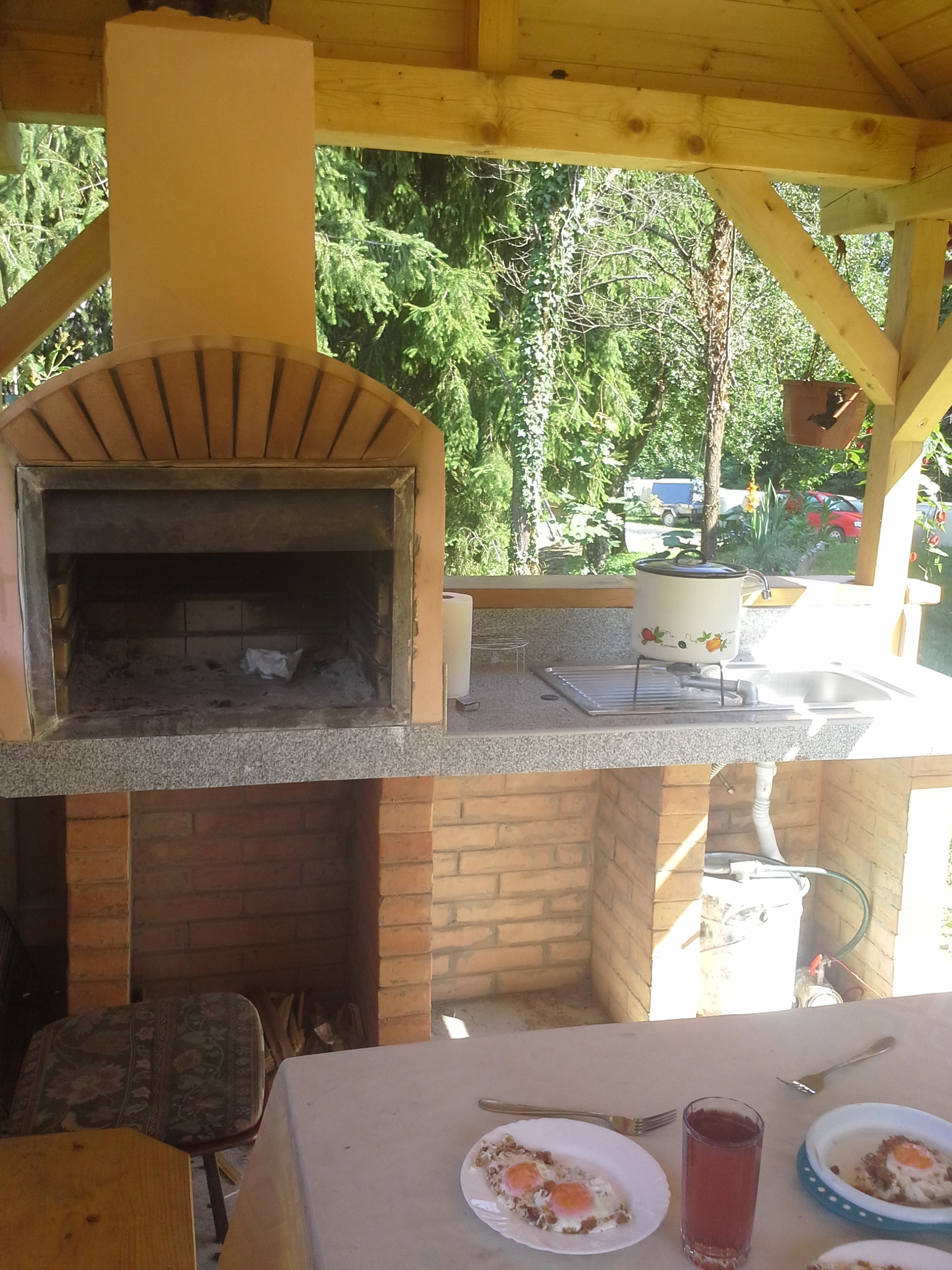

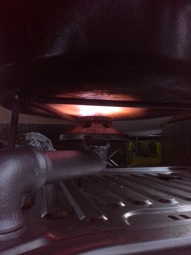

The summer kitchen is near completion!
This is a test gasifier, will make it a bit pretyer. Two computer fans on a 12v scooter batery

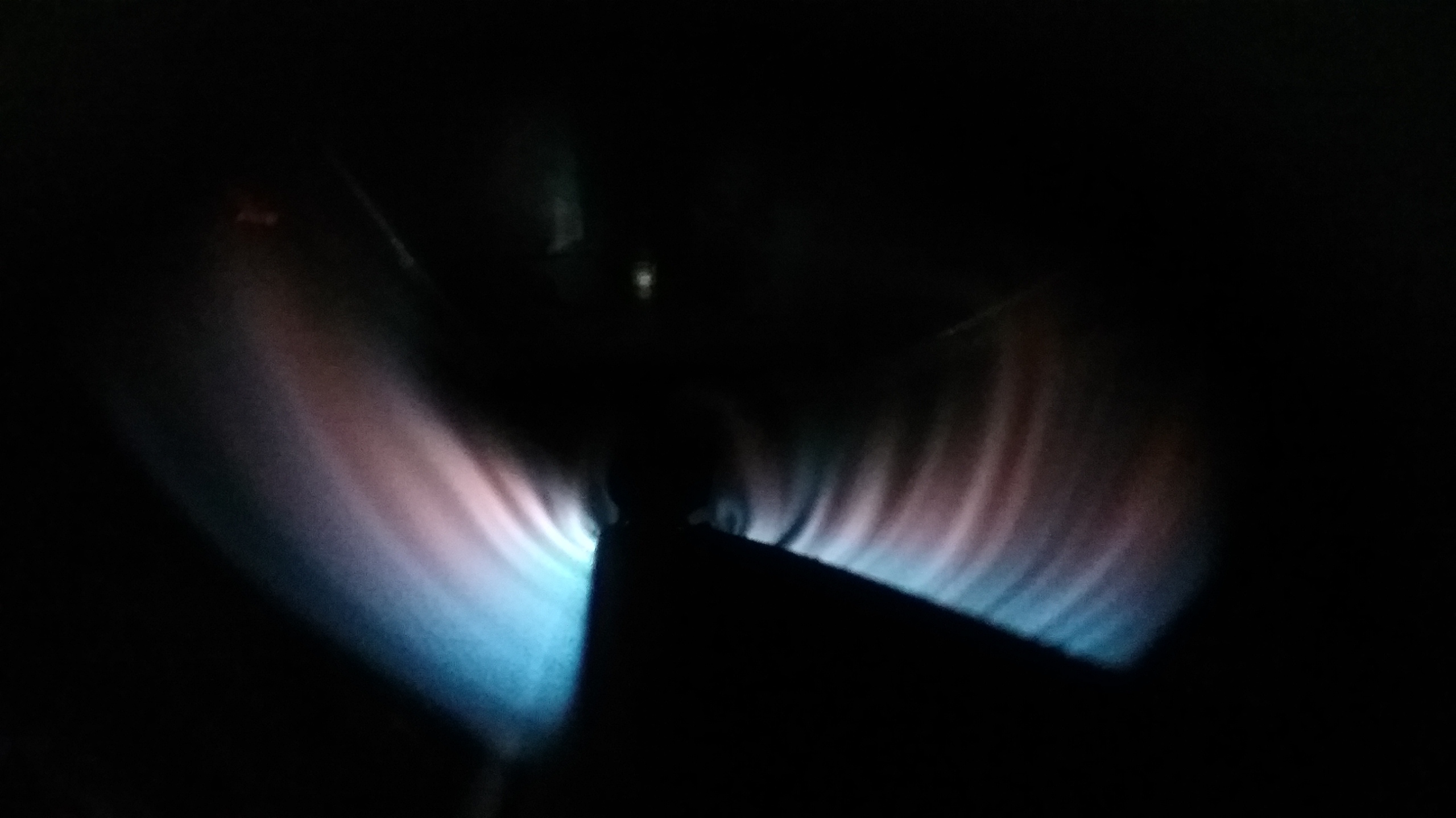

the night pic

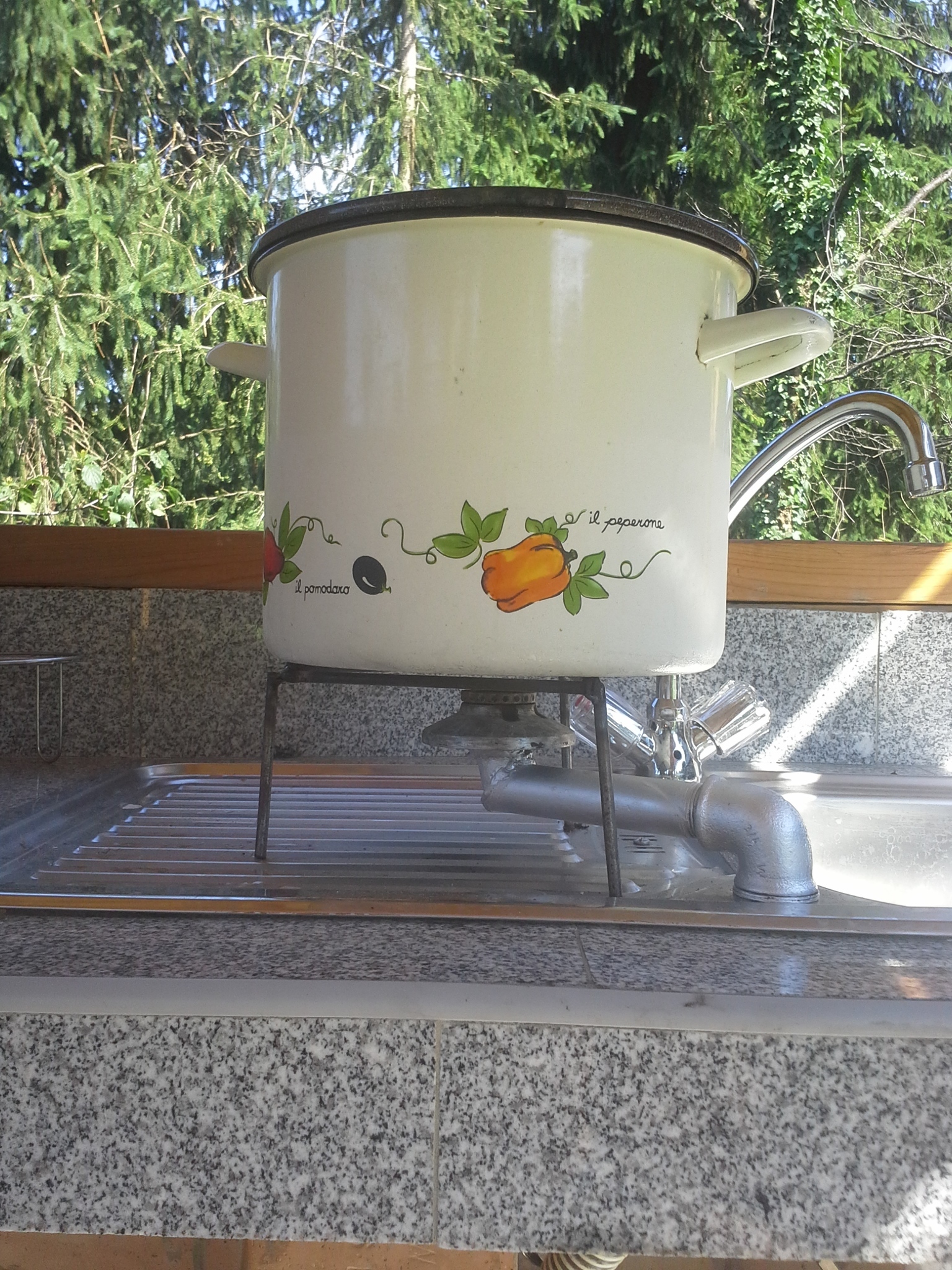

breakfast and lunch in preparation :wink:
The gasifier will be hiden under wooden dors. It cooks nice and man it sure economical! It can burn over 8 hours before neading to refill.
Hi Kristijan,
That is a great looking outdoor, rain or shine kitchen. The marble slab is superb. It looks like there may be a brick floor in the oven and the marble is only a face piece in front of it. I wondered about the heat on marble. Well done.
Pepe
Kristijan, that sure is nice. I bet you even grew some of the food. Doesn’t get any better than that. :+1:. :beers:
