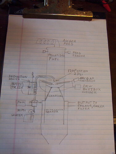

Hello, Mr. Cioni,
How about a carbon arc furnace and injecting plasma steam. Wihtout all that nitrogen in the mix, the energy of the fuel should be
5 times higher than woodgas; more than paying for the electrical energy needed. Should com out with H2, CH. CHO, CO.
What can w develop together??

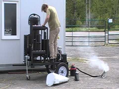

Here is a gasifier for clean syngas
