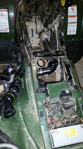

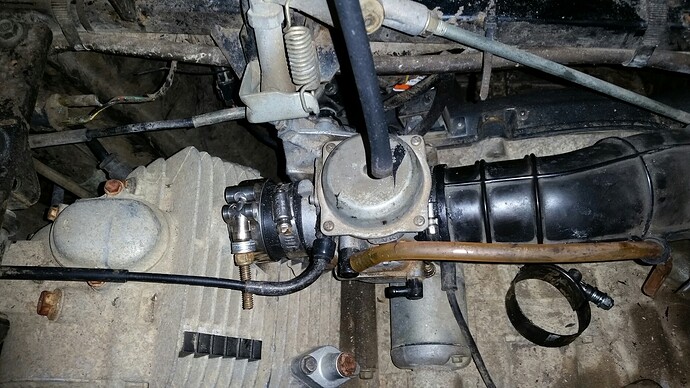

My poor atv has sat ignored all winter. I finally figured out a long standing problem though… the rubber vibration mount from the carb to the engine was split along the bottom. A 12 dollar part totally non related to the gasifier end was messing me up. Took off the gas tank to access everything and decided to redo the plumbing. Abs pipe with rubber transitions for flex.
