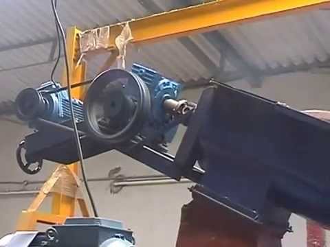

Then we used charcoal power on a 1947 Case tractor powering a chunker. https://www.youtube.com/watch?v=fMxtBDYXiik

Our next step is to make a “sprout chunker” to turn brush and twigs into heating fuel to remove dependence on pellets - and clean up around the farm.
