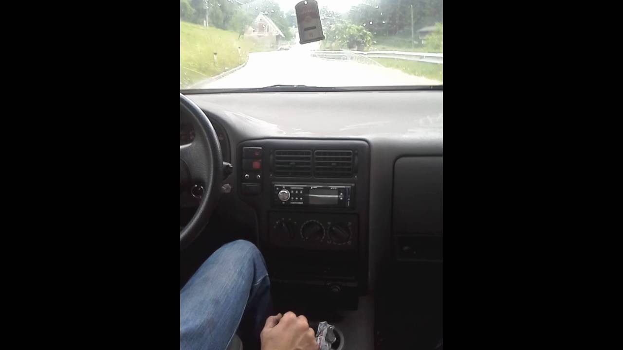

The drive startup video:
It was raining so no top speed lm afraid but hope you like it anyway…
Thanks for the ride, it was really nice. Well done…
Thanks Kristijan for the ride , enjoyed it very much
