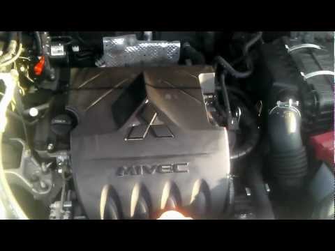

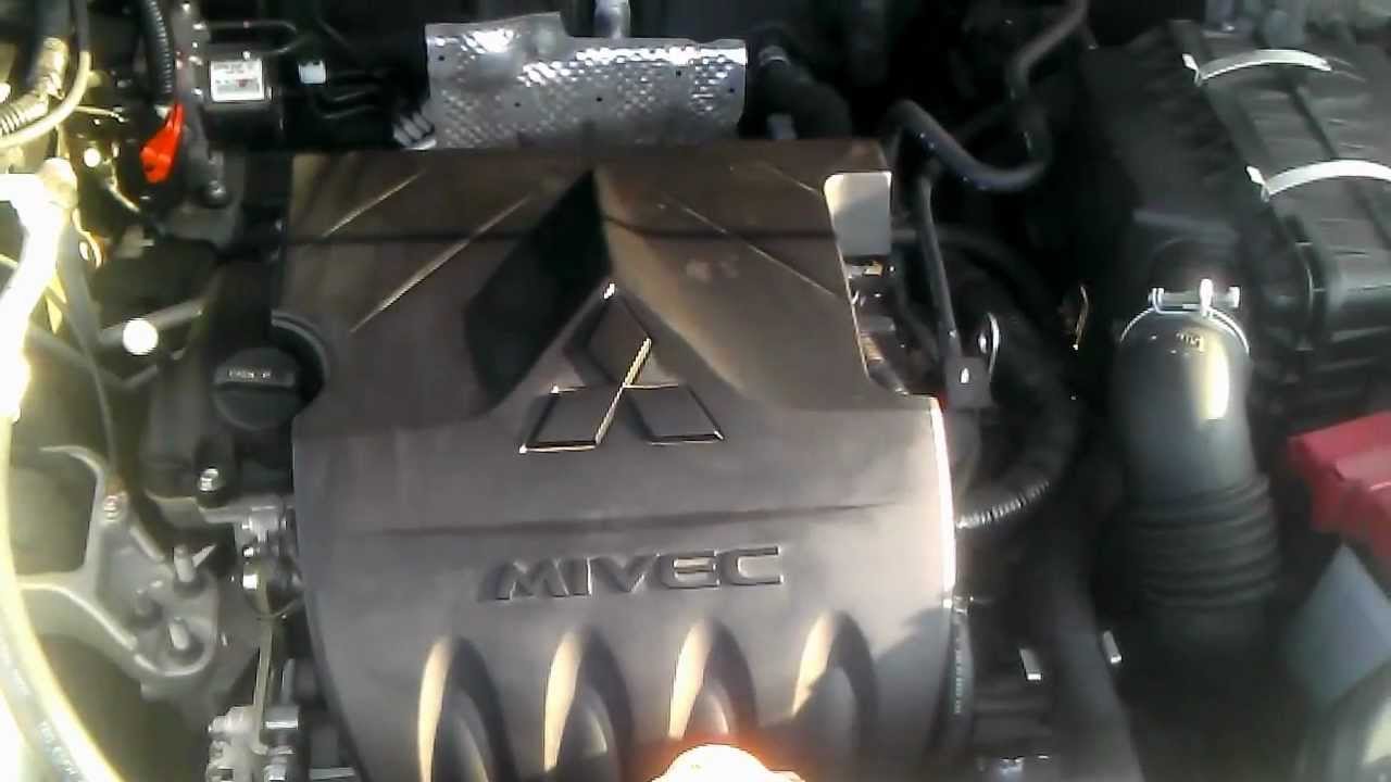

Hi, so at least some had crated an almost hybrid wood gas petrol car, but guys - i would not try to drive in the same room with gasifier…But where are certain car, like mitsubishi rvr/outbac sport asx with small petrol engine and a lot of space under the hood.
I got this car, and it is absolutely possible to place 20++ litre square metal box close to the engine.

As for the gasifier being in to the motor compartment, it wuld sure be inovative, but 20l realy isnt much. 20l is preety much the volume of the reaction zone from a gasifier of a this size engine, so there isnt many room left for the fuel it self.
Try it and report!
20 litres is about 5 kilograms of charcoal. Or at least 4 litres of gasoline equivalent. Think of it as plug-in hybrid - constant speed on woodgas, acceleration - on petrol. Only damn that new engines controllers. + 50 km on hybrid mode should be possible.
Well yes, but keep in mind you can only burn charcoal up to the reaction zone. So those 20 liters now become 5 liters of useable fuel.

I am still struggling to see where inside that engine bay you could squeeze a 20 litre container , looked pretty much full up in there already
