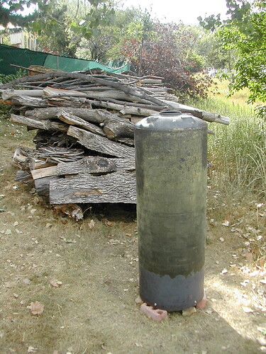

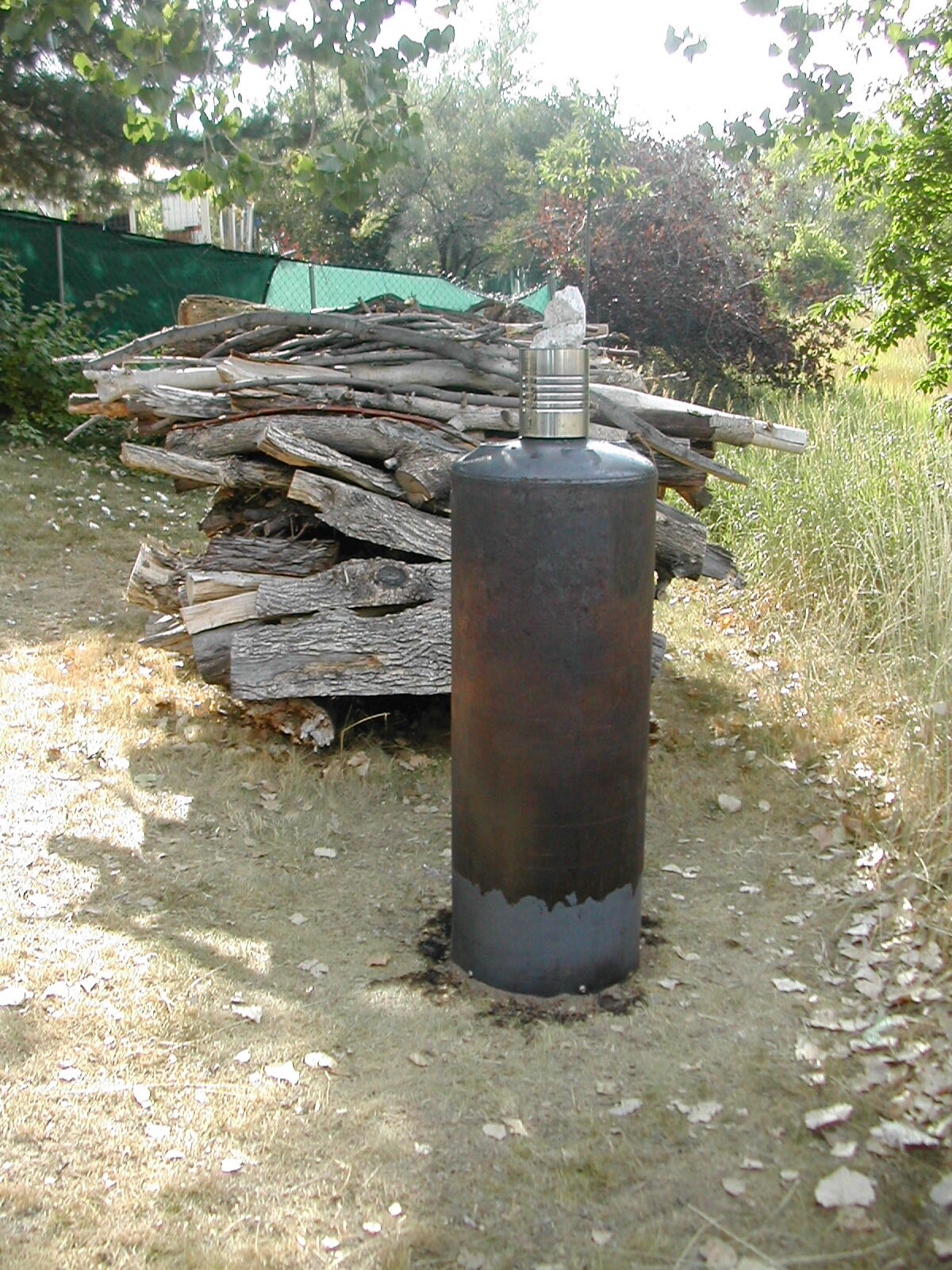

This my simple system for making charcoal. It is a TLUD (Top Lit Up Draft). It is made from a broken water heater. It makes about 30 gallons of charcoal at a time. It starts with 50 gallons of wood. When I want to stop the burn I take off the chimney (3 coffee cans) and put 1 coffee can on top with a piece of cement (weight) on top. I also take out the bricks and put a little dirt around the base. This works very well. A TLUD must have dry wood. I hope you can see ideas here you can use.
hello rindert, have you cut out the inner pipe of the water heater?
how you fill it?
you use wood for it like the size behind on the foto? or twigs?
can you explain me a bit more how it works?
thank you giorgio

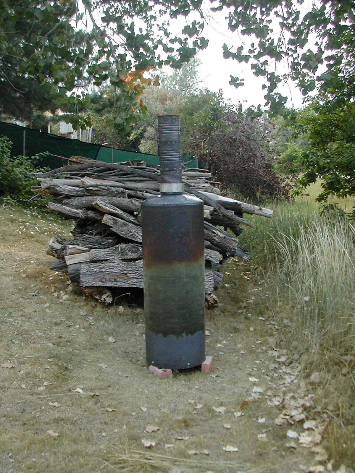

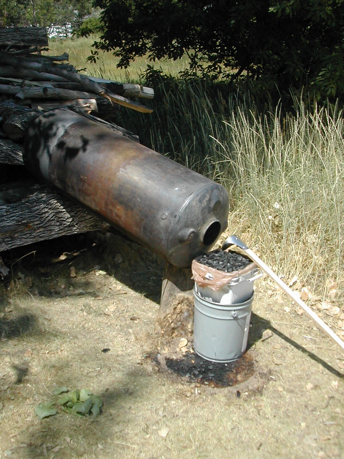

Here are more details of my TLUD
Yes.
hello rindert, thank you. can you explain the system more?
for what is the afterburner?
how do you recognize when it is ready and you must close?

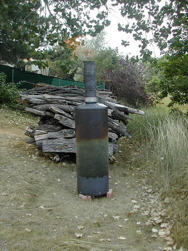

Hello Giorgio,
This picture is from the first time I used this TLUD, so you can see that the burn has only gone 1/3 down. A TLUD is very clean because the afterburner burns the smoke. Really there are two fires.
First I begin to see a few burning pieces of wood come out of the grate. Then I see the color of the flame coming out of the afterburner change to yellow from red and purple. This takes experience.

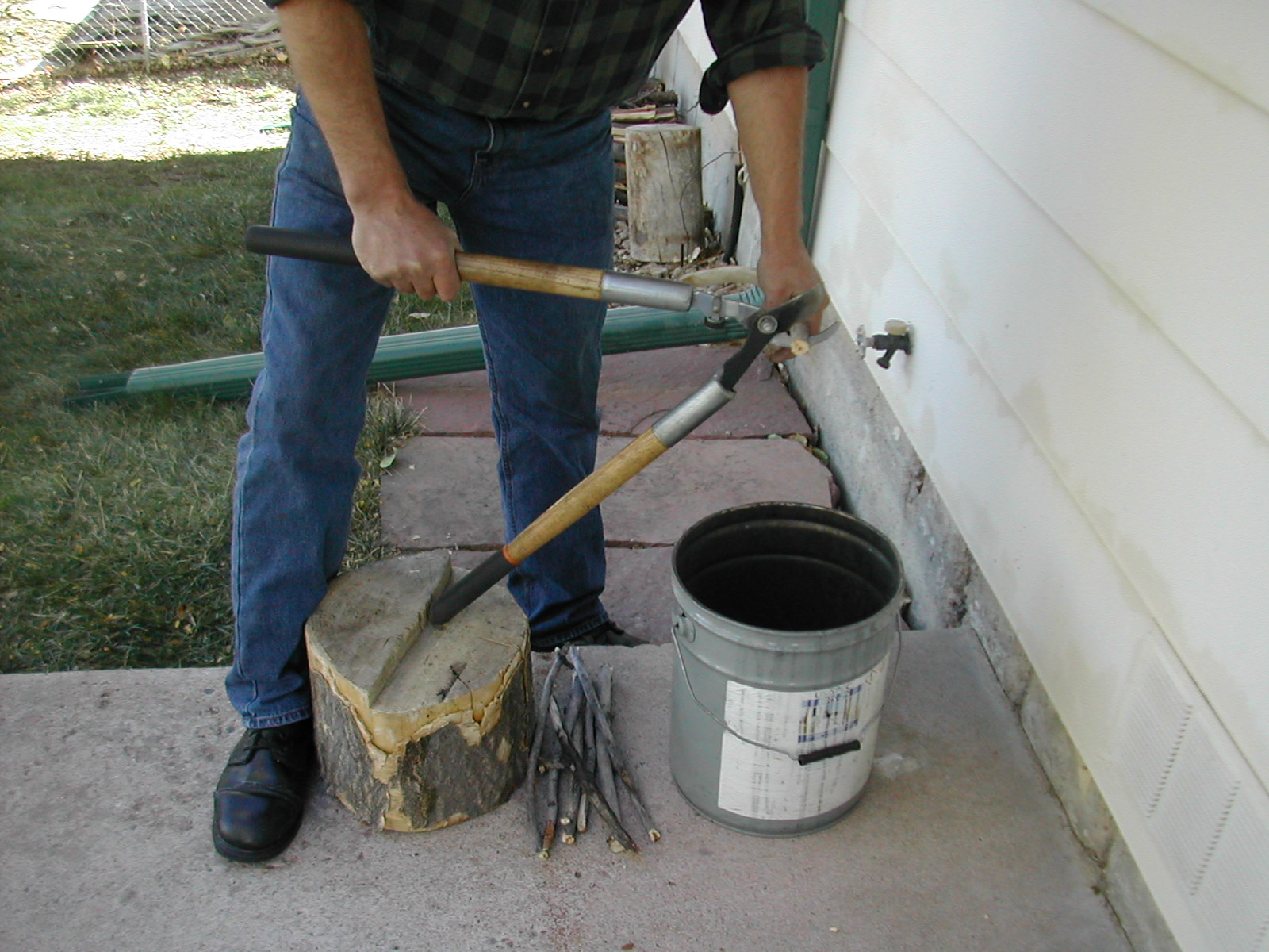

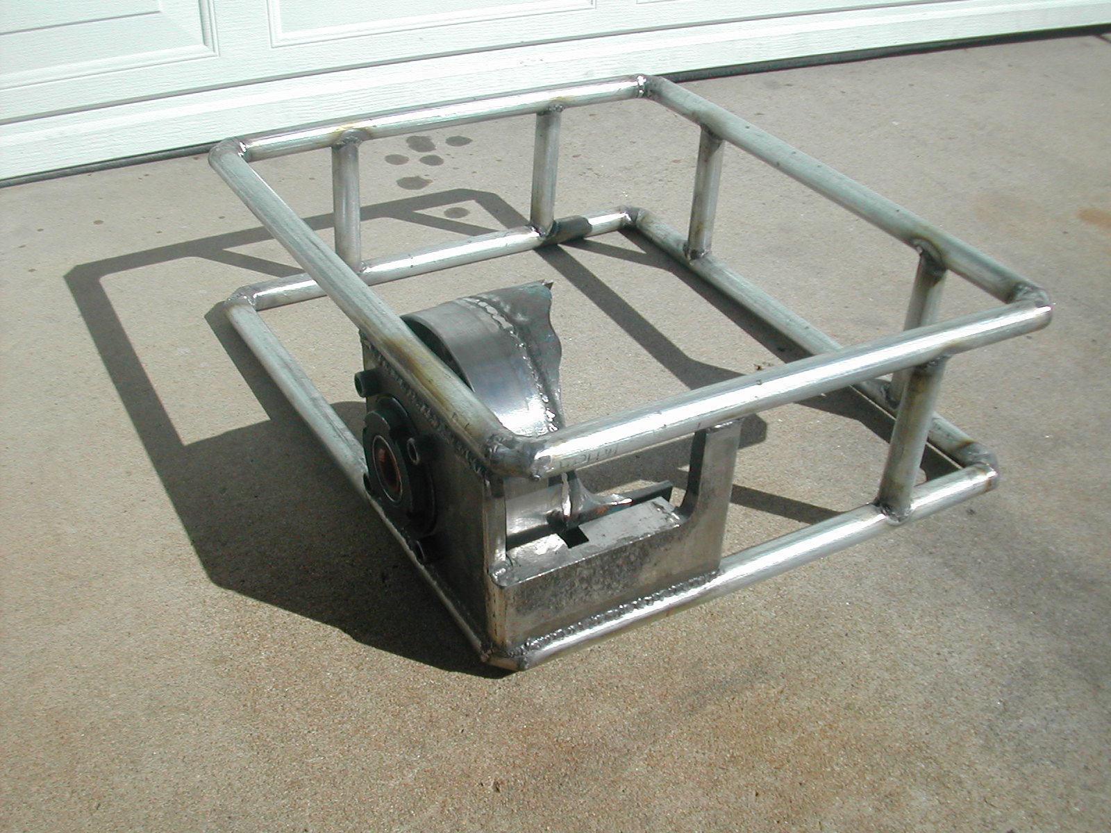

I am making a chunker. This is the most difficult step.
I have learned to wrap this piece of metal around. This little bit of insulation makes it burn much faster. I am still learning.
I learned to make small TLUDs to make apple wood charcoal for the grill.
thanks rindert for explanations…with the chunker it will be more quickly done, nice work, please show us when is finished and works!!
best wishes giorgio
PS instead of the hand-cut scissors, i got an idea in the moment, something what moves the cutter by foot- more power or more pieces cutting together instead of one…the leg pushes down the cutting tool, a spring lifts it up again… a chunker of course is more effective…

I thought about that. It would be simple. But really I want something like Wayne’s. I think he estimated somewhere that his chunker could work with about 5 horse power. This is impossible for my legs to do. I think I can make a chunker that weighs about 120 pounds and uses a 6.5 horsepower engine.
thanks for additional pictures, now i understand better… you fill the container with wood chips, you light it on top -tlud- than the fire burns down in the center taking air in the beginning from top and later from the grate. the down-moving fire creates his own chimney where it burns the chips while the parts beside gets charred from the heat…i think it is partly understöchiometric burning so the pyrolysis gas, what is not burned in the center-fire goes up and burns at the afterburner. in this way is no smoke !! very clever so complicated neighbours can recognize nothing!!!
a system with a lot of advantages…also the needed wood , i will say if is cutted-chipped when is fresh requires less power to make it-- and than drying outside in summer…short pieces dry very quick…
