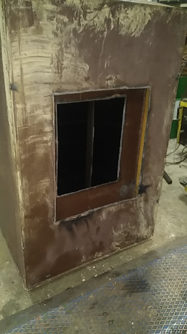

Perhaps you know this but as I am told from people working with insulation, when superwool has been exposed to several hundred degrees C the small fibres in the dust, if you touch it, is almost like asbestos. I guess the fibres break off in microscopic parts.
But the properties are impressive, we tried once to put a one inch thick piece on a 500c superheated steampipe and then we measured the temperature after 20min on top of the insulation and it was just over 70c.
I can’t vouch for that the dust is dangerous as asbestos, I have not done the research but it was enough for me to take a step back and not use it where ever I please, ffp3 filter neccessary.
In my retort the insulation is protected with a sheetmetal cover so i dont know how it behaves. According to the manufacturer superwool is not harmful.
I can vouch for that it becomes very dusty so a breathing filter is recommended if you ever take it apart but to me it seems very unlikely that they are allowed to sell anything that would behave like asbestos.
I believe you are right and that insulationworker I talked to probably likes to exaggerate…

Hi Johan, about insulation, i use rockwool for stove-pipes, 1100kr for a roll, 1×10meter.
I need to line it with some sheet metal to save it from the birds, picking it for nest material.
Only health issues i’ve noticed is some spontaneous nose bleed (flooding) when breathing the dust.
I think you don’t need a shut-off valve for the gasses if you pipe them from the chamber to the fireplace, it would act as lock itself.
If you only have holes in the bottom there could be draft enough to keep smouldering.
