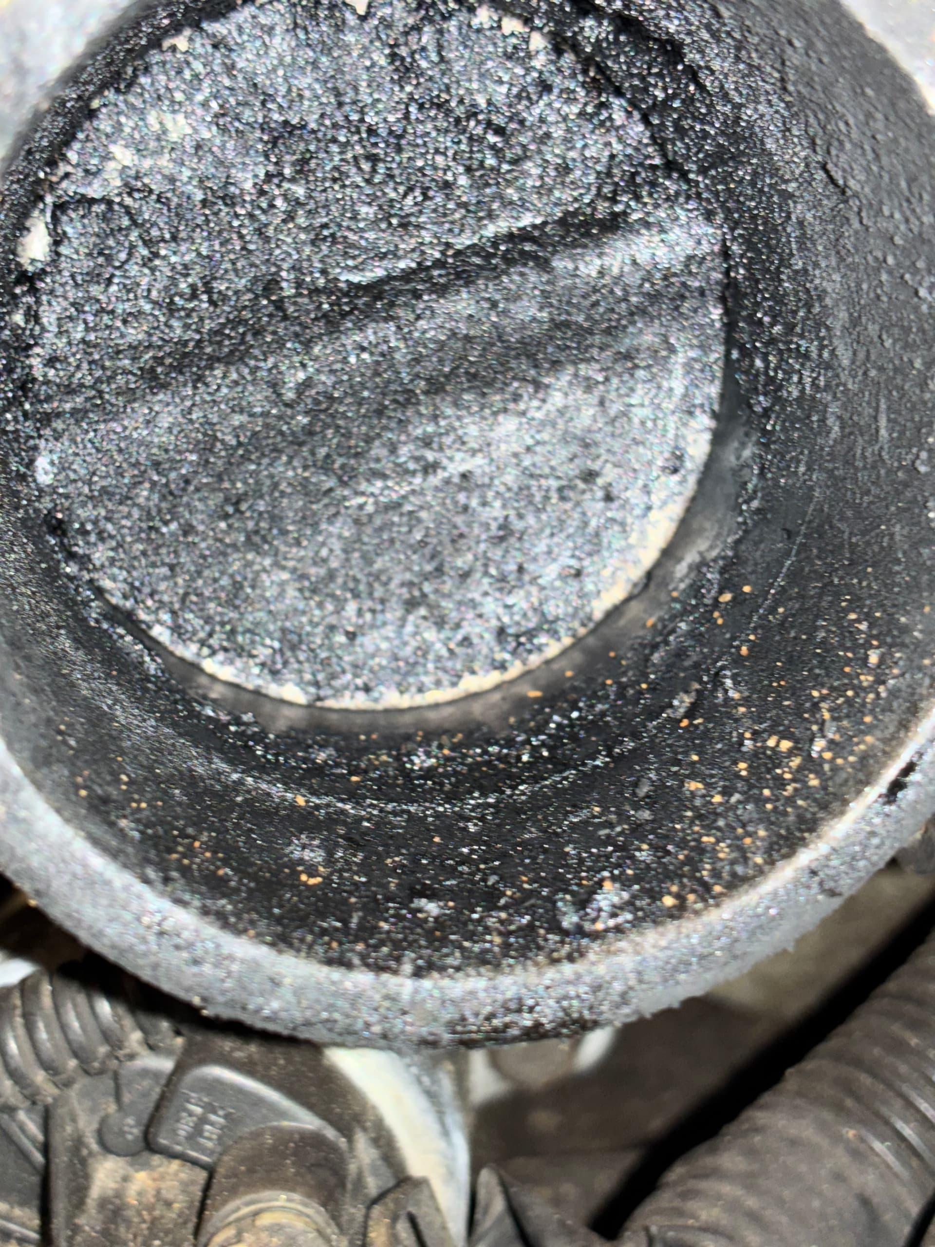

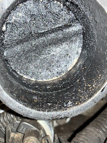

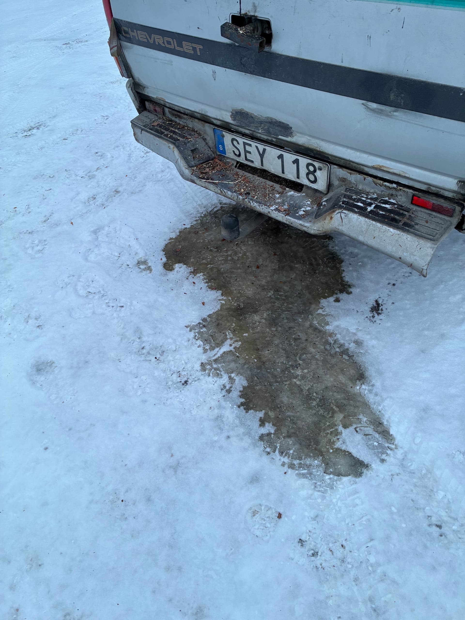

Looked in the intake and it looked like this, so I took out the filter and checked what was wrong, the filter had slid down the inner tube and there was a bump on the tube that allowed the soot to crawl past, lifted the filter up and tightened the clamp, hopefully it works better now.

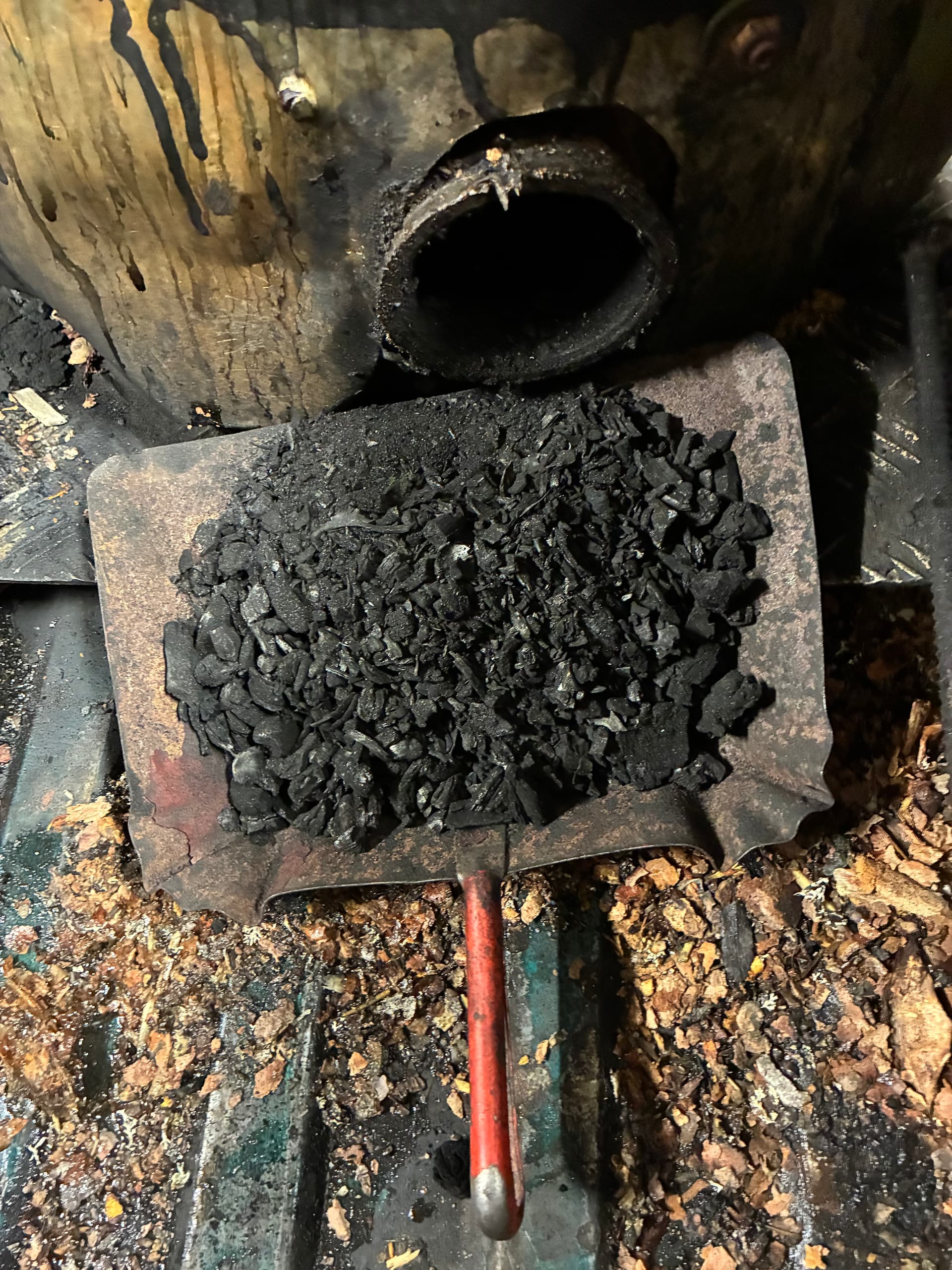

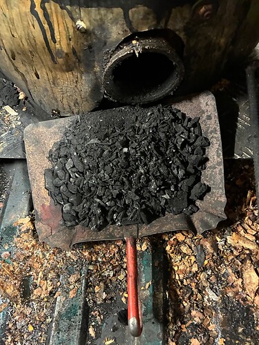

I got about 30 liters of charcoal and soot out and have driven about 400 km, would you make a tighter grate that you can move back and forth
, or would you continue as is?
Would the gas be better with a tighter grate?

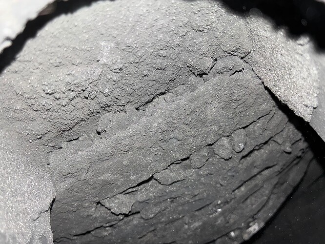

Took some pictures through the ashtray, what you see is the grate from below.
I think thats a lot of char, a tighter grate would do some good, but! Not too tight, it will give you “constipation problems” instead.
Nothing wrong with passing much char, but it needs much heat for the charring process, which could make it a little more sensitive to moisture in wood.
If it’s not to much work cleaning and put the char back in the fuel bin, drive happy as is?
Jan, I would keep it as is. In the Volvo gasifier I slip almost about the same amount. Say a 10 liter bucket every 150 km. Two years ago I cut the gasifier apart to look for leaks and I took the oppertunity to lower the grate just a little (~5mm) because I was a constipated from time to time. Ever since I haven’t used the grate shaker at all. We may waste 5-10% of the fuel, but it doesn’t matter, does it? You could always dump the char back in with the chunks if you want.
Edit: Ops, Göran beat me to it :smile:
Thanks for the answers, then I’ll continue as is, I had problems in the beginning with the grid being too tight, as it is now I never need to worry, it works all the time.
That’s how it should be. Closer to perfection often means trouble.
