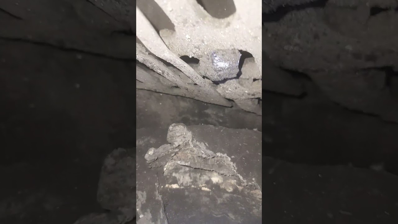

I have to redo the hopper, it has rusted apart. The cone under the throttle has burned apart, I don’t understand what is holding the throttle up now.
Looks like you’ve been running the gasifier pretty hard, Jan. From what I can tell from the video, the restriction cone is burned through and the grate warped. Also, the nozzle tips seem to have taken a beating.
But I guess everything can be reached and fixed from above, right?
Yes, it has looked like that for the last year, I don’t know if it matters?
