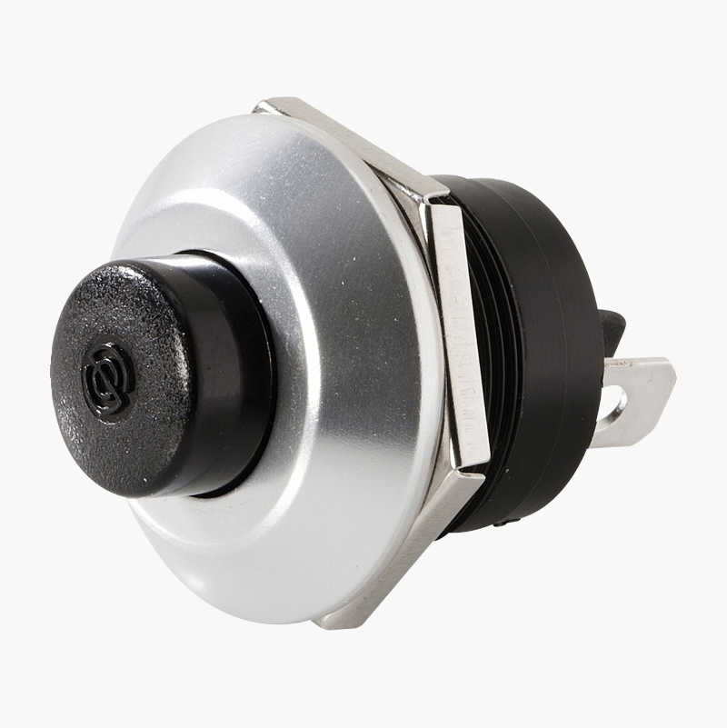

If you going to fix it easy, use a push-button switch as you suggests, make sure to use it through the gearbox safety interlock (park, neutral) It’s ruled by inspection. And keep the key switch, with steering wheel lock, also inspection rule.
And yes, it often works after you cut the circuit, the switch gets “sloppy”, when starting the contact points gets “spot-welded” together, and the spring-return aren’t enough to get them apart/ open again.
Those of you who understand electricity, if the relay doesn’t release, does the starter motor run all the time?
I’ve replaced the starter motor and put in a button between yellow and red at the ignition switch, but it sounds like the motor doesn’t turn off when I release the button.
