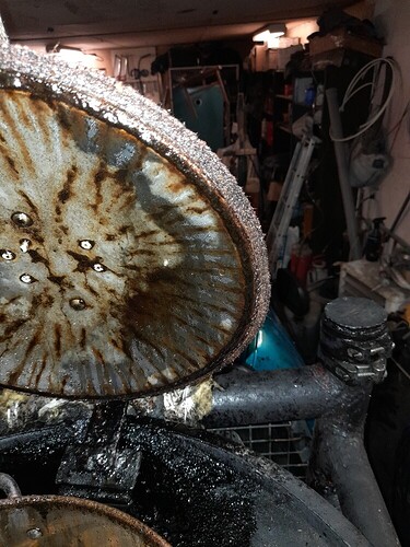

I dubt. Also tar glued to it will probably tear it apart.
Agree. I have found that what works for me is make the lid as small as possible, less surcace on the seal, less places for leaks and better pressure. Second, l always grease the seals so tar doesent stick on.
What kind of grease do you have, I have on copper grease, on mine, but it sticks anyway sometimes.
Thought of buying a canteen like this with a tight lid, what do you think about it?
I used exactly the same at my old Volvo, it hold up surprisingly well, but as said, tar glued it, and if not opening carefully and loosening the rubber with a wooden stick, it teared up.
Think I had to change it every 3 months.
Ok, did you have grease on it?

Yes, but I do not know how hot the lid will be, as long as I drive the car, it is almost never hotter than 70 - 80 degrees c (160F).
No grease, but I should have tried it if i thought of it.
Seems the lid’s never reach higher temps temps than around 100°c , there are always condensate and soft tar, seems to indicate this. Even burning down to low, it seems to hold up well.

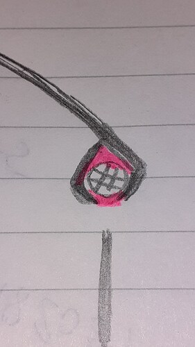

I think the trick is making the groove look like this.
I used stove rope, but I think any soft rope will do.

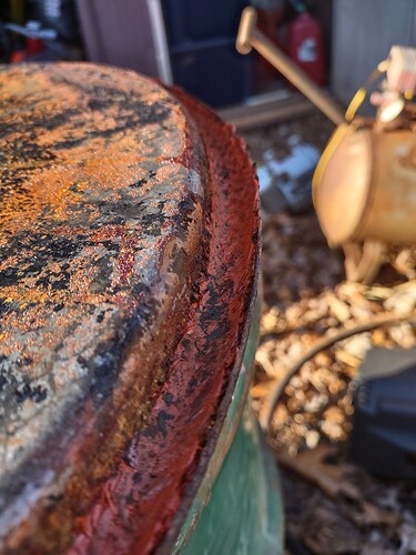

First silicone in the bottom of the groove to glue the rope in place and then silicone on top to make a mating surface. When the silicone cures the rope+silicone will have a large enough diameter not to be able to escape the groove.

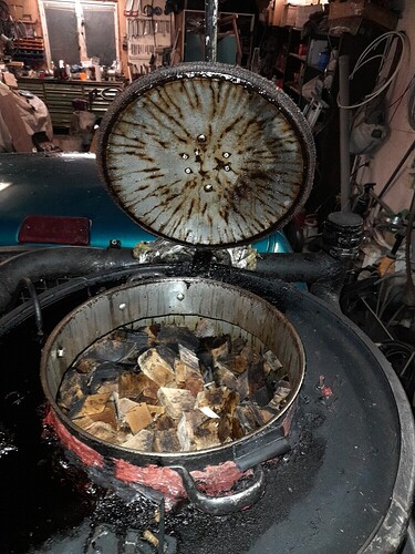

I often forget about grease and have to crowbar the lid open with the poker, but I’ve never had the seal let go of the groove. The seal may leak just a little when tar is cold and stiff, but seals 100% when warmed up.
What I did just recently was take the stove rope and massage the red RTV silicone in a bag like Bobmac has shown. After I got the silicone impregnated to the rope I glued it to the lid and used plastic wrap on the barrel lip and clamped the lid down. Plastic wrap so it doesn’t stick to the barrel as it cures. It made a cupped shape from the rim so I think this improves the seal.
The dirt is from the rim of the barrel being rusty. I haven’t used this particular lid yet but it worked great on my charcoal gasifier.
