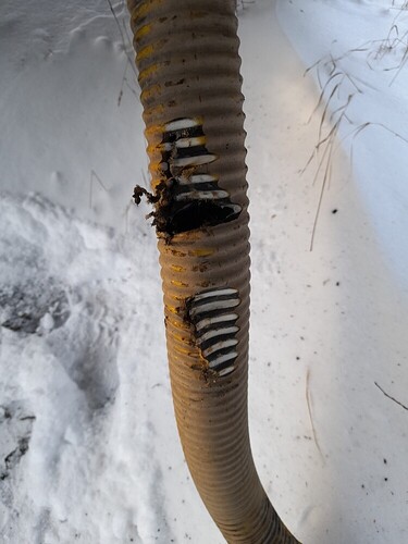

I looked in my pipes and there is almost no soot in them, but I think I found the fault.
I had to run on petrol today, not good.

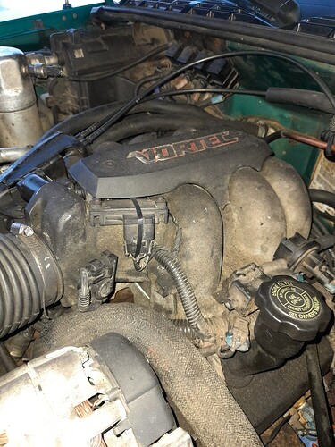

Jan, if you haven’t learned about this yet you can replace the plastic upper intake manifold for a cast iron one found in the 4.3l Mercruiser and Volvo marine engines. Replaces the spider injector with common rail injection as well. You have to use an adjustable fuel pressure regulator to lower injection pressure but I thought I would let you know. Not sure how hard it would be for you to find a kit but I do know that they use the same year generations as the automobile engines. Took me forever to find one for my 2011 but I will look further into replacing my plastic manifold for one of these.
Cody, I have an aluminum intake on my car, but would like a different type of injection, but do not know how it would go at the inspection.
I thought you had the plastic intake.
I have heard if you tune the fuel pressure correctly you can get better fuel economy and power out of the 4.3l with the new intake runner. Maybe it would let you tune down fuel trim to decrease emissions.
