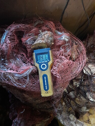

I think the wood is quite wet though, if you look at the smoke it looks quite moist, doesn’t it?
Tested a few pieces in a bag, and some showed quite high values.

Water vapor evaporates guickly out of the smoke, but the smoke will carry away for quite a distance from the hopper and is very brownish and dark in color compared to the white gray moisture in the smoke.

Was the wood in the hopper low or high in the picture? The reason I ask is that is what my smoke looks like when I open my hopper and it is almost empty or very low on wood. My wood is alround 10 % mosture content maybe less.

However, I see that the heat in the filter is increasing, I think it’s because the wood is wet.
