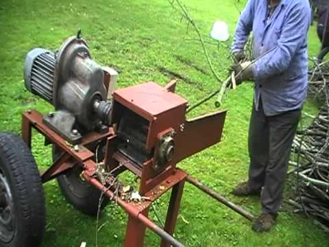

You will notice that green wood will chunk much easier than dry and you will even see water squirting from the cut. Sometime the water will even hit me in the face .
Yes I think the wood will dry quicker being chucked vs sawed .
I hate seeing You Tubes of you guys chunking wood in your shirt sleeves. I switched from my winter coat to a winter jacket today. That is still heavier than a spring jacket and no where near short sleeves. The snow is starting to melt so maybe I can find my way out to the shop soon. Of course after the snow melts we have the mud to contend with.
What is the thickness of the steel you are using for your cutting blades??. The cutting edge on mine rolled over. I straightened it out and tried to beef it up with some weld but it has rolled again .
today was nice but not tee shirt nice i did make a video but have not got it loaded on my computer yet.
Tom my cutter is 1/4" thick and before i sharpened it i welded 4 passes of hard facing on the edge and ground it so it is even on both sides . i’m keeping my eye out for thicker pipe.

Try sign companies that work on illuminated signs for used pipe from old signs they remove. Dan
thinking about adding one to the top of the chunker for the small end of wood being processed
