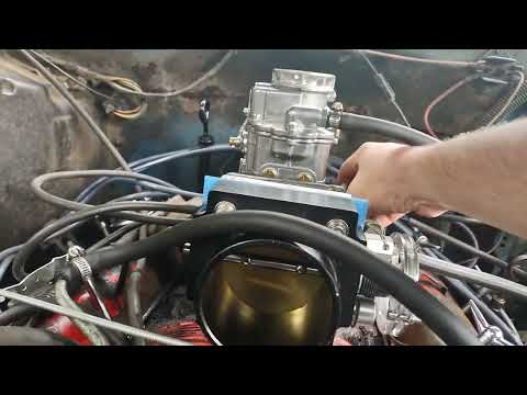

Okay so take two on the intake adapter.
I tried soldering, I forgot I’m bad at soldering and my map gas torch isn’t hot enough for this big of a hunk of steel so I just rewelded all my leaky welds. I really do prefer flux core welding even if it’s dirty.
Also got the Woodgas throttle adapter sealed up with high temp epoxy and some regular JB weld on the inside. A little insurance for a puffback.
While this is drying and curing I’m going to add my O2 sensor bung to the Y pipe and change my manifolds.
Got the shiny new manifolds in. Got my O2 sensor bung put on. This is the Glowshift kit that comes with exhaust gasket material. I tightened that clamp all the way down, she ain’t going nowheres. Nice upwards angle to keep the sensor away from any moisture on startups. Decent distance away to keep from frying the sensor or giving a false reading.

Got everything sealed up and my vacuum lines connected. She runs like a champ at 1.5 PSI of regulated fuel pressure. I bet in an emergency I could ratchet strap a boat tank to the roof and gravity feed this thing. Still need to get throttle cables hooked up. This engine sucks so hard on this little carb I don’t even need a choke, but maybe that speaks more for how rich it’s likely running right now.
Nice work ![]()
A small carb is a good thing on a woodgas truck, small leaks don’t disturb the idle as much then ![]()
I leaned towards this small of a carb because it’s just a hair smaller than the front barrels on my 60s era Quadrajet. Also there’s a lot of Hotrod aftermarket parts I can get like an adjustable main jet. I’ll likely buy the adjustable jets and pair them with the largest jets a Holley 94 can take. Maybe it’ll run ethanol fuel after that in a pinch?
I love how simple this carburetor is, I can see why Henry Ford wanted to get away from the Stromberg 97s and had his own version made that shared the flange profile.
I think a more modern version of this would be a Holley 2100 but they’re a little chunkier.
I was
this close to using a CV40mm motorcycle carburetor but I think the float bowl was too small.
