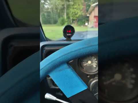

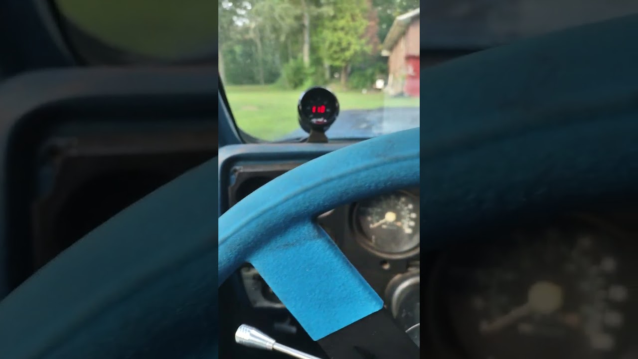

Got the wideband put in. Truck likes to idle at a roughly 13-1 ratio. When I’m actually driving it’s running in the low 14s. I’ll take that all day. What’s odd is I’m getting the random pops that are known for a lean condition. I’m using a genuine Bosch sensor not the generic one included in the kit. I have my sensor at the end of the Y pipe so that’s roughly 20 or so inches away from the end of the manifolds.
I’ll make a video real quick driving from my Dad’s house. I tried leaning out the needles and advancing the timing but I think I started hearing a little knock when I put it in gear.
I’m reading that 12:1 isn’t too rich for the sensor and shouldn’t damage it. I might just enrich the mixture some more and deal with it. I’m glad the stock jets are cruising at stoich though.
The ideal mixture on the older stuff was always 14.7-1
It just doesn’t seem to idle smooth when I get it there.
When I’m at speed it’s in that range no problem.
Maybe I need to clean my spark plugs, could be fouled and isn’t giving a good spark at stoich. They’re only a year old so I shouldn’t need to replace them. I have a new module in the HEI and new plug wires as well.
