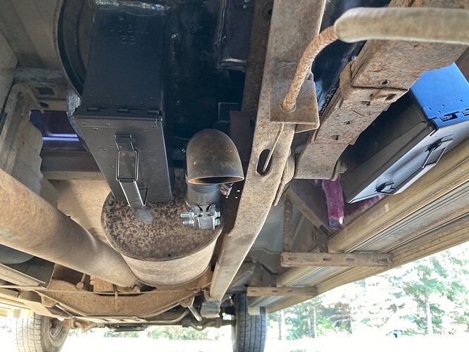

That is what I did Cody. I was too lazy to snake the tail pipe to the back where it was originally.
If I would do it again I think I would place the turndown in a different place instead of under the gasifier. It may be adding extra heat to the lower drum.
