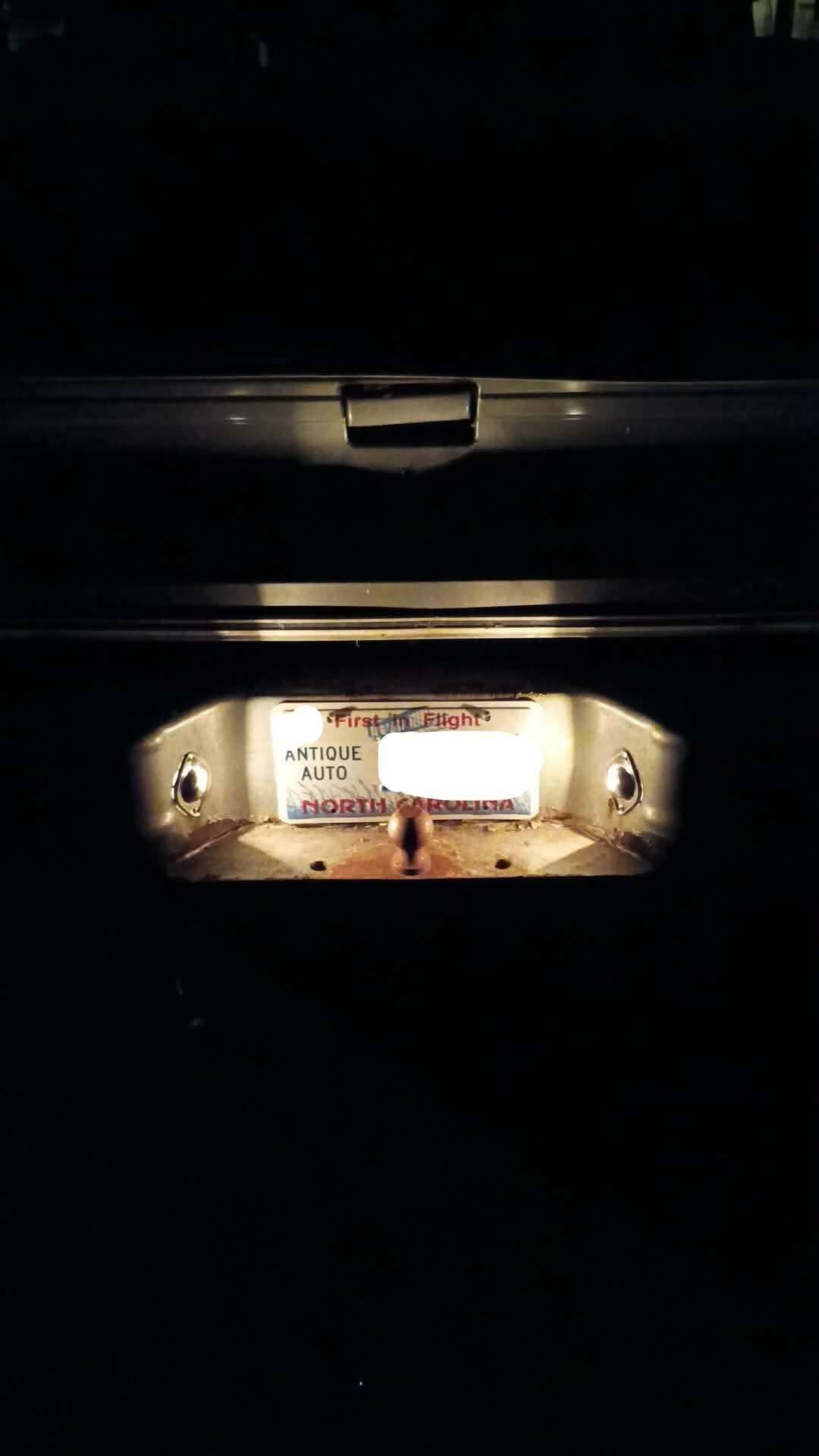

Also got my license plate lights in and wired up. They shine nice and bright.
Antique plates on a 1976 truck is making me feel really old. I know I am but I don’t like to be reminded. Maybe I should try and do a push up.
Tom if it makes you feel any better, I could get an Antique Plate for my 1996 Cavalier as of this year. NC considers any vehicle 30 and up as “Antique”.
