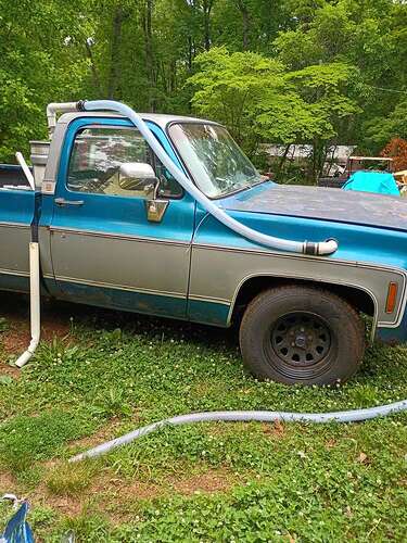

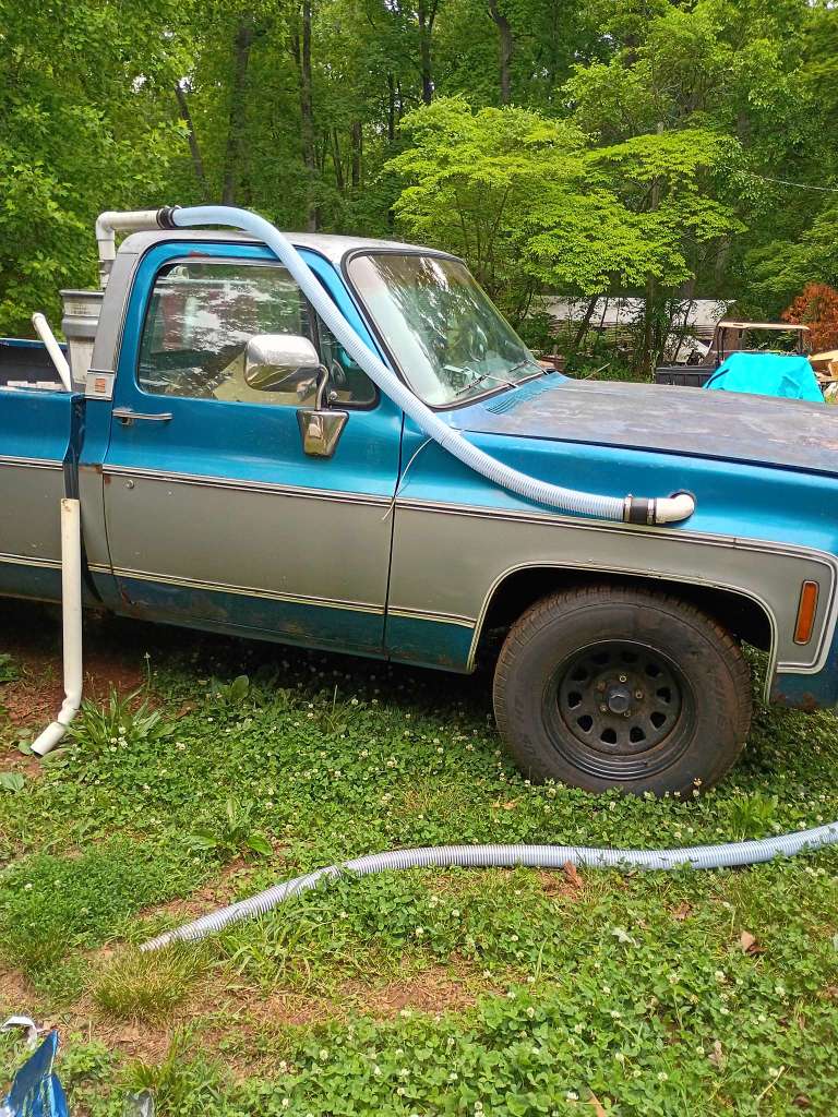

What would be the minimum diameter fuel line if it were run up the A pillar like on Cody’s truck? I know that the preferred method is to keep it concealed under the vehicle but this way is certainly easier.
I’m using 2" spa hose and 2" PVC at the moment. I know @SouthernYankee has done the same with his 350 except he routed under the truck. I plan to try to run two fuel lines of 2.25" stainless exhaust pipe down both A pillars when it’s on raw wood, unless I find just one is fine then the other will be for fresh air. My designs are always in a state of flux.

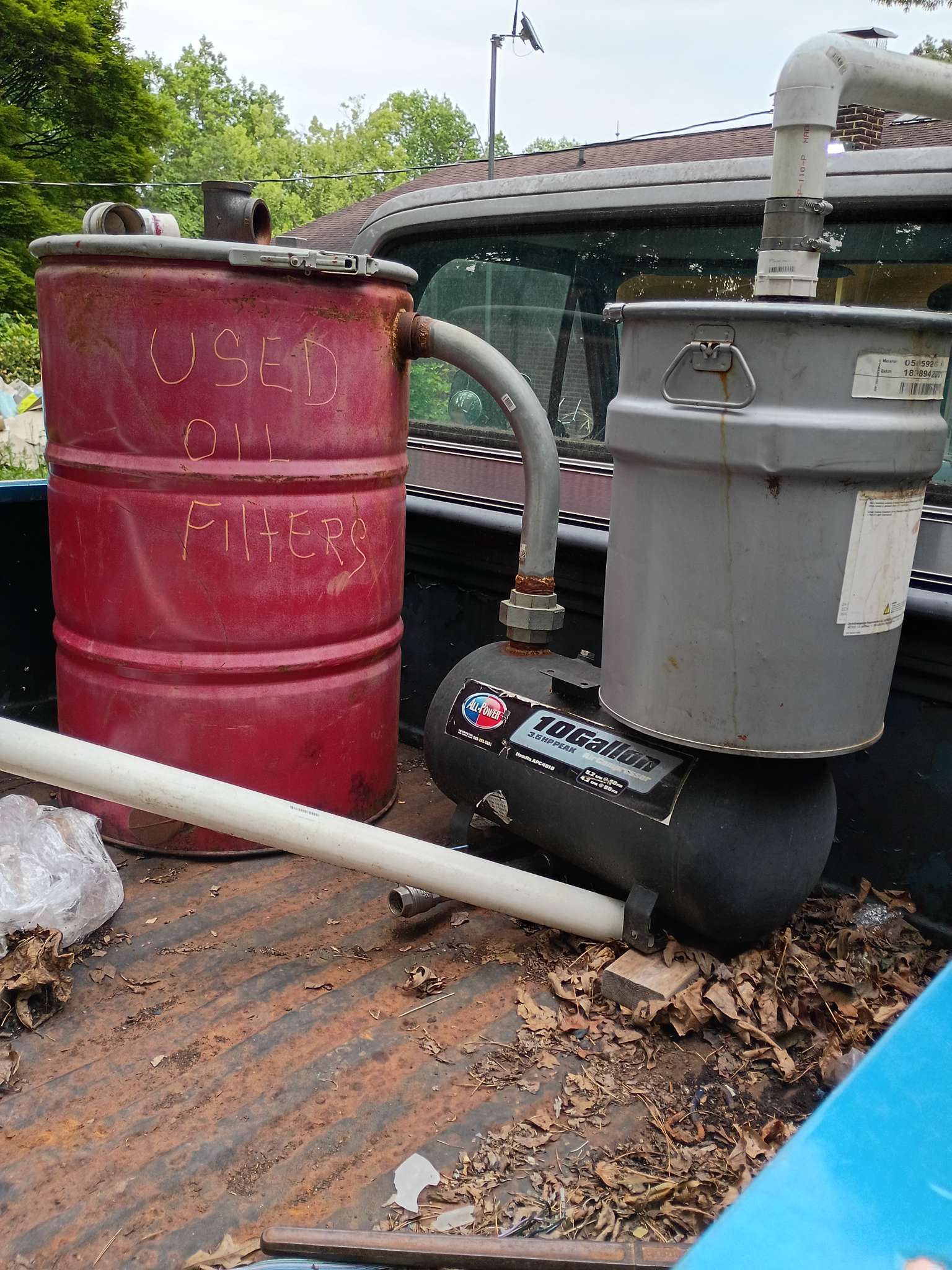

I originally made this charcoal gasifier for the 4.3 but it seems to run the 350 decently enough. I should have gone for 3" pipe coming out the gasifier into the dropbox and filter but I’d hate to delay this thing any further.
I’m getting my gasoline cutoff solenoid up and working, added my water drip and I’m trying to hunt for a filter pod to fit on my fresh air. Also need to find something to fit in the column shifter to act as my lever. I’ve somehow lost the old one between a bunch of “decluttering” sessions.
Drove around on a nearby country highway. She got up to 65 once or twice when I wasn’t paying attention. Had one issue during the drive, I had a piece of shrink wrap plastic that got sucked into the gasifier intake and it was smothering the gasifier.
The fuel cutoff solenoid worked great and I have gasoline in a matter of seconds, so I was able to restart the engine while rolling on the road.
This gasifier gets HOT. I may want to get the cooling rail done just for this thing. I was nowhere near empty and my exit pipe was too hot to touch. Maybe a half a second touch. I don’t think I can rely on a thermometer to know when I’m running empty but it could let me know when I get too hot for the plastic fittings after the filter. I do know that this engine is a hungry hungry beast. I went down about 6" of fuel in maybe 10 miles and a little idling.

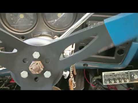

Also my AFR meter died on me, and I’m not sure what happened. I’ll wait til everything is cooled off before I go messing with it.
Here’s some videos.

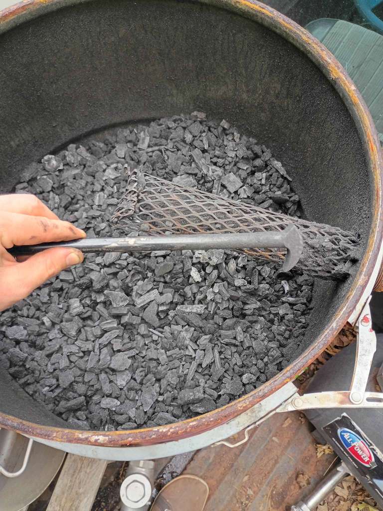

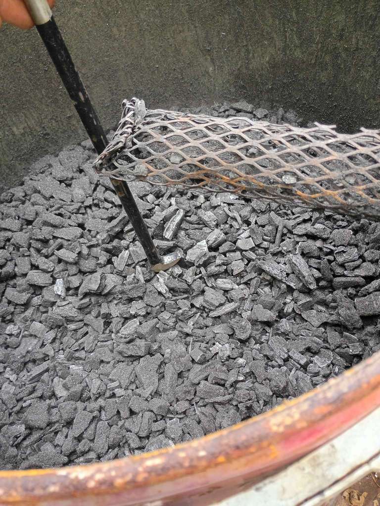

Here’s how much charcoal I consumed today just driving around. I didn’t keep track of my mileage or I’d be able to know a little more, but when I started I was at the exit pipe.

And yes I’m using a wide band gauge with a Bosch sensor. I think the ground wire for the gauge got messed up during the drive. It somehow managed to get wrapped around the steering column in the engine compartment, I hope I didn’t internally break the wire.
Edit: I definitely broke the ground wire. Got it fixed now. I ran some 12ga wire into the cab right off the battery and put in an additional fuse box that will serve for things like my CB radio and the blowers and gauges.

Gosh that mileage is abysmal. Rounding up from 56.78 liters to 57, that means I likely used up 14.195 kilograms of charcoal. So in the course of 20 miles I used up 1.5 pounds of charcoal for every mile traveled on that trip, or 0.44kg/km.
By the time I consume that much charcoal my temps are already at 130°F, so I’d need to add cooling rails to make that worth using the rest of the charcoal. I’m glad this truck will eventually be a raw wood consumer.
