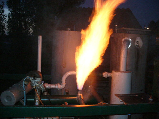

Photos of a wood gasifier present in India, it uses the same system to the gas cogepel 1, a bike.
wood gasifier

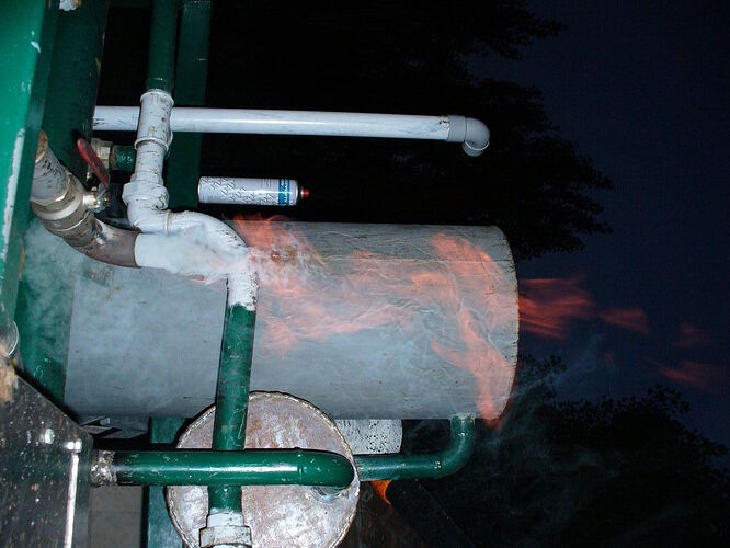

fter adding a filter piece of latex mattresses on recovery beds, I took pictures, but the wane of the camera was too powerful, and we do not see very well the blue flame.

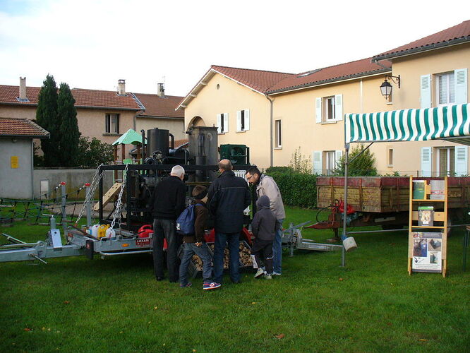

This weekend demonstration Aveizes near lyon 69 gathering old taco, discovering the wood gasifier CHP usual electricity consumption and heat. As we see from the photo, every generation confused …
Very nice car .. Mathis
Very nice to see three generations of interest!

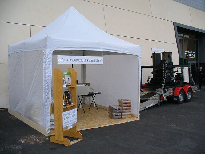

The five, six and seven of December, we living in Monpellier exposed to renewable energy, we were the only exhibitor to submit a gazoène cogeneration, but the public is not only wrong, but times cheaper than wind pholtaïque and panels, with the gasifier should not wait for the wind and the sun, the main concern of the public was that the biomass resource falls into the hands of large groups.

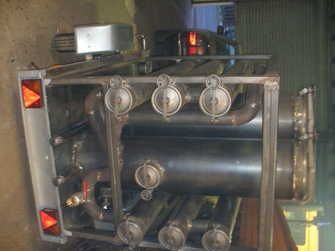

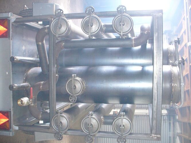

a picture of the rear view trailer gazo closer and dolly with good collar for a store important fuel.

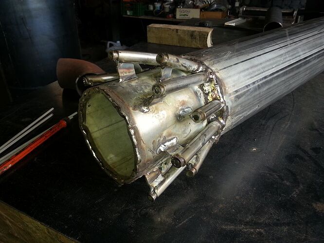

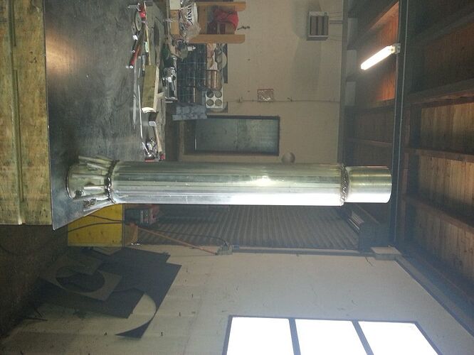

Off of the Ariane rocket, riddle, where is this piece on my gasifier?
François Pal
Looks like the center charcoal hopper and nozzles for a Brandt gasifier to me.

Brandt gazifier on cogepel 2
