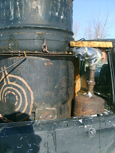

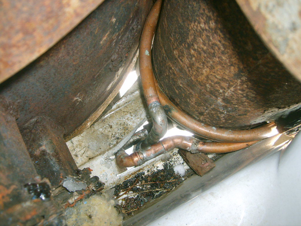

This seems to be One Cold Winter. And I haven’t seen (just ask my wife how well I look) any discussion about draining that tar out of the condensate tank in ten or twenty below zero weather. This winter I have added a copper coil around said tank. The coil is filled with hot water circulating from the engine. I have drained hot, steaming tar at ten below, and no doubt it will work at -20. In fact, it drains nicely even with the engine running on woodgas. So I suppose the deed could be done while sitting the cab with the heater running. Yes, the heater still works with the extra length (20+ feet) of run (another bennefit of the 318). The tank heater circuit "T"s off the heater hoses. I have peeled away the insulation from the tank for the photo.
Also, I have tried putting a blanket around the hopper and have subsequently removed it. The best remedy for winter-time bridging seems to be those bumps that Mike L. is keeping a lookout for.

Actualy, I got the inspiration from Woody last winter. I thought and thought about how to heat the tank, and then decided that hot water had to be the best since it will not make the condensate boil and go back into the works.
