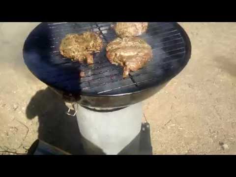

I went to bed last night thinking I was going make lumber for the chicken coop. I woke up this AM and decided to make a rocket stove.
I welded 3 bolts to the top so I can attach a grill to it. The bottom is hinged to let the ash dump out. I plan on mounting it to my deck with some angle iron. Then we can have a way of cooking outside and use all the twigs that are laying around. I brewed a pot of coffee just as fast as on the cook stove with a lot of wind outside.

Okay, I’m sure everyone has seen hundreds of rocket stoves. They work great for boiling water and cooking with a cast iron pan but a grill option is amazing. All the heat with no flare ups. I laid a 4" metal disc on top of the three bolts that secure the grill on so it deflects the heat off to the sides. It also is small enough to allow adequate air flow for the chimney effect. Burgers were done in record time. The meat drippings fall down inside the tube and also feed the fire. The best supper up here yet. Don’t tell my wife.
Looking good, Bill
Bet they tasted even better
You can eat 3 hamburgers all by yourself??
I play pretty hard when it’s nice out. No, I ate two and the third one will be crumbled up in my eggs in the morning.
