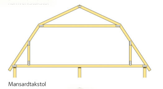

I am a not going to be sad to miss putting up that 45 degree roof! That is going to be scary. What roofing materials are commonly in use over there? One thing that you might look into is a gambrel roof. They were common on barns in America, but you dont see them on houses here very much. JO has probably seen a few, though. They create a lot of space under the rafters, but I have never built one, so I am not really in a position to recommend it exactly. As a practical person, I think roofs should be as simple as possible, but then, I live in a very rainy place, and roof leaks are a drag.
Carl, terminology questions:
-Gypsum vs plaster
-Truss vs rafter
I had to look gambrel up, but I see now what you mean. You’re right, still quite popular here.

Gambrel roofs were evolved around in-barn loose hay mound storing. Practical for that. The shits to hand stack small compacted hay bales up under an old barn gambrel roof!!

Wich is why Gambrel systems are a no go. I have never ever seen such a sistem here. Just in the US and on JOs videos. Agree on it being space economucal thugh!
