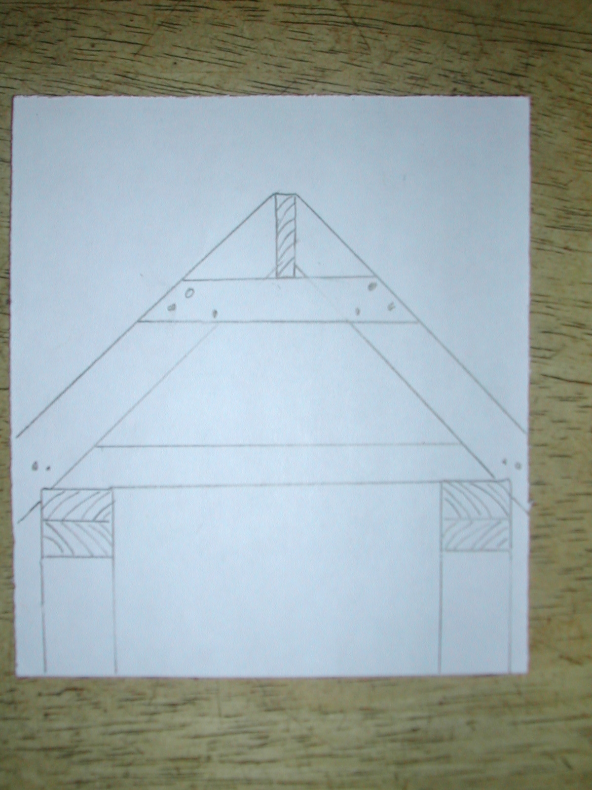

Many houses have been built with a rafter system like your drawing. Usually fastened to a ridge board but that didn’t really affect the structural quality of the roof. If you don’t want to use a ridgeboard then I would lay a couple rows of 2x4 bracing on top of those collar ties. It will stiffen the roof a lot and hold your spacing for your sheathing.

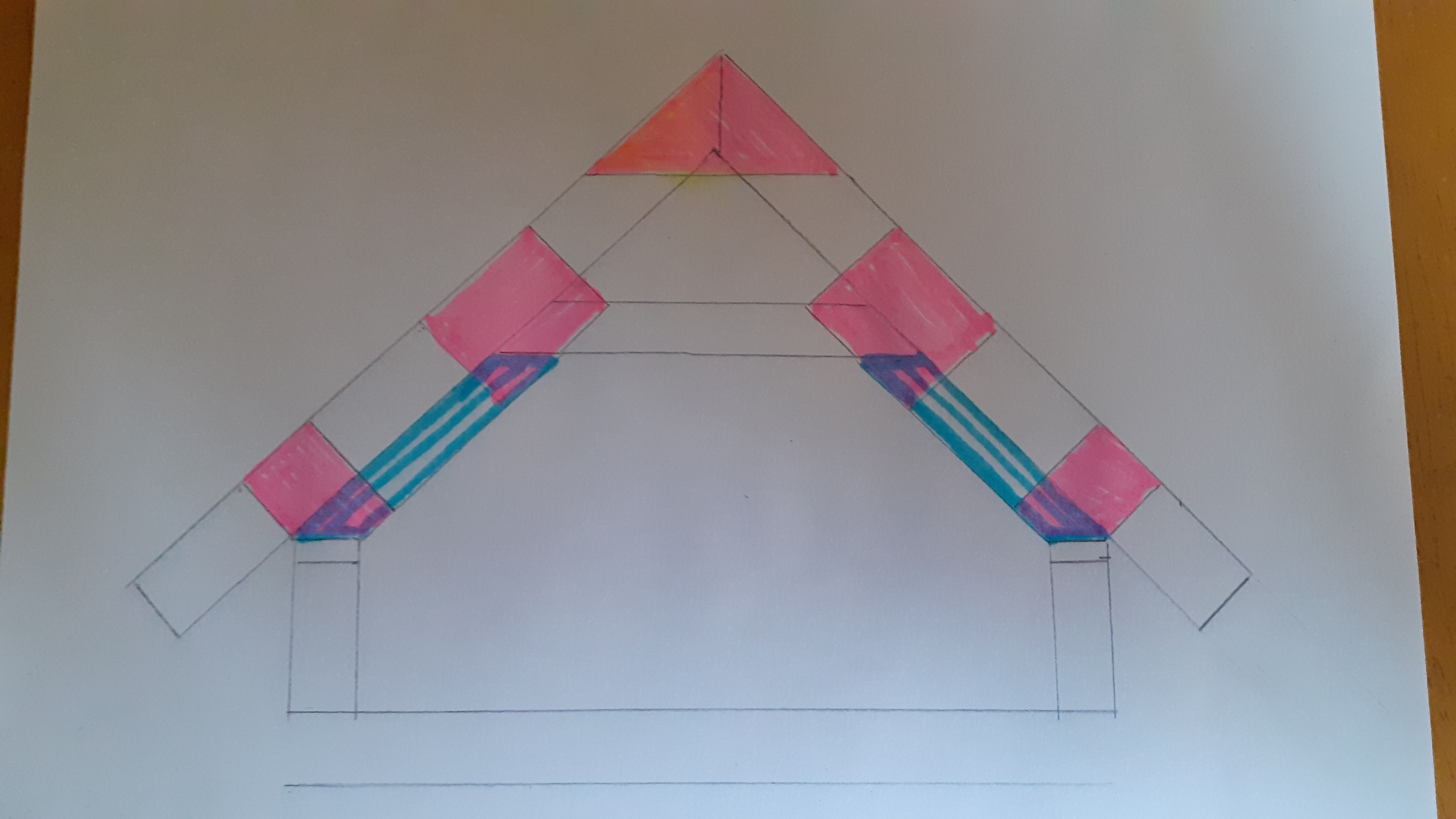

Kristijan, I was working in the woods today but couldn’t stop thinking about your trusses.
If you’re worried about strength you could and an extra member (blue) on each rafter. Also, it would replace the wedge and allow for more insulation. (Pink) is plywood sheets, glued and screwed.

I agree, but Kristijan’s studs extend only 1 meter and I think he is aiming for walking hight in the center.

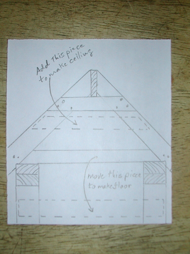

Jan,
Yes, maybe I can see what he wants to do, but also I don’t know everything about his situation. So I propose a very basic system that can be changed a little bit or things added to it. Here is an example.

Kristijan; I said I was going to hold my comments on DOW. Can’t be done. JO’s last paragraph says alot of what I wanted to say. I used trusses on my house and every joint was a butt joint with 3/8 in. plywood glued and nailed on BOTH sides of the joint. The way you have it drawn, you could build those as trusses and set them on the sill plates. Build them on a flat surface on the ground— much more accurate build and with the plywood joints you could slide them up into position on the wall. Cut your “birds mouth” in the rafter so that the width of the sill plate is flat against the rafter. Instead of “toe nailing” the rafters to the sill, I believe they make metal fasteners that can be nailed on and make the roof much stronger. I don’t understand putting OSB on the inside first. Won’t the weather deteriorate the OSB . Put the OSB on the outside and cover it with Tyvex or what ever is available. That will give you more protection in winds and I believe Tyvex acts as a vapor barrier, After I lived in my house for a while I put a steel roof on over the asphalt. The metal roofing is quite expensive, so I used the siding that is sold for “barn” siding. It is the same gauge metal and as far as I could tell, they are both treated the same when it comes to painting. The metal materials that have the shape of “Spanish tile” and other patterns are out of sight price wise. TomC

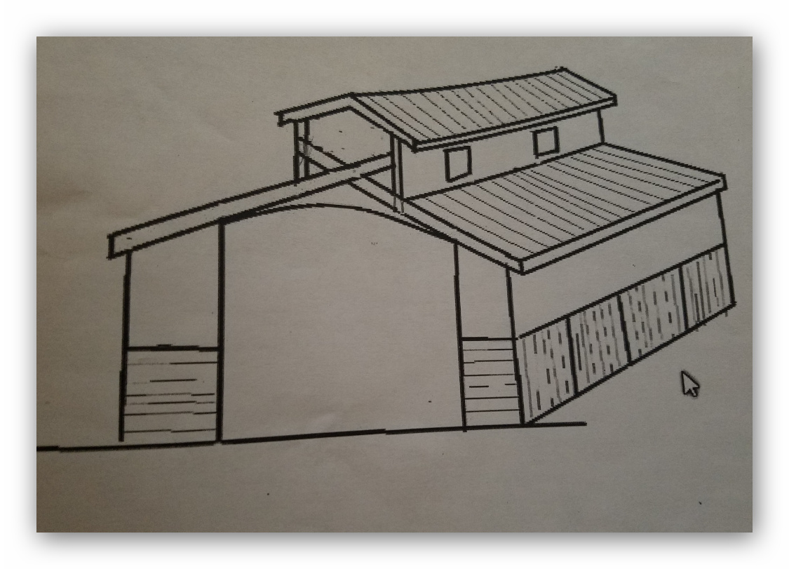

Here is a drawing of a shed I might build that allows a full height ceiling inside.
Don, that is very interesting. I don’t think I’ve ever seen anything like it.
Several advantages. Apart from full ceiling height, you could cover the walls with storing shelfs and still have plenty of sunlight. I like it.
