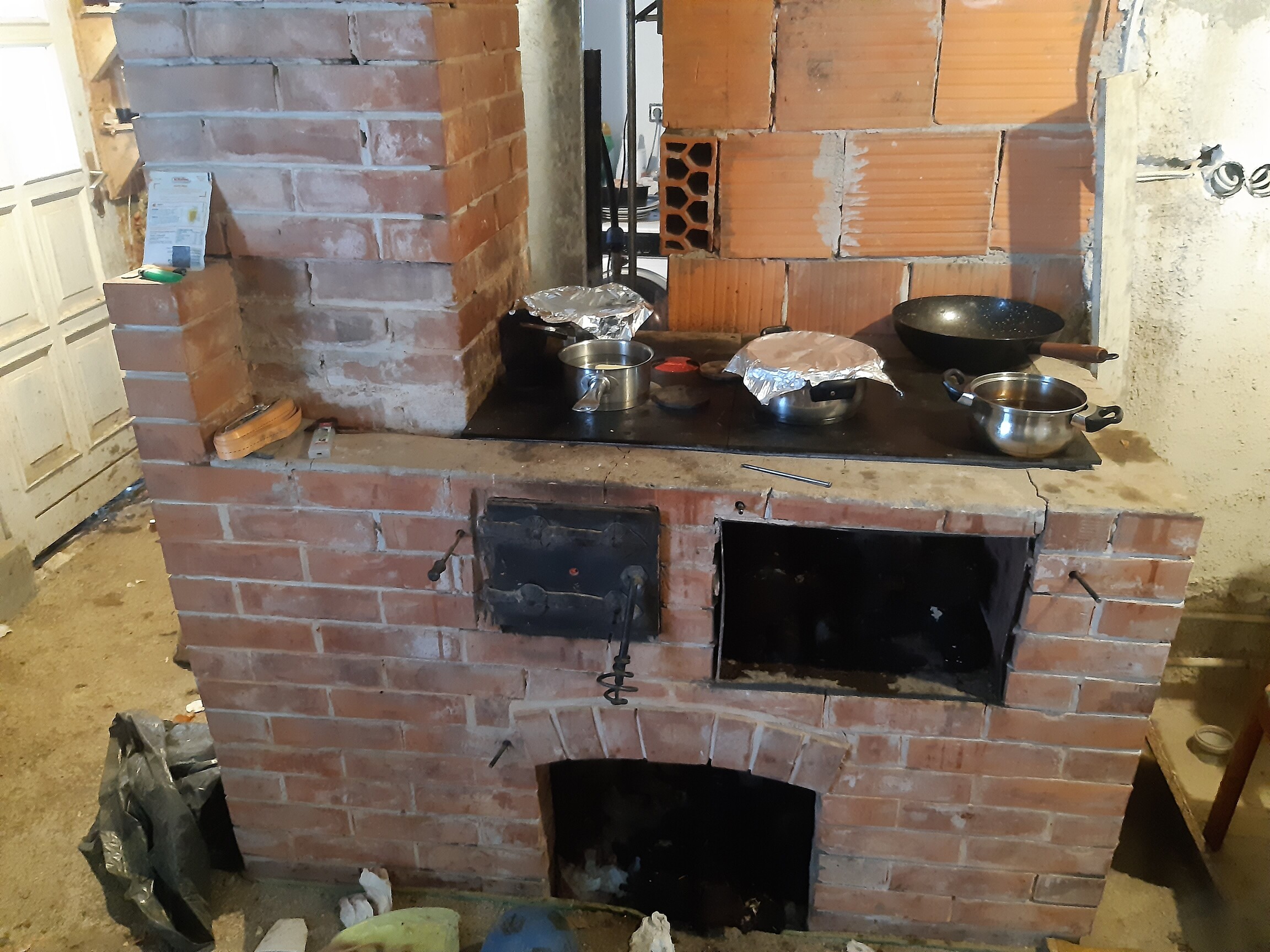

this is the hearth of the house, the stove. It is a steel hearthed brick layed design for thermoacumulation. It allso doubles as a water heater.
Fire has 4 options to go to when it comes from the combustion area.
First, under the whole steel plate for when lots of cooking is planed.
Second, the whole plate and around the oven. For baking.
Third, in a flue center water vessel, for heating water.
Fourth, trugh a isolated steel pipe chimney in a brick chimney, where only about 1x2feet of the plate are heated and nothing else. All heat is dumped here or evacuated out. Thats for summer cooking when exeess heat is unwanted.
Every combination of those 3 is possible, by use of hand operated levers.

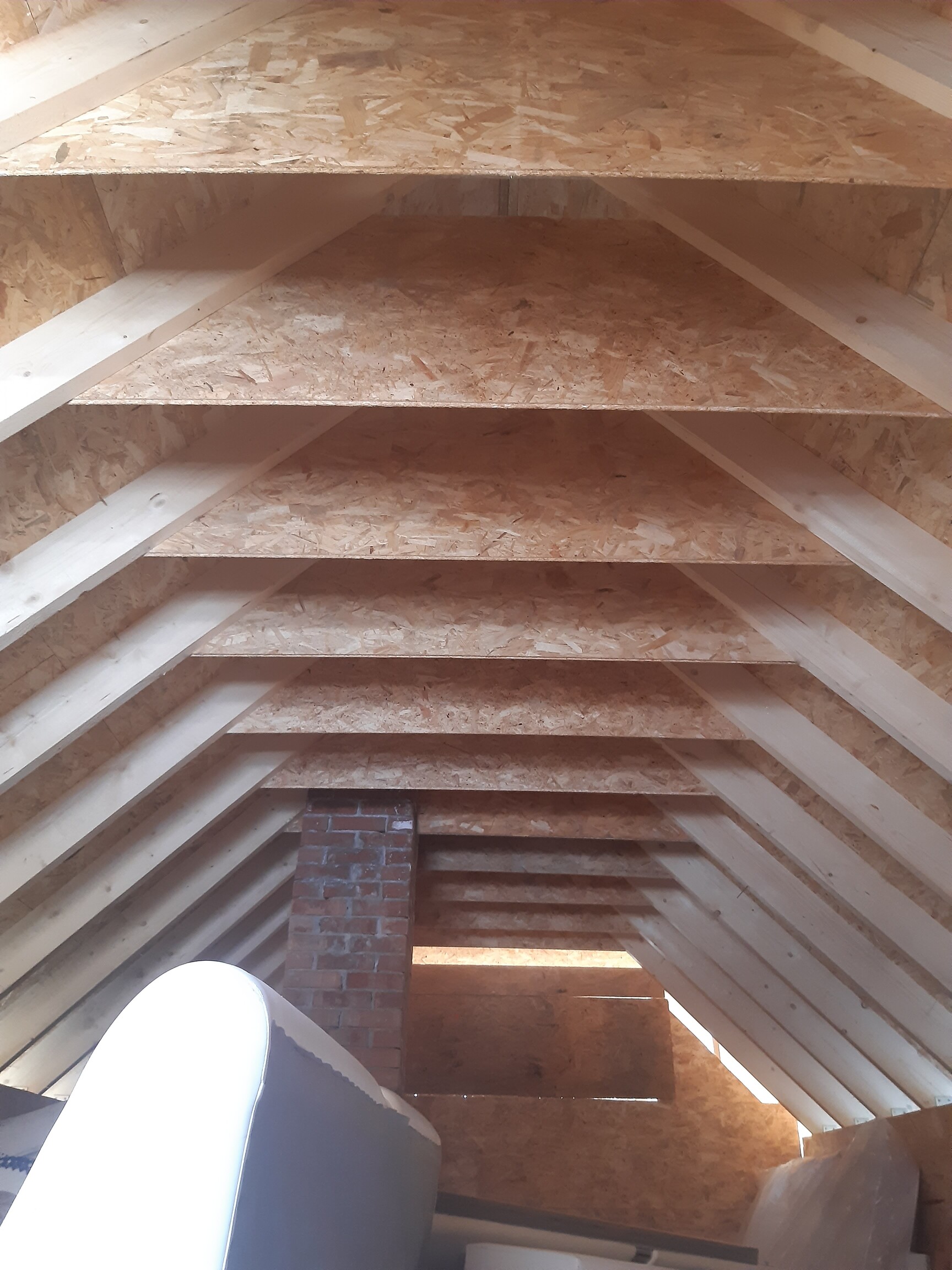

This is the rafter design l went with. So far l am pleased with stability!
The first floor is plastered but the top floor will be all wood.

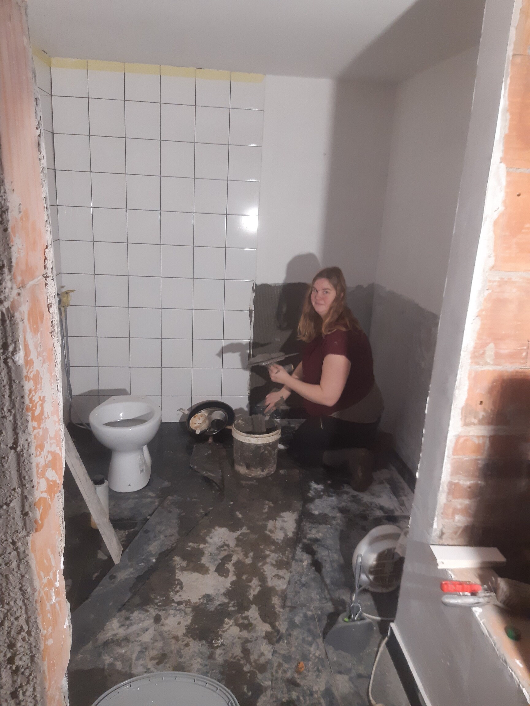

Wife designed the bathroom. Tolder she can make it too :sweat_smile:

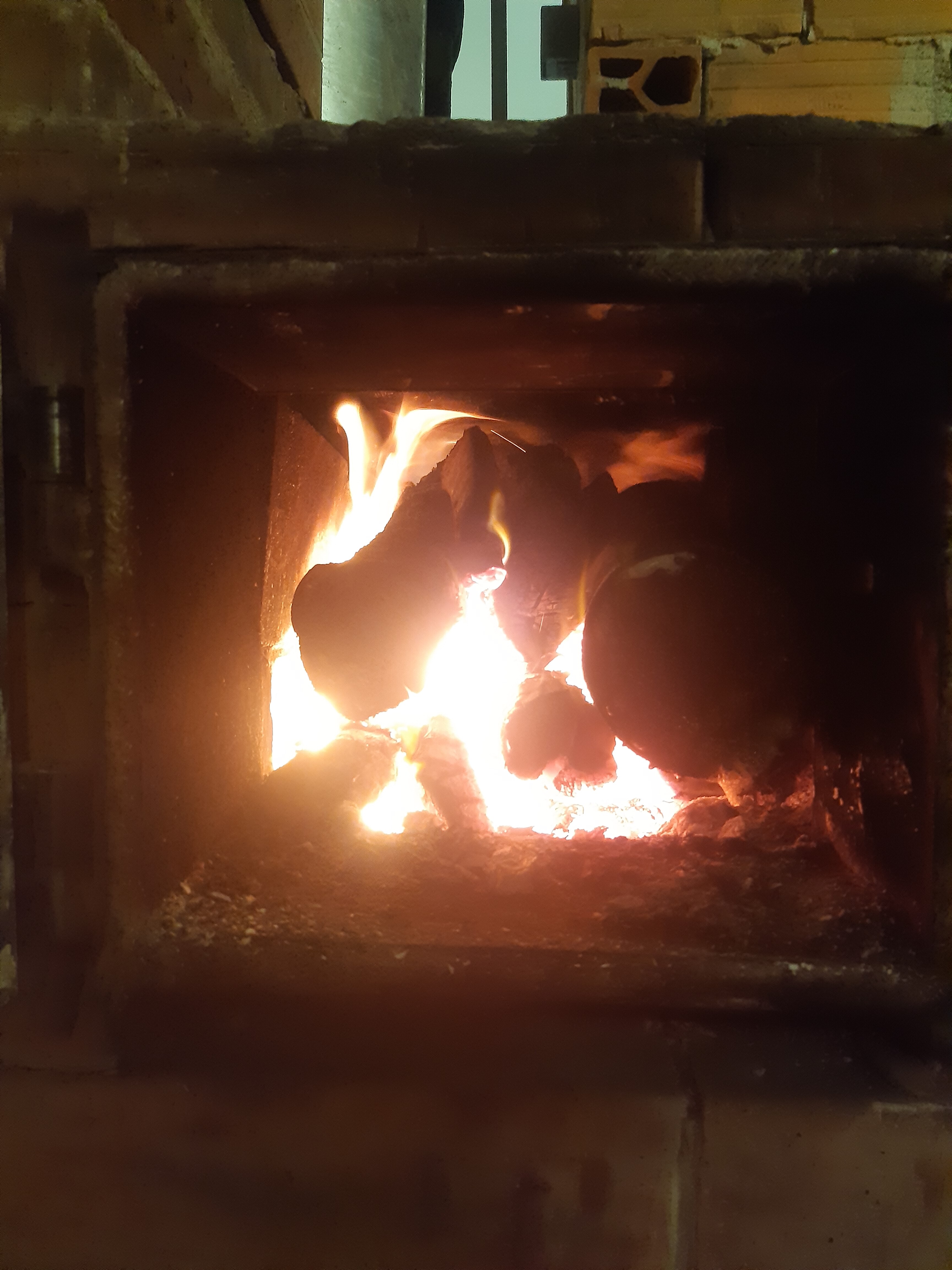

Wood IS the freedom fuel. It will never dissapoint. I say this because this year a chain of events forced me to sell all my prepared firewood (5 cords +) in order to raise money for house building. This lead us with 0 firewood for winter. The all wood l burn now, heating 2 houses, is green wood harvested in our forests fresh weekly and “processed” inside. Took some time to master the art of burning green wood but we did it!
In short. We have 3 drying stations. First, we stack wood next to the stove. This will reduce moisture conciderably over a couple of days.
Second, we stack the wood in the actual oven :smile: dont laugh, sometimes a man got to do what a man got to do. Oven, when opened, never gets hot enaugh you cant touch it inside so no risk of catching fire. Over night, the wood dryes some and preheats.
Then lastly, we load the wood in the fireplace. If cooking is in plan, we load the combustionzone full half a hour before cooking and close the intake air. This will alow the wood to boil off all its water without combusting. Then, when air is opened, the hot dry wood bursts in to flames and you got a hot flame to cook with.
Its certainly not ideal but the sistem gets os and our stomacs warm and happy :wink:

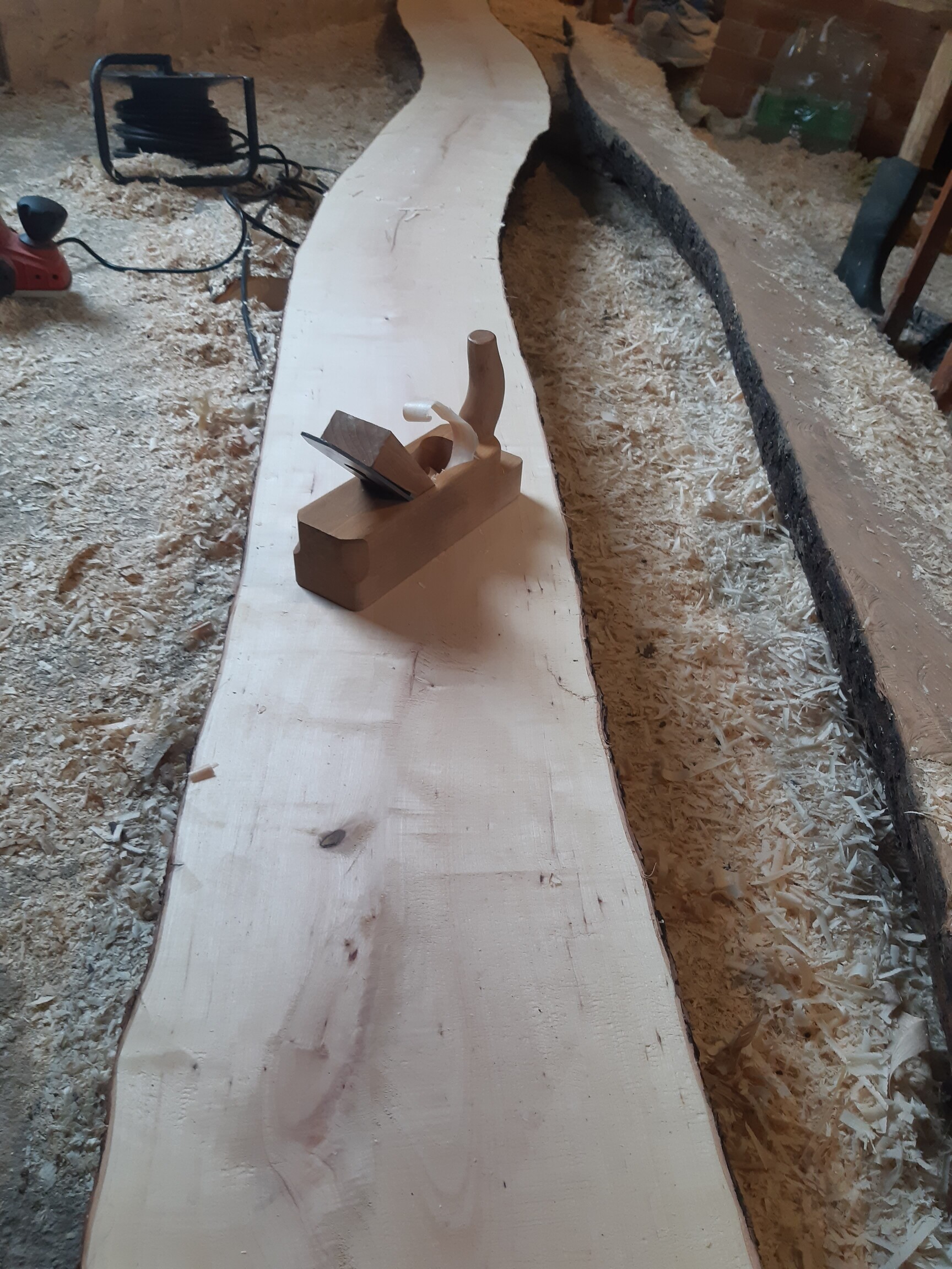

Making some stairs. Beoutifull wood but terible to work with, grain allmost as messed up as my brain :smile:
Dog loves the chips thugh!

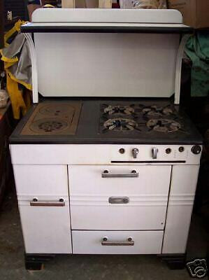

At the Family homestead we had a large brick cook stove with an iron top not much different from yours. Also it had a back boiler for heating water but also to act as a heat storage to make up for times when the fire was out. I imagine you used a lot of lessons learned in the design of your stove and heating system but just remember to make sure the wife knows too…
The original farm house burned because one of my aunts would make huge fires and then choke off the air supply and eventually this lead to a chimney fire. After that an oil stove was put in it s place and an oil furnace for heat ( sometime in the 50s or 60s I think ). The some of the original masonry was left mostly intact in the kitchen but much of it was removed to make way for modern electric appliances in later renovations.
You could even in a harsh Canadian winter heat and maintain a comfortable home with that old wood burning masonry stove, just too bad later generations could not be bothered to use it ( we had free wood a small saw mill no less!! )
Ah the oil stove…
My grandfather moved it too his hunting camp, but he converted it back to wood because he hated the smell oil. It was nearly identical to this but had a warming oven on top. That much iron could once warm keep the whole kitchen and most of the cottage warm all day.

Its been around 4 months or so since the stove ran non stop, only cleaning ash once a week and brushing the boiler flue once a month. So far l am pleased. Still needs some estetics thugh.

Good video Kristijan. Very well thought out stove contruction with lots of options.

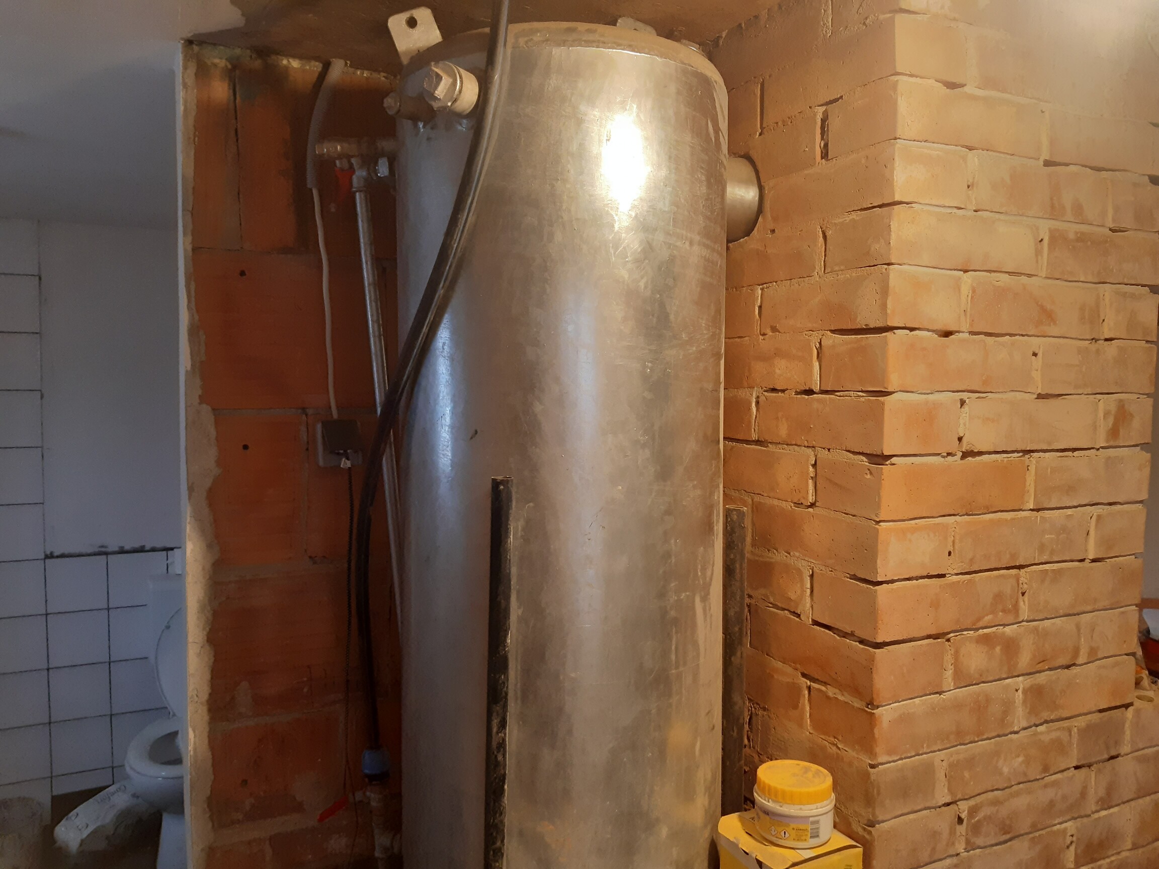

Does the boiler part heat tap water directly, or is there a heat exchanger?

The design was inspired by our old cooking stove, factory made, with added features and a brick lineing for heat acumulation.

JO, directly. There is a flue trugh the boiler and nothing else. Probably cant go much simpler and foulproof. So far l am extremely pleased! Still missing the insukation thugh…

You intend to insulate the heating pipe from the stove to the hot water, yes?
