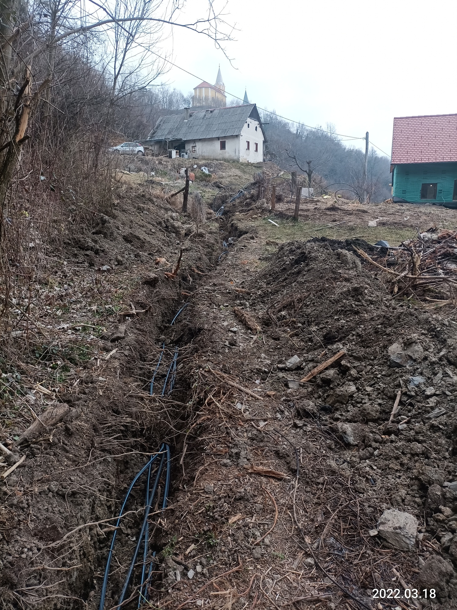

Holy crap, it has been a year till my last post here! Im a bad reporter…
So much has been going on here l dont know where to start. Perhaps l will start at the end, this is what l am currently up to.

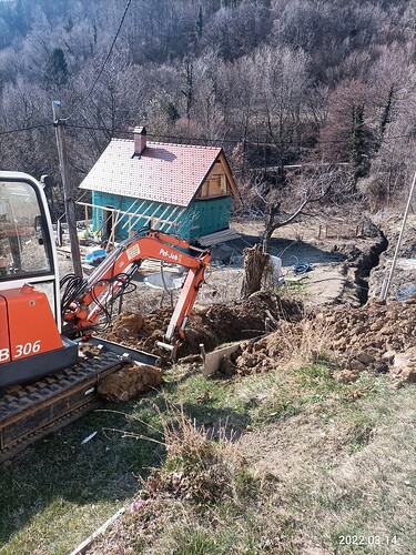

You may see in the background, our houses roof is finished and lm building a porch on the side. But its the front of the picture l wanted to mention. I made a bargain and exchanged five cords of firewood in exchange for excavator service. Money free transaction, just like l like it best.
We havent had any rain or snow for nearly 3 months now and we are experiancing intensive drought. This is bad for winter crops and fruit trees. I felt stupid watching hundreds of gallons of spring water being wasted each day from the litle stream that springs on our property, and with everything pointing towards the fact that this unusual weather is here to stay, l decided to act.

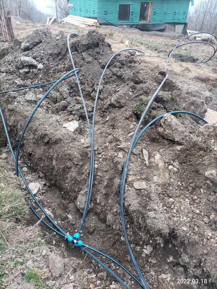

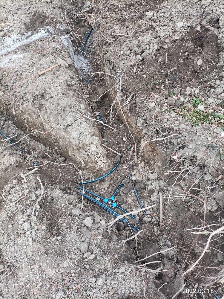

A week ago the excavator started trenching our property. About 1000 feet of threnches were dug in the rocky ground, now we are laying the nessesery infrastructure for all our water needs for the house, animals, fishponds and irrigation. When the pipes are layd, next thing is building a irrigation pond, probably about 10000gal capacity. I will report in more detail, in case anyone is interested in the project.
Chimney and roof look excellent. Is it tin or chingles?
Will all that water come from your own spring?

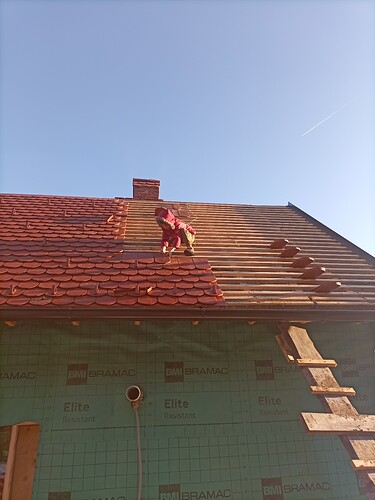

Plese dont call child social service on me
son was on a harness.
The spring currently produces about a gallon a minute and such was the case in our summer drought we had last year. While that adds up to a conciderable amount over a whole day, unfortunaly the spring is about a good meter lower thain the garden and the spot where l want a fishpond so l need a pump. It will probably be a mechanical pump type, water powered, like a ram pump or similar. Wich ofcorse uses a lot of water.
But, we also have nother “creek”, l cant find the correct english term for it. It only flows when it rains strongly and it only flows for a couple of days. But when it does, it realy flows. This creek will fill directly in the big irrigation pond.

Kristijan is it normal, and needed, to put snow holder devices on roofs there? You are snow melt capturing?
Here, Washington State we are allowed to only retain 10,000 gallons of water without going thru special permitting.
Steve, yes. Not by any law or whatnot, but everyone puts snow holders on. First, snow falling on your head isnt fun. Second, its not good for the gutters if half frozen snow rushes in to it. Thirdly, its safer for the roof. Its not uncommon for roofs, specialy ou traditional hay holding structures like this ones
r
to tip over or severely tilt when all the snow from one roof side rush down while the other has a hevy matt of snow on it.
Here, l belive you arent alowd to have one gallon of irrigation water without a permit, officialy. But l wont tell if you dont…
Great new picture. Fired clay tiles, yes. I see the screws? holes. The special screw hung down snow catchers.
And before any would child endangerment panic. Your son’s tied off safety rope. You are building memories and work ethic there.
I can only know what you show me. Back filled, grown over I see nothing un-permitted.

No screws, the snow catches hook on the wood and are held down with the next line of tiles. The hook comes around the wood. I guess they could also be called hookers
Yes, fired clay. 50 year warranty. One of the most expensive roofs but I wanted something natural as l will be collecting rain water also. Sheet metal wuld be an option but wuld not look good with the naturalistic wood sided style of building, wich l intend to do.
