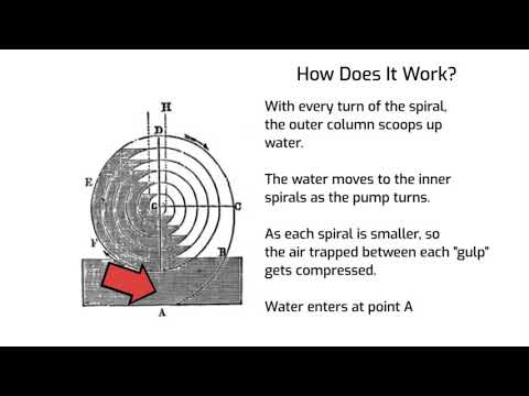

Each revolution compresses the air/water just a little bit more, It only picks up on the outside ‘large’ coil once a revolution. The water falls by gravity to the bottom of the second pipe which increases pressure because it is a smaller area, so repeat that 40 times since that one is like a 6ft wheel. In a way it is combination of a screw press and a achimedes screw pump.
Here is a video that tries to explain it
Because half the pump is filled with air, you aren’t lifting water over the top against gravity so it is supposed to be less work/energy input and easier to turn. I don’t know what the limit for lift is but it is dependent on the number of turns, up to some maximum. The first link might actually have the formula. I found one once about 10 years ago. I would put a screen on the front scoop of it. Getting something stuck in that tube would be a pain to remove.

Now, only 2 more questions l need to straight out. Is the rotation speed of the wheel important? Or does the wheel just need to turn at what ever speed. Because at a gal per minute of flow l have in drought conditions it will turn super slow.
Second, it seems its important that there is air in there too. This air will slowly dissapear out, get disolved in the water. I guess it culd be possible to mount on a sistem to introduce a few air bubbles with the scooped water, like some ram pumps do. But still, even better if it can be simplest
Ok, l gotmy questions answered in the link above. This is gold. By the looks of it, this is exactly what l need.

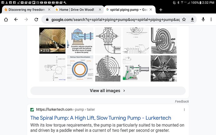

A spiral pump that can lift water high with a slow turning action.

The pump shown above does not have to be made in a spiral. It works equally as well in my experience if it is simply wrapped around an air-tight drum and floated in a creek as an underflow water wheel. (make sure it can float up higher when the water rises)
I have a good bit of experience with both types, and I never saw much difference between the two. The spiral is just harder to build.
In a pinch, you can use air tool quick connect fittings to attach the hoses…but be warned the rubber piece in them that makes the seal will wear out within several weeks of continuous use.
This connector was always the difficult piece for us in developing countries…it has to be air tight in order to make the air-over-hydraulic function. …and, one side has to spin while the other is stationary.
All that said, it is one of my very favorite pump models if you have a steady flow of water somewhere, or if you have a way to cheaply spin the pump.
As I recall, the highest (vertically) I ever pumped with one of these was 31meters. It is a bit slow at that hieght. If you can get it (water) up to a plateau and run it flat for a couple hundred feet before dropping it off the other side of a hill, it will pump much more water as it will create a siphon, but it has to have enough volume in the flat pipe section to not empty the siphon before the next “gulp” of water cycles around. That part is just a trial and error/ pipe size/distance experiment. I suppose this function makes it something of a double action pump system.
