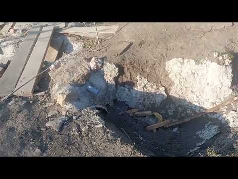

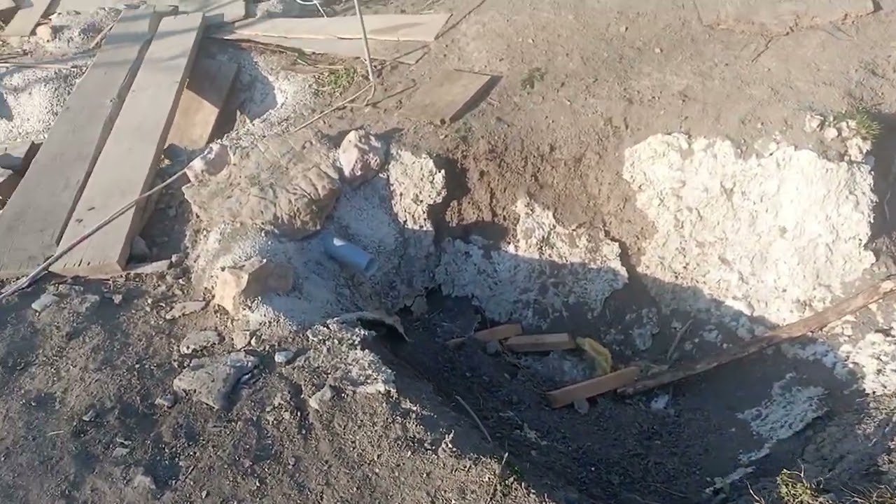

Here you go, the video explaining the layout

I just noticed the video didnt upload well. It isnt synchronised well with sound. You guys had the same problem watching it?
I noticed nothing wrong with it
No issues with the video at all. People used to think I was crazy for spending so much time with a shovel. You have me beat. You should think about Aircrete for your retaining walls. No savings in the cost of cement but if you don’t have a good source of sand and gravel then it cheaper and requires very little form work. I see a lot of father and son time in your future. Maybe the biggest benefit for all that work.

Tom, l hand dug maybe a hundred feet or so, the rest was done with a excavator. Doing this all by hand is a suicide. The machine threw out boulders in the 400 pound range…
Unfortunaly, the neighbour now needs the excavator so backfilling will need to be done manualy.
When l made the video l forgot about the English term of what l want to do. Its not a retaining wall, but a dam! I may install some concrete reinforcers inside, but for the most part it will probably be just dirt and maybee some black alder logs (black alder petrifyes in the ground)
I am however ruminating on what to use as a liner… The pond foil is expensive. Any thods?
