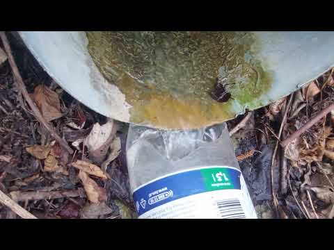

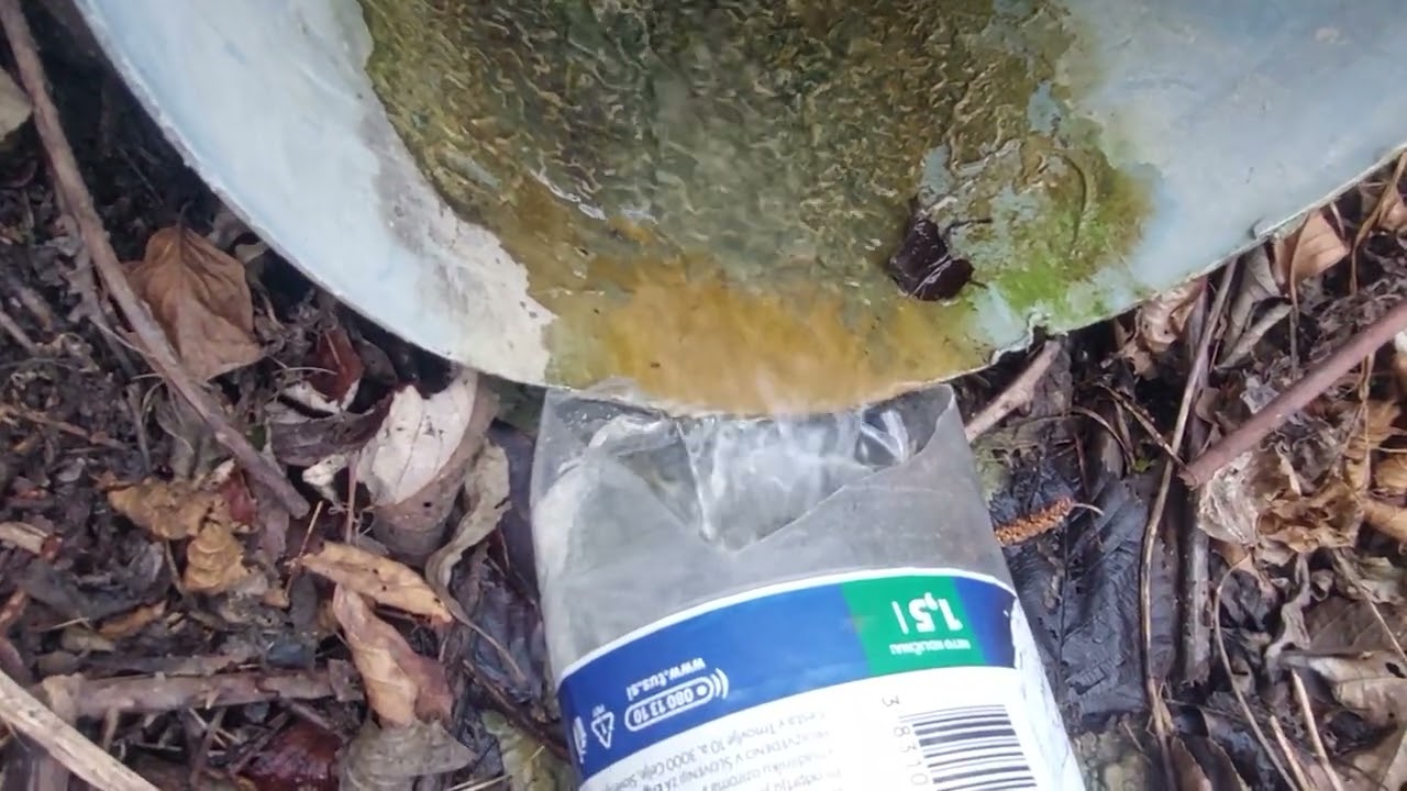

Kristijan, would you estimate the water flow of your stream. Did you ever try a measurment?
Kamil, this is about the average output. In extreme drought its down to about similar to the flow of an averidge midle aged man ![]()
As you see, its extremely simple. Water and air enter in this sofisticated manifold, then get compressed, separated and air comes back in the underground compressed air grid wich l dug in the property 2 years back.
So, very rough estimate, a deciliter per second or 100 gallons per hour? At 30 feet elevation it represents 0,5 kWh of potential energy. Did you think about creating any sort of pond to create a reserve for bigger power output?
