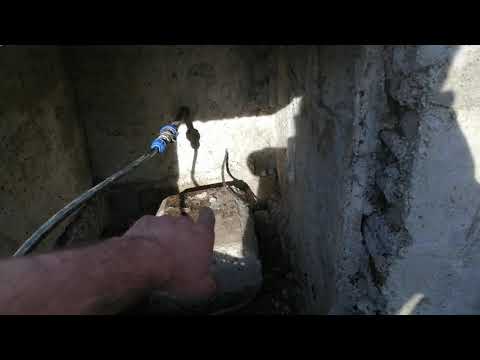

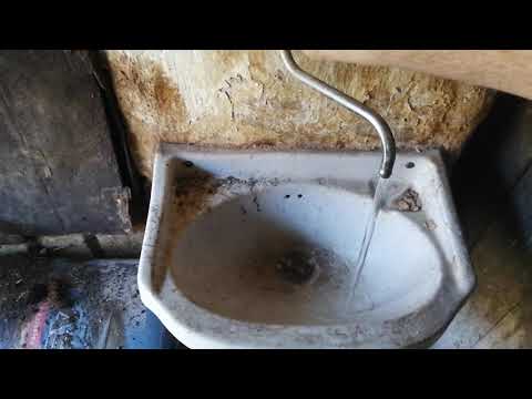

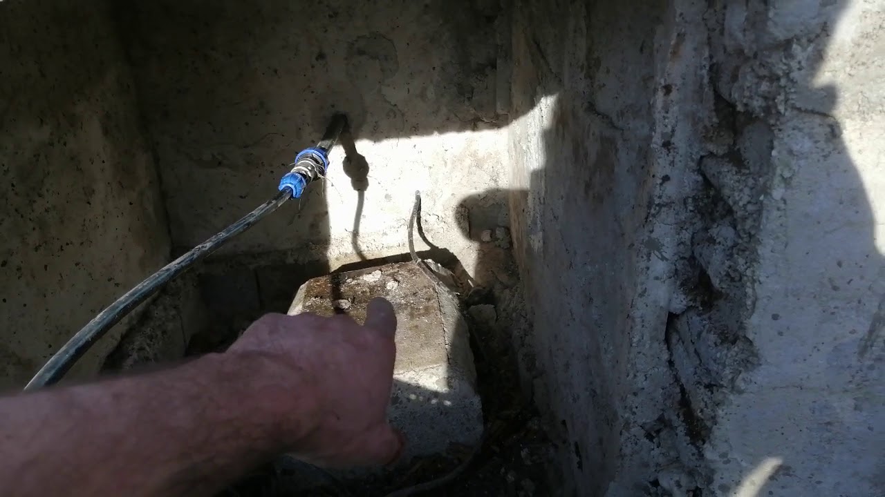

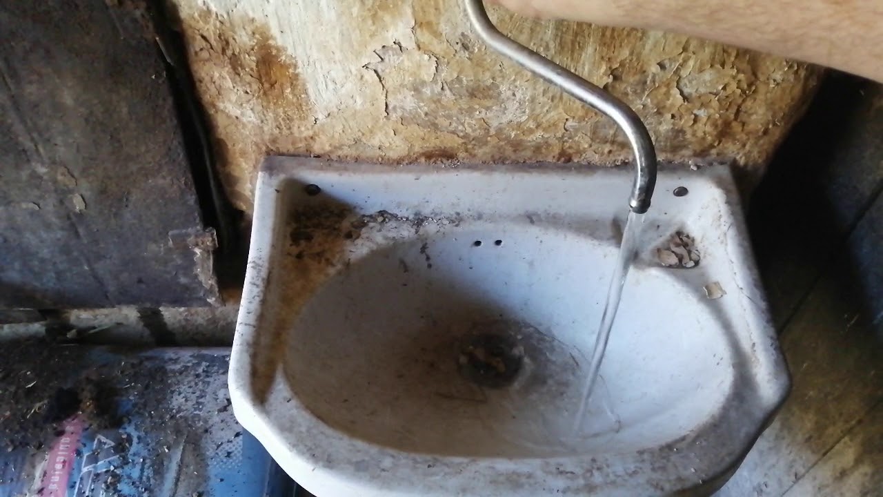

Congratulations on your water supply. Impressive work.

How deep does the frost go where you are?
You’re plans always seem to work! Congratulations!
Congrats! Water tap works. A beer tap next, right?
You probably already planned to, but buried sheets of styrofoam when refilling the trenches should take care of the frost.
Lets not talk to soon! It will all work if the spring works good. Rampump needs a lot of water. Summer droughts might pose a problem, it that case a small electric pump will help pump one or two reseroirs a day in the top reseroir.
The deepest l have ever seen frost go is 2-3 feet. My main trench is 6 feet deep. The drive pipe trench is shalower at 2-3 feet and will require some sort of insulatiom just in case.
Oh, beer tap. I realy do need to go back to brewing… I have helpers now and here, if helpers get water they will only come to help you once…
The rule of thumb here for insulation is 30 cm on each side of pipe and 25mm thick for each ft of frost dept you want to replace…

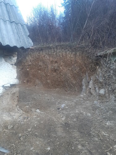

Hadnt had time for a detailed description yesterday.

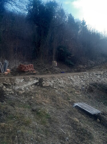

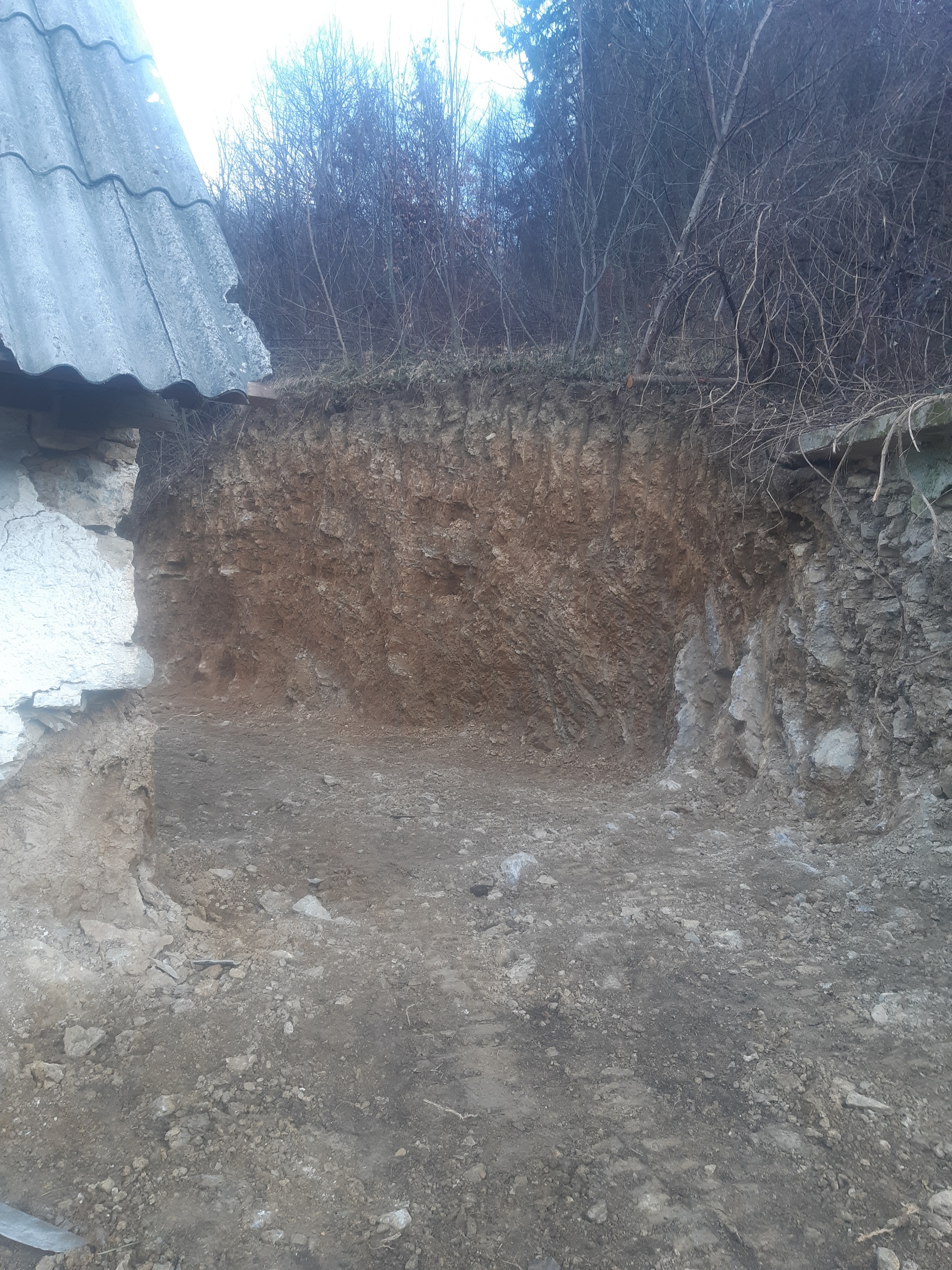

We have been excavating and leveling the driveway for the last 3 weeks. A excavator, bulldoser and about 15 pounds of special spice was neaded to get the job done, tou can see the coridor behind the house was all rock before. Dolomite/limestone.

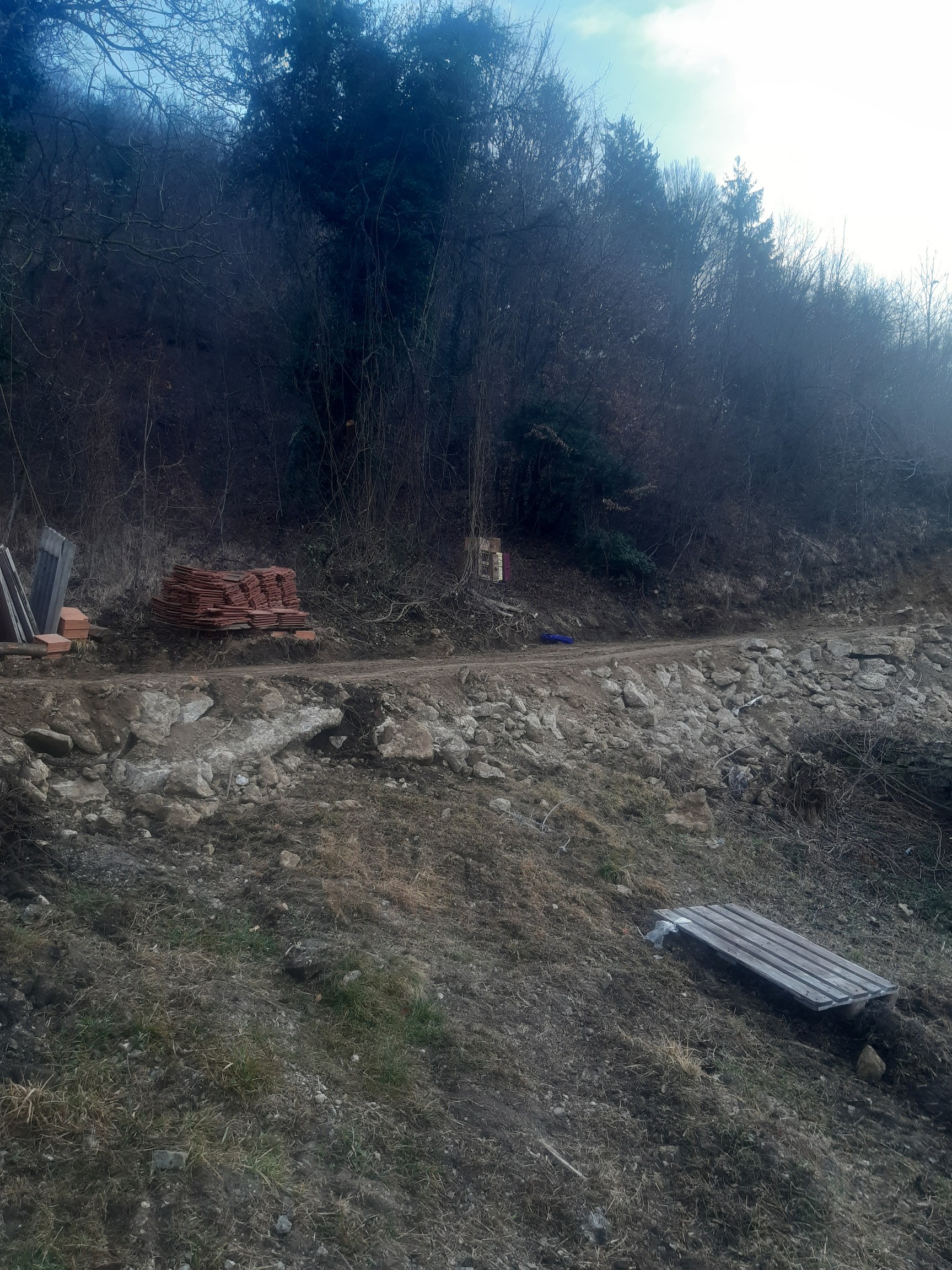

Second is our future garden. Just spreaded manure with a thick coat of leaves and hay. First crop is viaible, the winter garluc poking out trugh the hay.

Last pic is the feald l burned allmost every evening for the last month or so. 20 years old grass, dry and thick, l took no chances and progressed slowly. I still have about a third.
