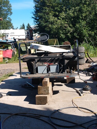

The cart is getting all new brake cables and brake shoes. We have to straighten the front axle in a press… somebody hit something a lil too hard and bent things.

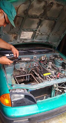

We went and looked at an electric Geo Metro conversion today. This motor in it, is worth more than he is asking for the car.
Really, I don’t see any difference in how this car is set up, than the golf cart. Even has a Curtis controller.

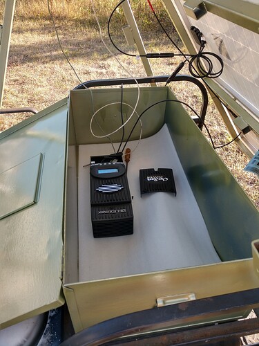

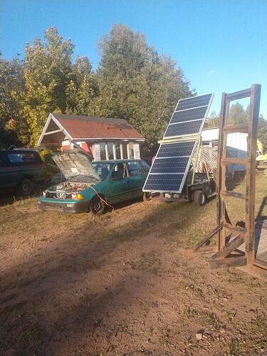

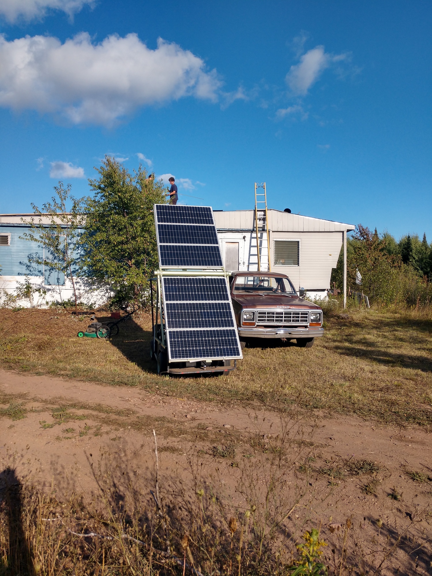

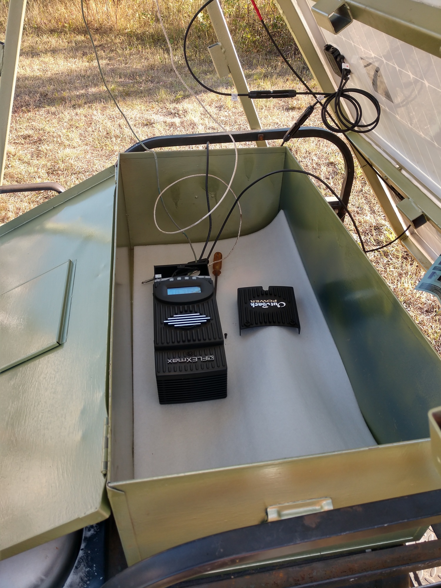

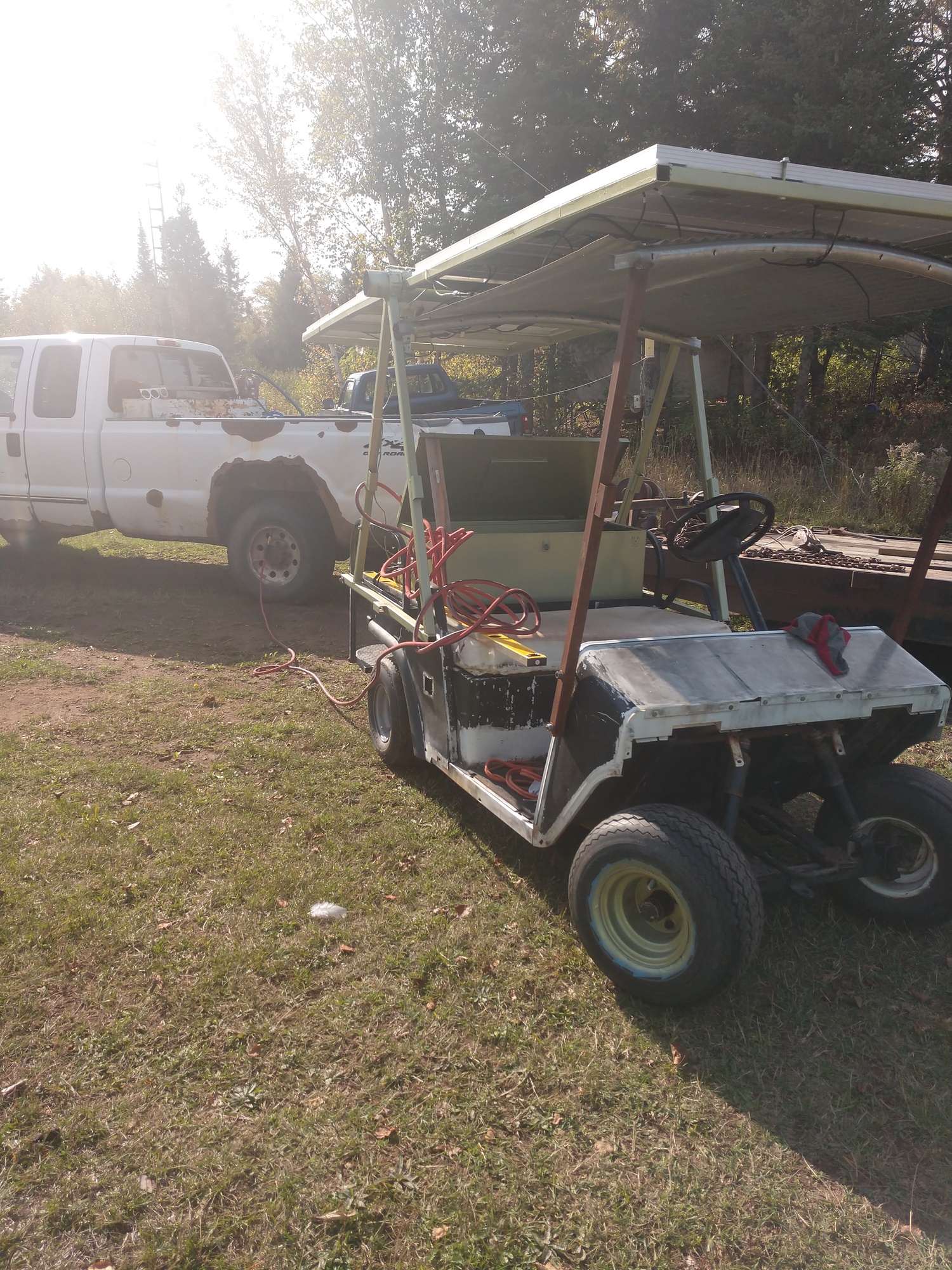

Just an update on this…it needs paint, and the inverter and charge controller wired in properly. We pressed it into service because we were redoing the camp roof and I got tired of walking back and forth.

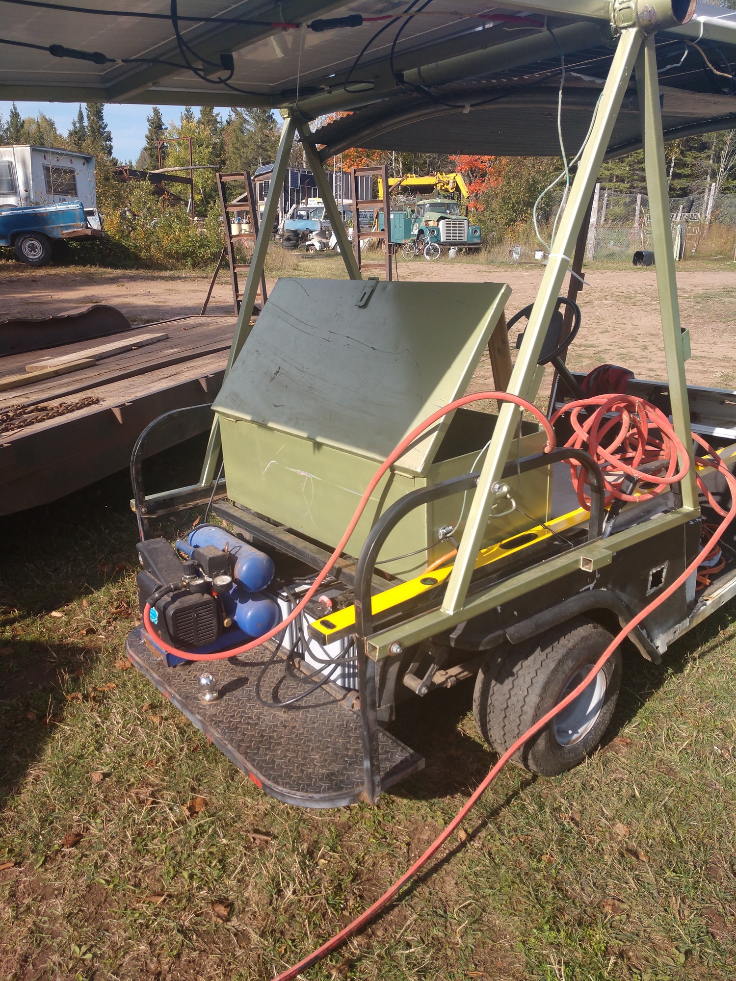

Charging the electric car with the golf cart.
Inflating tires with the cart.
There have been mishaps. I hit the throttle instead of the brake and flipped the cart a bit, dumping all the electronics overboard…then panicked and floored it. I wish I had a video of that…

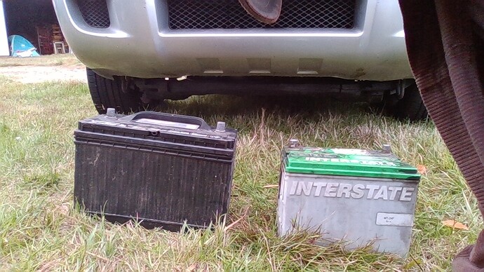

As I told you Bruce J. I decided to go with top post Group 31’s in all the rigs here.
Ha! Then if-ever; then-fuels-restricted I can pull them and bank up.
Ha! With the in-use rigs keeping them conditioned.

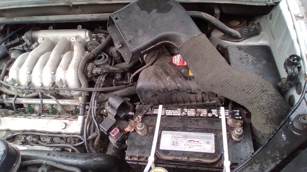

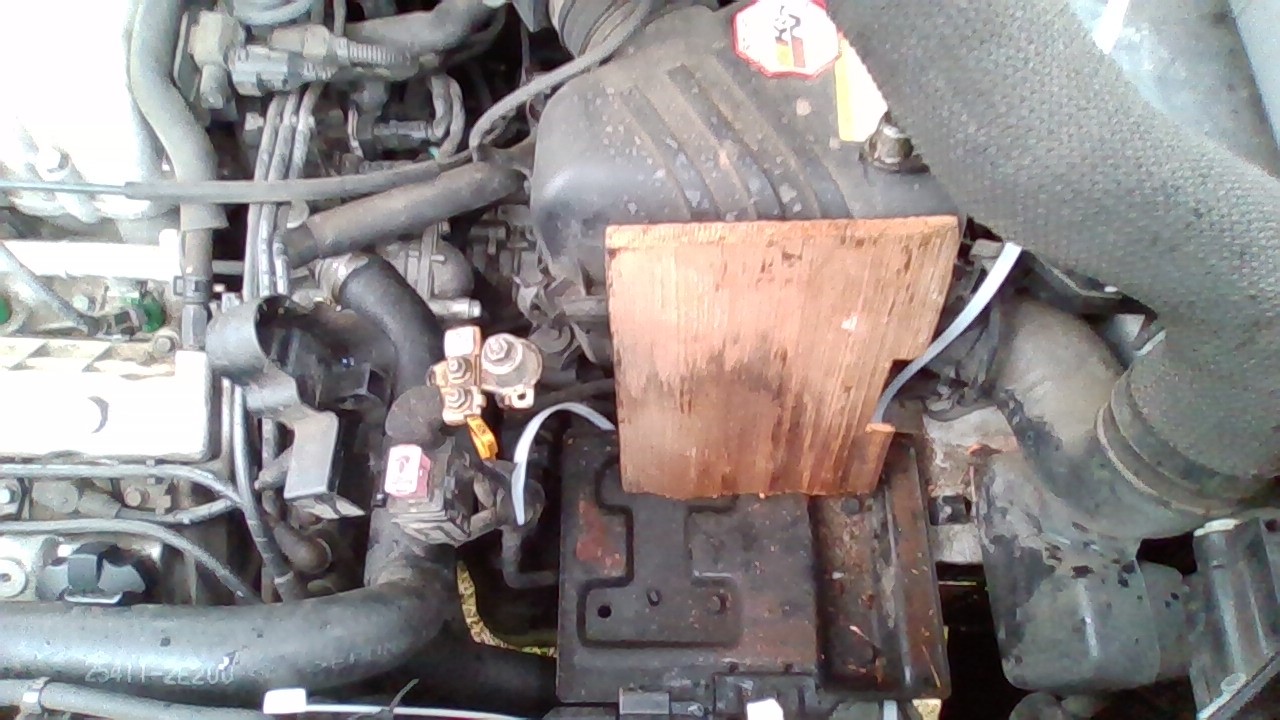

Another one just converted over this morning:
Ha! Ha! Had to make of course a wooden floor plate to not have the original tray edge cut into the bigger heavier battery bottom. Hey Marcus Norman89 I used a western red cedar shingle. Keep you working.
Finished. Had to relocate the wiring harness’s both sides. And flatten two harness support tabs. Had to lose the P-post cover. Too tall holding up the fresh air snorkel.
Two more vehicles to convert and then I’ll have five same-same working. (Too chicken to do the wife’s SUV)

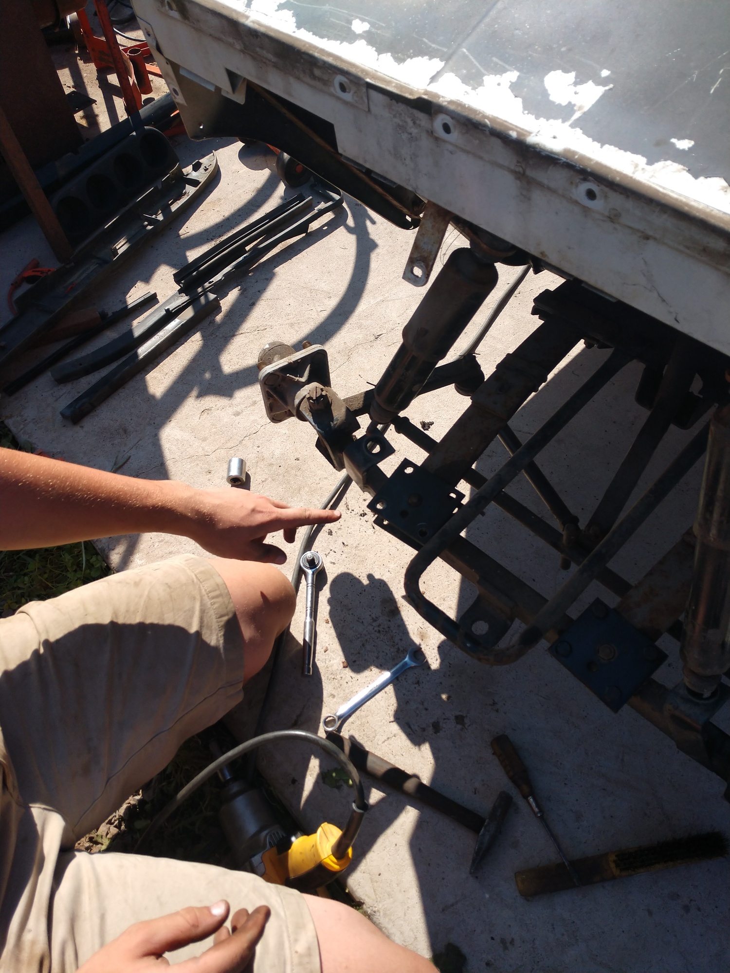

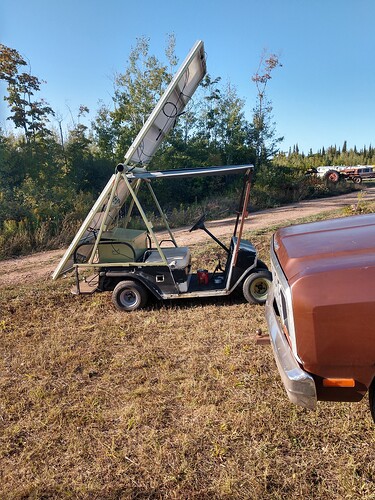

I went out back a half mile, over a rock pile, logs, and etc. I was heading for some sugar maples I pushed over, making a pathway along the property line. I hit a bump. I broke a weld. I had the framework holding the solar panels come loose. I was stubborn, and cut wood, until the inverter whined about the stupid bldc saw drawing too much watts.
I still managed to drive back to the shop. If you look at the last photo of the cart, you’ll notice no bolts on the bottom green bar of the framework. Apparently, I spaced off and forgot to put them in. The other side has them. Anyhow, Charlie put them in, and I rewelded the roof.
We also keep an extra tarp over the electrical box.
