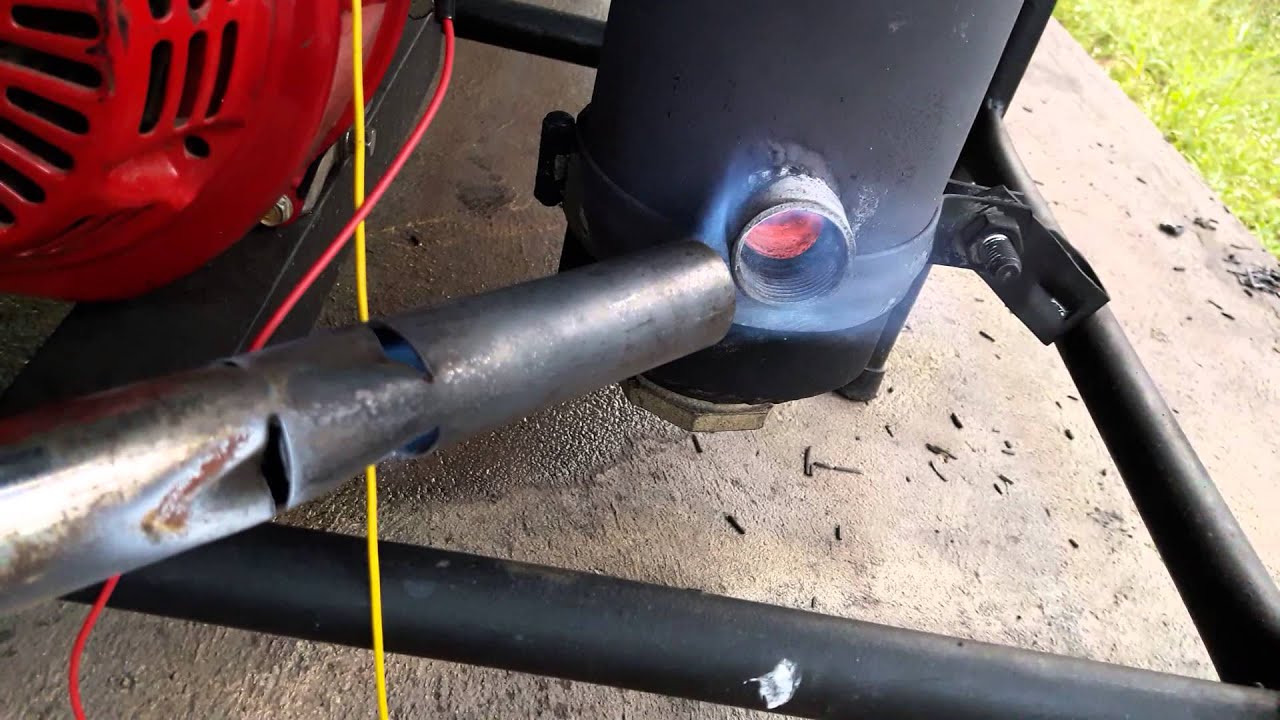

testing some new idea’s…
Blowing the heat from the flame in the ignition port to see what effect it has on the glow…
For small engines , as i use, the turn down ratio is important to avoid a huge lag after decelarating
I am thinking about an loop system, combined with ignited gas , to keep 6the flow and temperature in the core at a constant level.
This also can replace the HHO i was using in the first setup.
Only at cold startup may need the HHO for starting…

Hi Thierry,
No, its only gas from the gasifier itself, its an experiment to see what ever happens.
I want to try a “loop” with an continious flow in the gasifier, so an burning chamber in front of the ignition port.
Where as the gas gets burned and re-injected the heat into the gasifier if the engine throttles down…
A kind of improving the turndownratio or enhancing the low rpm gas quality…

Hi Thierry,
The gas would be in an open loop if the engine is not or little demanding
I intend to install a vacuum switch on the blower so the gas will be circulating at a constant speed, even if the engine is taking only little.
The excess gas wil be fed back into the reaction zone after been ignited if needed. ( PID controller on ignition)
This experiment could learn me more about maintaining a constant gas quality for the changing loads on a small engine.
