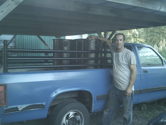

Featured Project of the month for August 2015 is Johnny Caudill’s 1994 Dodge Dakota. Proof that you don’t need much money to build a gasifier - just barrels of determination!
"I am one happy camper right now ..I just done a 60 mile trip ,30 miles there 30 miles back , 100% wood and was cruising 60-65 mph all the way ..
Its almost like magic happened , I am guessing my char bed is where it needs to be now .The thing is running absolutely wonderful I consumed around 50 -55 lbs of wood …Its no longer eating it like crazy and I am ready 2-4 on the hopper and 10 -15 on the rails ..Tonight’s run cost me a Big Fat ZERO :slight_smile: "
