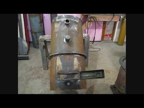

Here’s a vid of my FEMA. Yeah it’s fancy, so to speak, but at that time I thought the Fema was the real answer to wood gasification, it’s not. It’s a neat experiment, but don’t spend too much time there. Notice that some water still present in the nozzle even though I have a burnable gas. I moved on to an imbert design inspired by the GEK design.
Pepe
